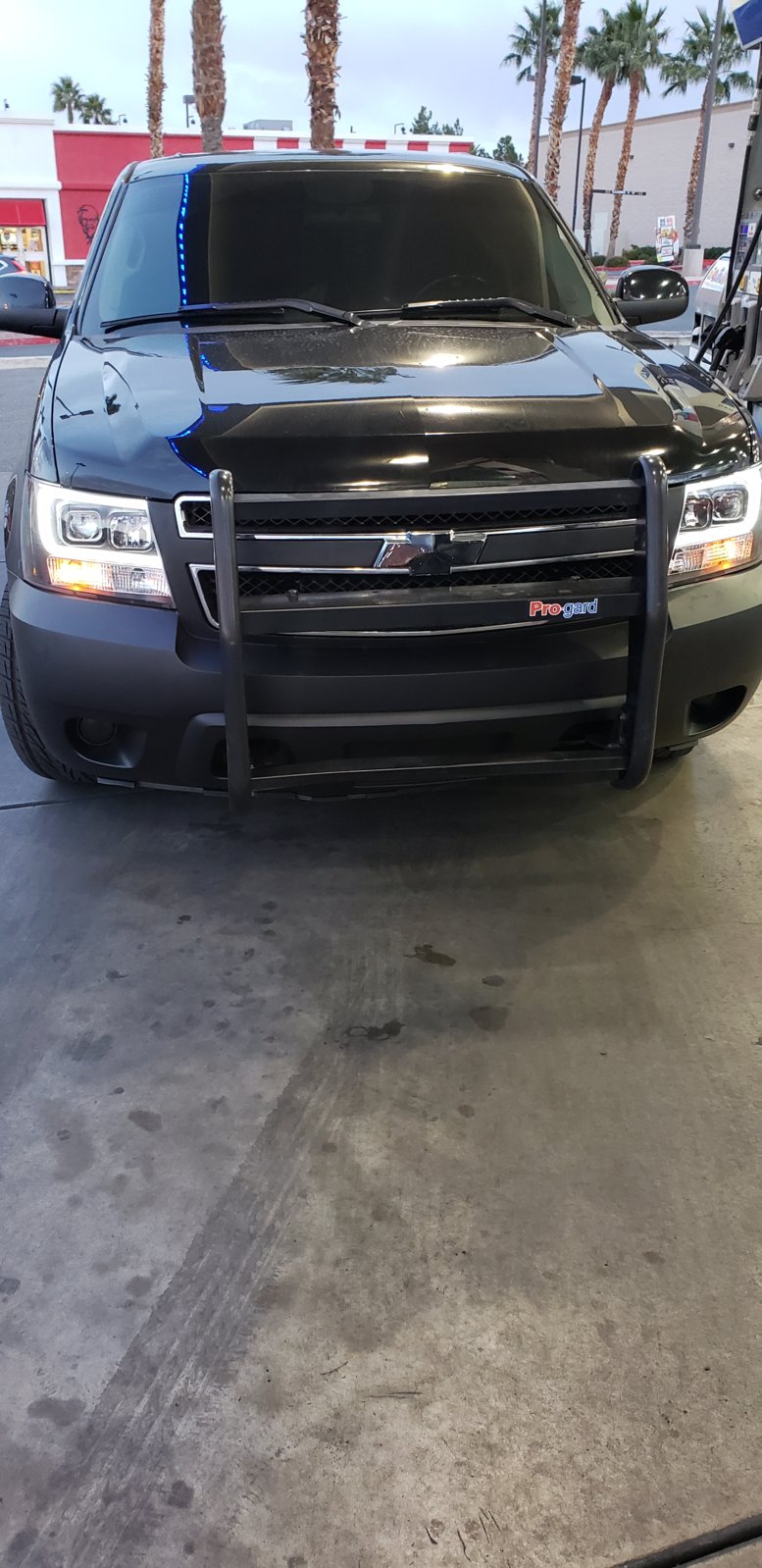

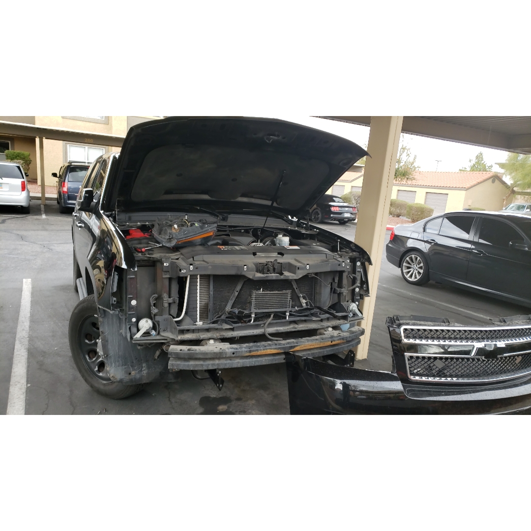

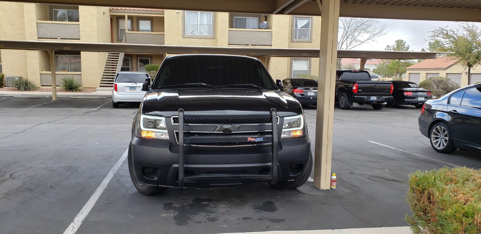

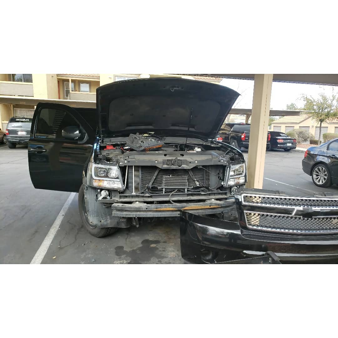

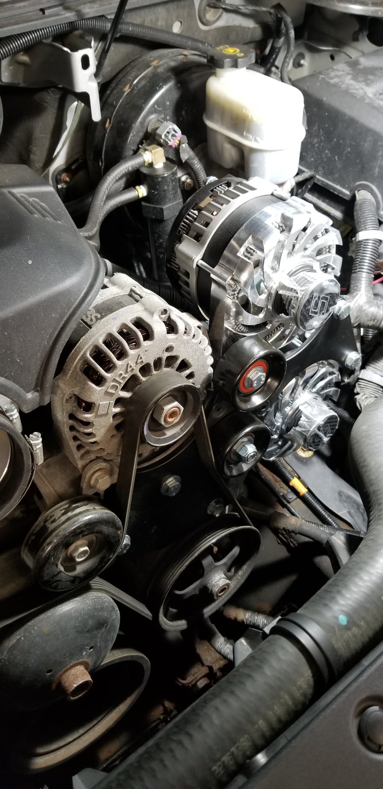

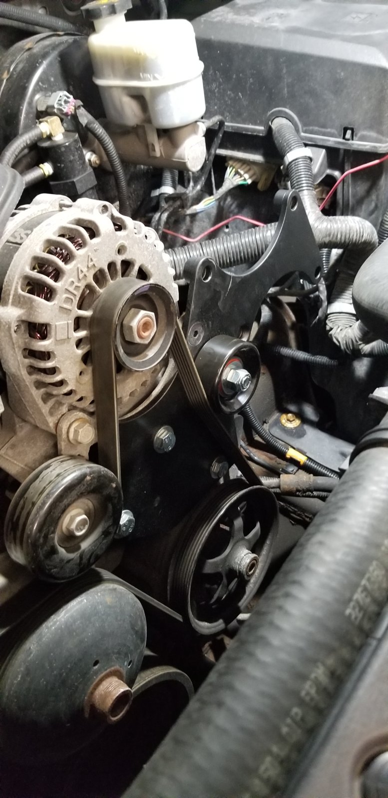

Those that know will know what this is lol

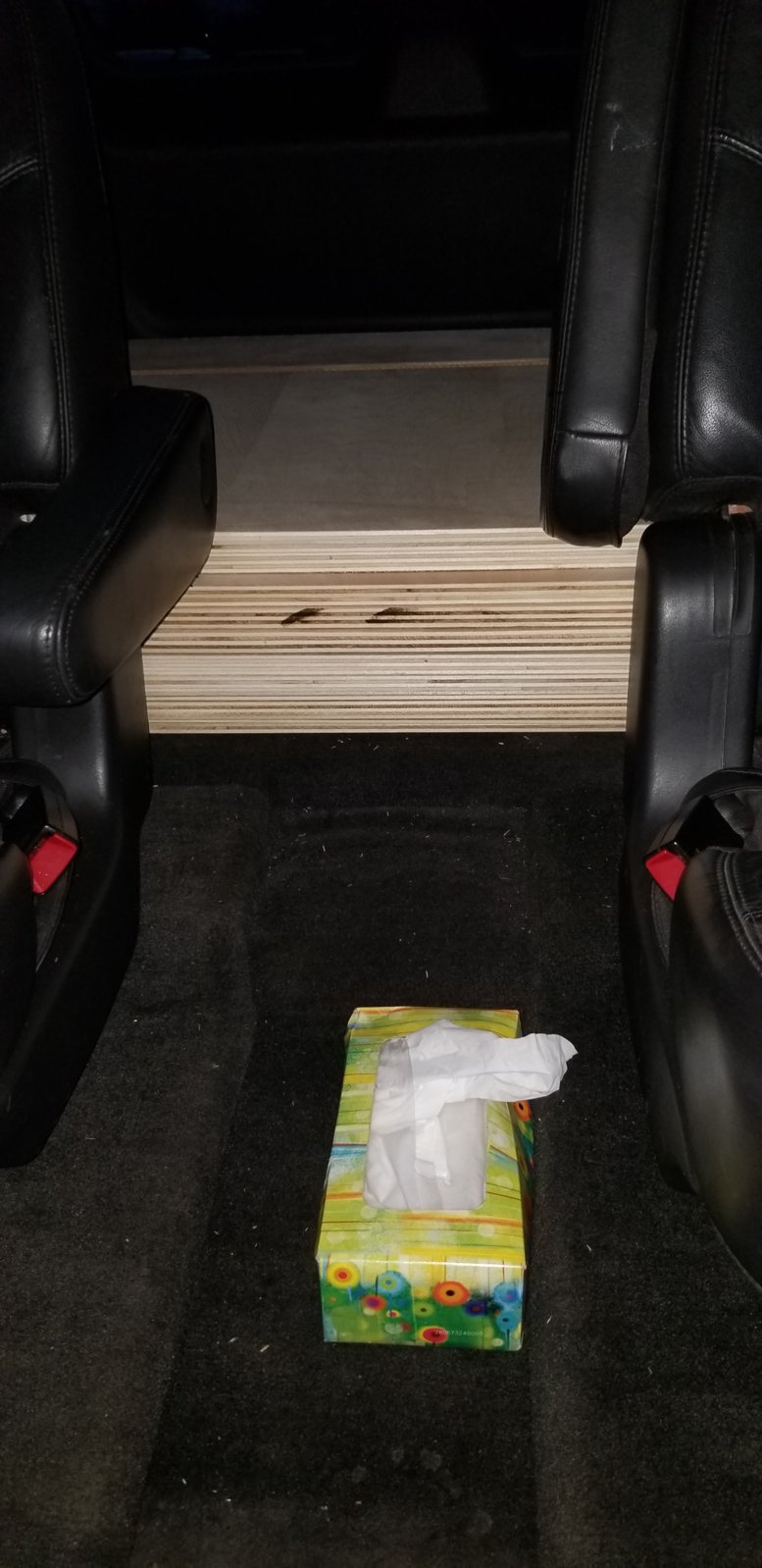

Also picked up a couple sheets of wood

Leo looks like u could have a dual alternator bracket. Not that I’m saying it definitely is but looks like it. Unless a previous owner had to relocate a pulley for something like a supercharger.
