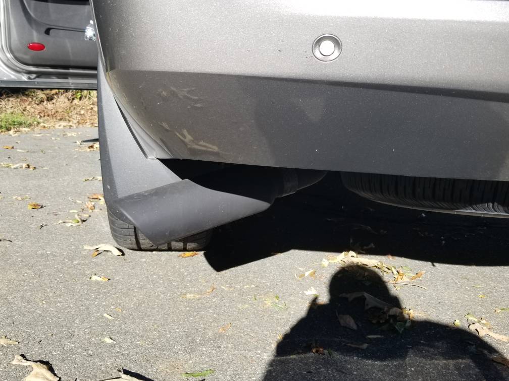

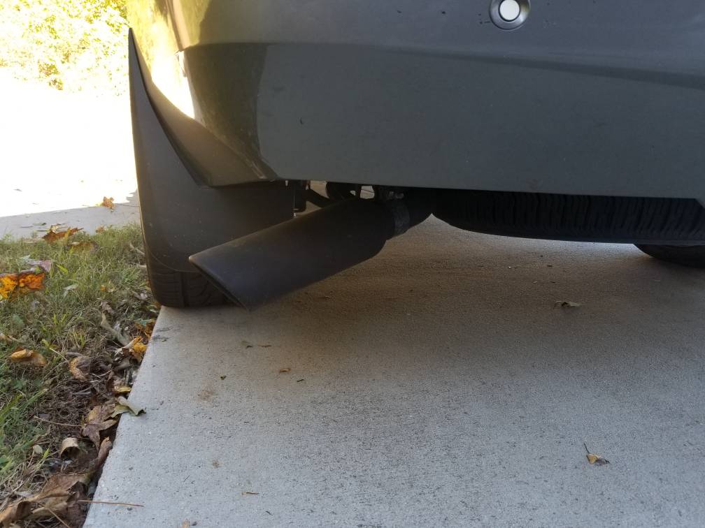

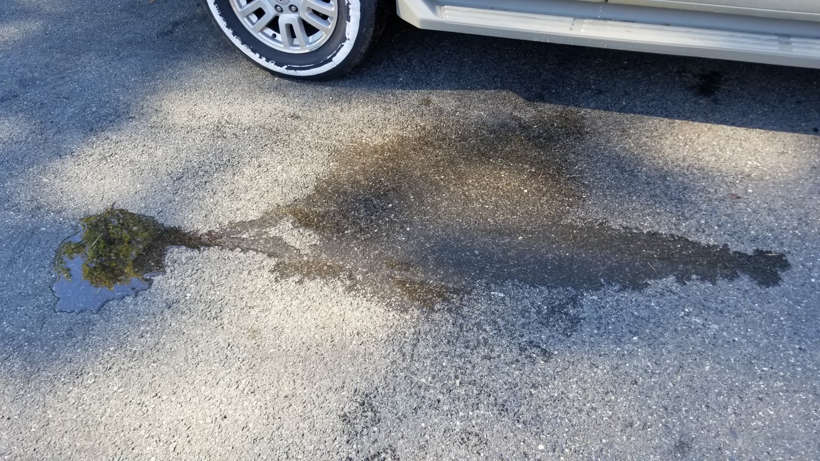

Replaced the oil cooler bypass gasket.ets see if that oil leak comes back.
Also somewhat fixed my ds exhaust hanging issue, just to find that where the hanger ripped off, that it left a gapping hole.

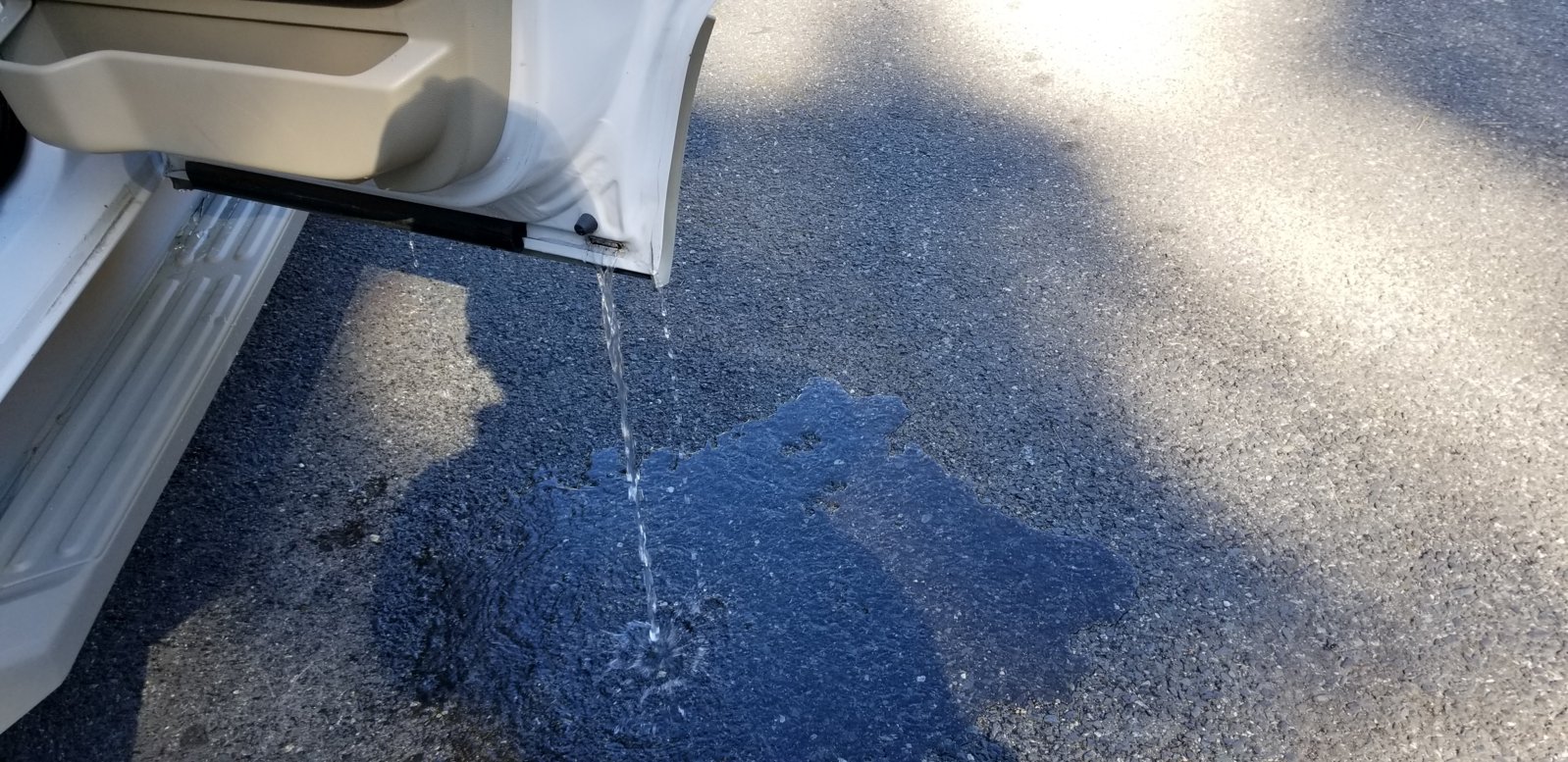

I went after the door drain plugs today. They were all still present, and mostly falling apart. I picked them out, blew the cavity out with air and this week is to be dry so I'll go after them with fluid film to prevent further rust.

What's fluid film?

Like Darius said it's a corrosion inhibitor. It's an oil based rust proofing product. It's widely used for undercoating, but it's not a solid rubber type product that will lock moisture in, and accelerate rust. You have to re-treat it each year.

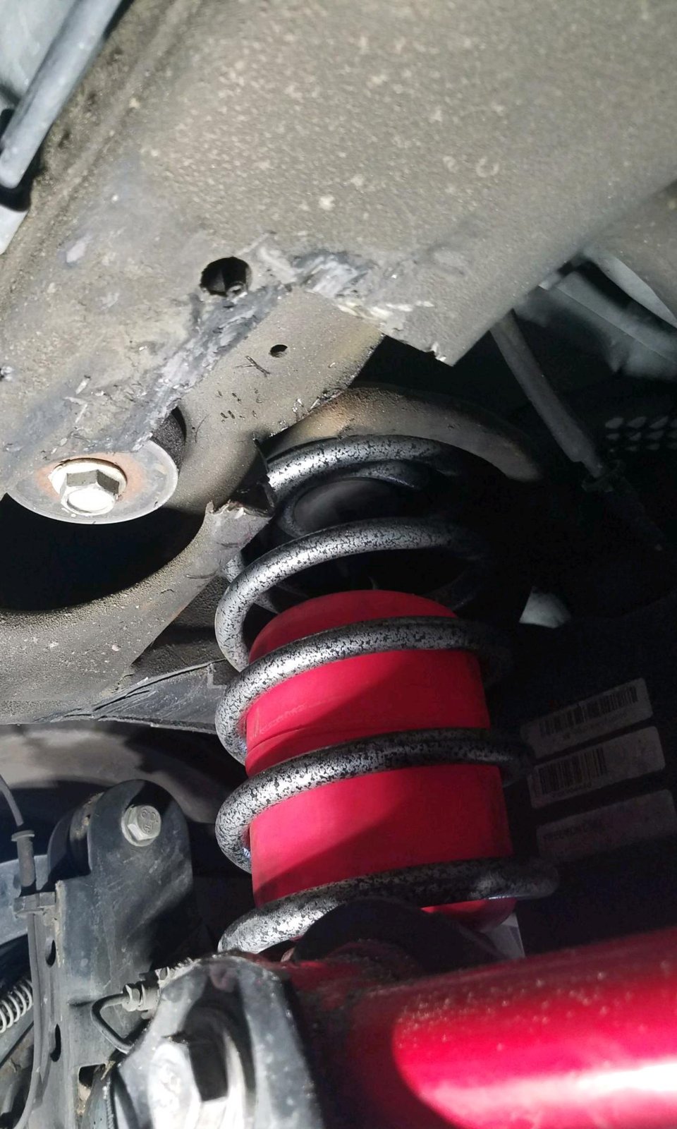

That orange bag inside your spring, did you add that? or is it factory? I have the non air ride. Is that something I can add?

Thanks, @Regency @93blkongreenpro and @kbuskill ! Looks like you guys have just resolved a long standing bottoming out issue for me! I LOVE this forum! You guys are the best.
Just talked to a guy at suspention connection.com, who wasn't confident that they would fit on a lowered vehicle. Did you guys have to buy a different set, or do any mods on your lowered Tahoes / Yukons?

Duh, @kbuskill , I just re-read your post... I guess I would need to do the same with my 3" rear drop...
