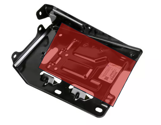

Battery died (had a group 48 in there) and wouldn't reliably hold a charge. I searched around and found that 94R "should" be the OEM size so I replaced the dead 48 with a 94R from Napa. While I was able to get it in there by moving the coolant overflow tank, it is TIGHT. It also doesn't sit perfectly flush as it sits on the "lip" of the front of the tray. I added a piece of rubber so that its not plastic on metal, but I'm not thrilled with the fit, I'd go group 48 if I did this again. Its also pretty tight against the coolant tank now (I put a rubber strip between them so there is some padding as well).
