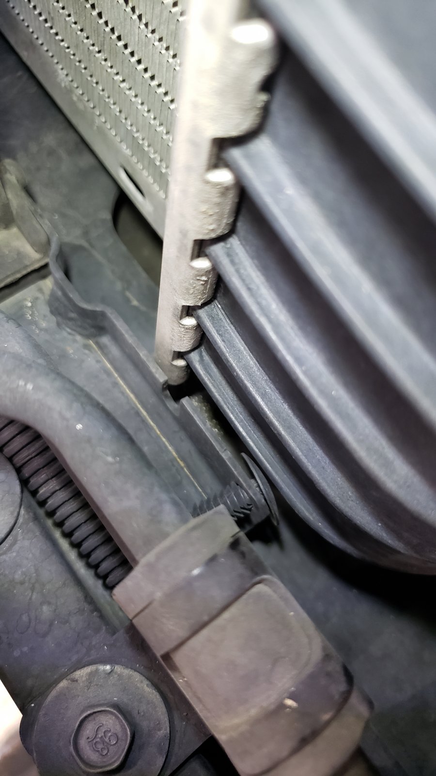

seems like the yukon has a wider gap than the chevys, i will grab some signage this afternoon i am sure no one will mind lol

Can you or one of the other artisans take some photos? I also need to make some, and there's enough political yard signs to rip out I could make 1000000 baffles and target holders.
I bought these in April and installed them early May. They were on sale or something and around $30 each. Some of the push fasteners go into tabs in the front of the radiator and I had to loosen the radiator and tip it back some to get enough clearance between it and the tab to press the push fastener in.

I don’t understand, your guys’s trucks didn’t come with those baffles or they ripped or wut? Mine are still there and are fine… ‘13 Tahoe
44,974
Yup him and me and @Sparksalot made them. I just cut them to fit not a big deal. I used this stuff and it comes in handy for other projects as well.
It's almost election time in my parts. There's plenty of that material everywhere for free.
2014 here. They were half torn out & rotted/degraded. Which is weird for being synthetic material, but they were toast. Road salt and the magnesium chloride (aka "brine") they pretreat the roads with is straight cancer for New England cars might rot them.
