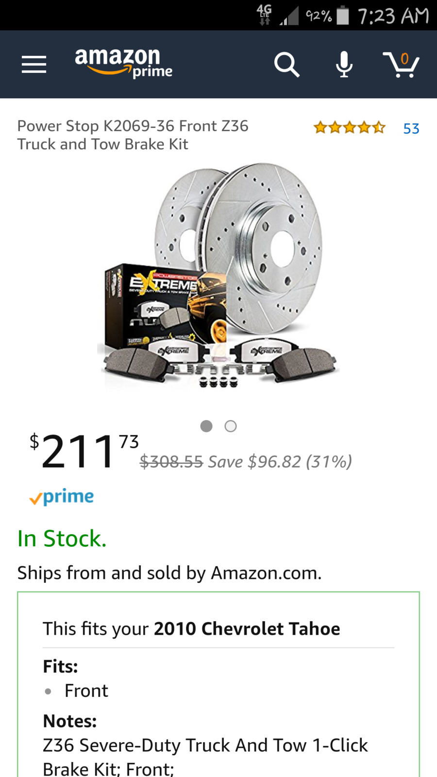

These are the ones i have saved in my cart. Ill check out the r1 before i buy though..
I'm sure that those are probably great. My set of R1 Concepts pads & slotted rotors for front axle was $137. Not trying to say that cheaper is better, or vice versa. Just giving a pricing comparison to help with decision-making, if price is a major factor.
Thanks.
Yea price is a factor, the 200 is the most id want to spend, even though i really want a bbkit haha but $1500+ yeaaa no.
I just need something thats gonna stop some heavy rotating mass of wheels ill have on soon. The 305 55 20 bfg weigh a good 60lbs and idk what my 20s weigh but im sure its not far off from the tire weight.
The brakes i have now have a fade feel to them and the more they wear it seems to get worse..
