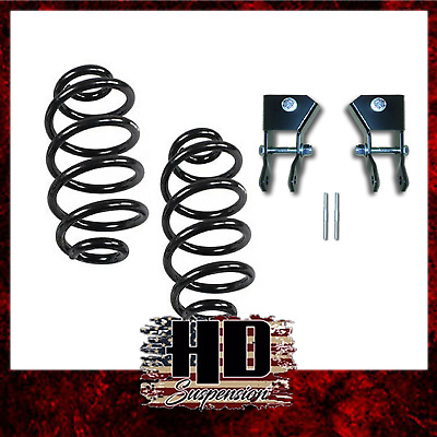

I just ordered a 2" rear drop kit so the springs are getting swapped out anyway.
