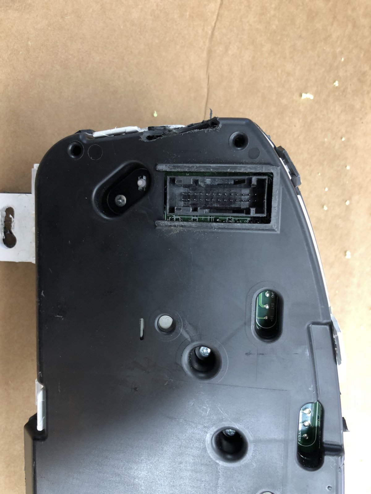

I figured out why my Silverado wouldn’t start after I replaced the cracked dash. Turns out the harness I made for the Escalade cluster could be plugged in backwards. I don’t remember that being possible but whatever. That must have confused the BCM. Now the cluster is dead. FML.
probably burnt a fuse (in the cluster) putting it in backwards, just figure which pin is positive and see if you can trace it. Does it start now with the cluster out? it should unless gm changed something from nbs to nnbs.
