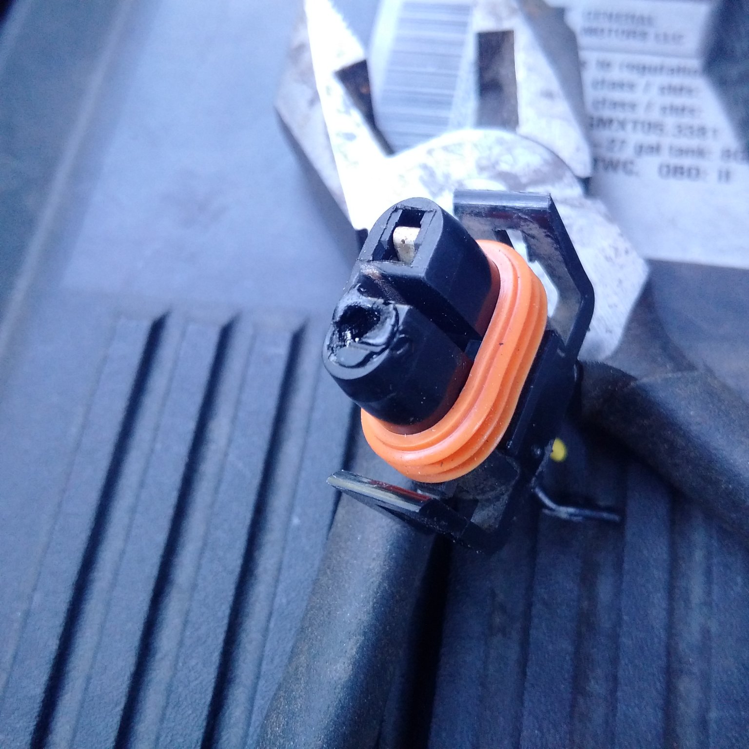

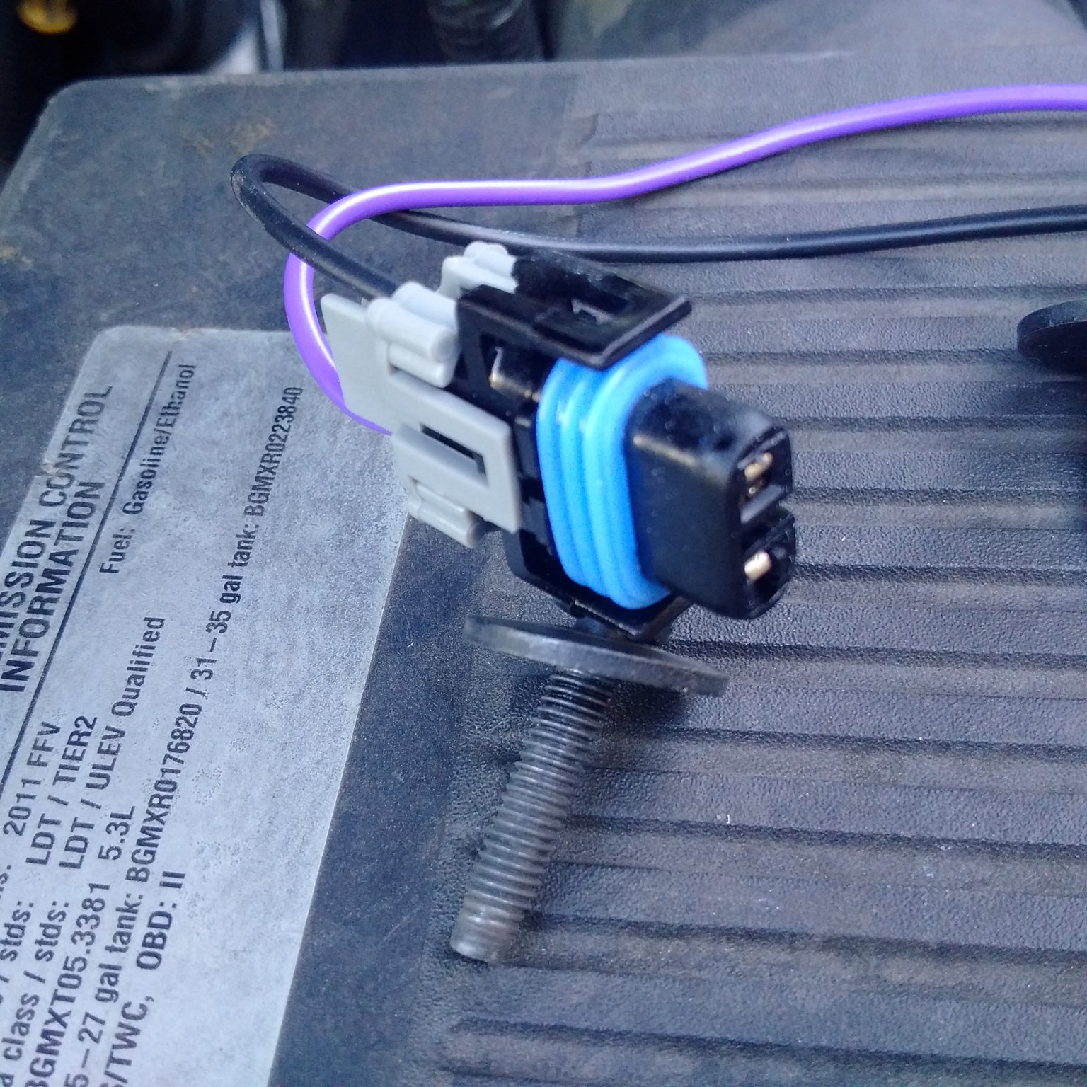

A few weeks ago I replaced both headlight bulbs. Then I noticed that one went out. Turns out that the connector to the bulb itself shorted out and partially melted. So I ordered one on Amazon Prime because of the free two day shipping and by golly it shows up. Only $18 bucks for the new AC Delco part. Only problem was that the top headlight mounting tab broke off during the process. I just Gorilla taped it back I'm place. Eventually I'll replace t headlight but it seems to be rock solid. Lol.

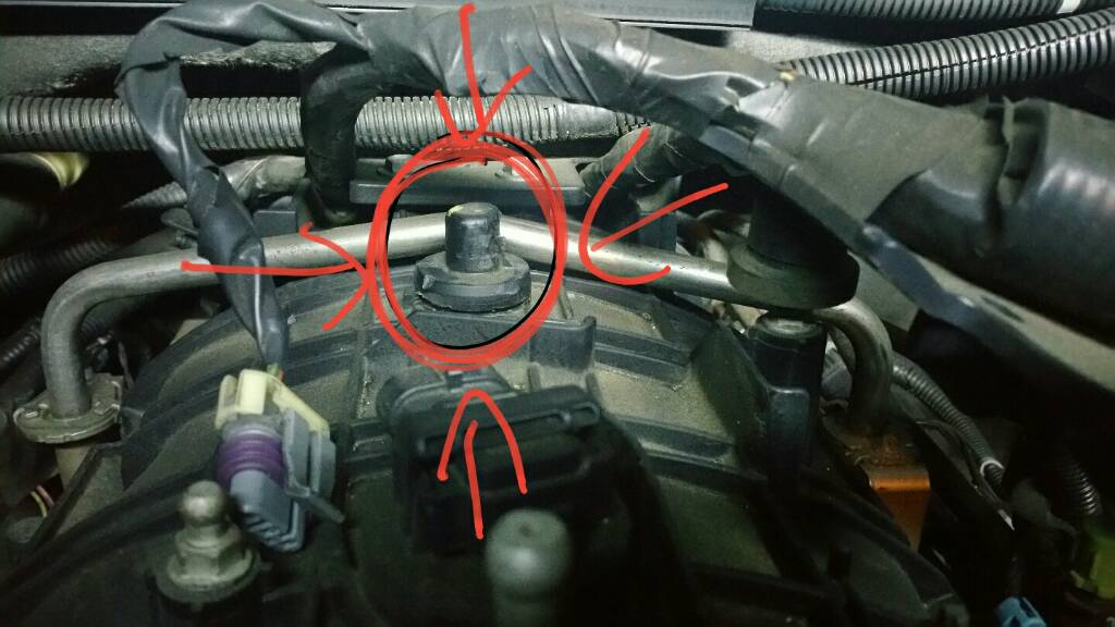

Who knows how to get this out? This is the other end of the PCV Valve on the intake manifold. I was following the Moroso catch can directions to twist towards the front and lift up and *Snap *.
So needless to say, the dam truck wnt run and i cant finish my catch can install.

Is there enough plastic left to screw one of these into the broken hole?

I already gorilla glued. I wish I would have thought of that before I GG'd it.
Dayum.
But I think that plastic would have been to thin. Its not a lot to it. If it doesn't hold, it will get a dab of silicone or something to make due. I dont have the time to spend 6 hrs replacing the manifold, so it may just have to go to the dealership. I may see if my warranty covers it.

You have to replace the intake manifold? The PCV valve just doesn't pop out or unscrew? Autozone sells a bunch of replacement PCV valves in the HELP! section.
I don't understand why you were twisting and trying the remove the PCV in the first place. There's no need to remove it to install the catch can. I just pulled the hose straight off mine and slipped the new hose right on and hose clamped.
45,012
Probably was stuck from age. Mine's an '08 with 148K and the rubber hose was pretty ******* that nipple. I worked on it for a few seconds but didn't want to do what the OP did. I used a razor knife to cut a slit lengthwise down the hose and peeled it off the nipple.
I've never had much luck with any of the Gorilla glues. If it fails, remove whatever of the Gorilla glue you can get off and use a gas/oil resistant epoxy like this:
I glued a plastic EVAP fitting to a steel fuel tank (custom tank conversion) with this and never once had an issue. If it even had a small leak, I would've gotten a P0420 code.
