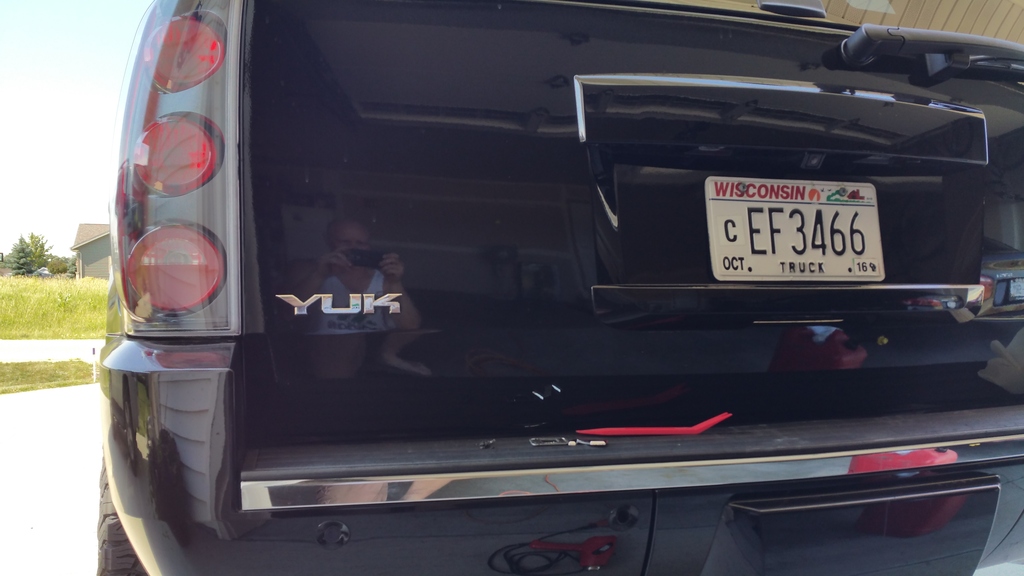

More like this weekend...hacked the metal on my front fenders and trimmed the plastic on the running boards to clear the new wheels and tires. Have to figure out how to fill the running boards, they were hollow. Thinking about some black silicone. Got some shine on the new tires. Replaced air ride compressor. Then had to dick with the A/C, driver side was hot air only and passenger and rear were ice cold after battery disconnect for compressor install. Disconnected battery again, let sit for a few minutes, reconnected, put key to on and let it sit for a couple mins for the dumb thing to "re-learn"? Anyways it worked, maybe I got lucky. Got the badges off the back gate too.
Goes to stealership on Tuesday to have tires rebalanced so they don't vibrate on the highway and straighten out my steering wheel after the alignment so I don't have to turn left to go straight. To think they were the only ones that could balance my last rims and tires successfully. How fing hard is it?? Good Lord I learned how to do that when I was 15.
Put old rims and tires on Craigslist today too. Come on fireworks money!!!
Wanted to leave it like this:
