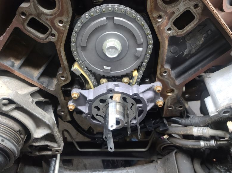

Picture of the shimming of the oil pump install.
I didn't think there was much movement on the bolts until i was actually shimming it.
Very tight tolerances!
Used two feeler gauge sets, got a few dupes thanks to my digital caliper and stacking the feeler gauges.
Top rusty one, I don't even recall where i got that set from.
might have been an estate sale, or one of my grandpas.
For that set, you can't see the numbers any longer, so I have to use the digital caliper set to see thickness.
And to top it off, it's riveted together! :confused:
I have no remorse taking scissors to it... ;)

Damn, that really looks like a pain in the ass. Guess I'm just used to only having to drop the pan to change an oil pump, not removing the balancer, water pump, and front/timing cover
Sent from my SM-G930V using Tapatalk
Most seem to say it's not required.
Melling instructions don't mention it as well.
I did read that some experienced bind in the pump after torqueing the pump down.
This was just an extra step to be sure there is enough clearance for the pump to function properly.
Honestly, it was not that difficult.
Most of the time spent was prep work.
