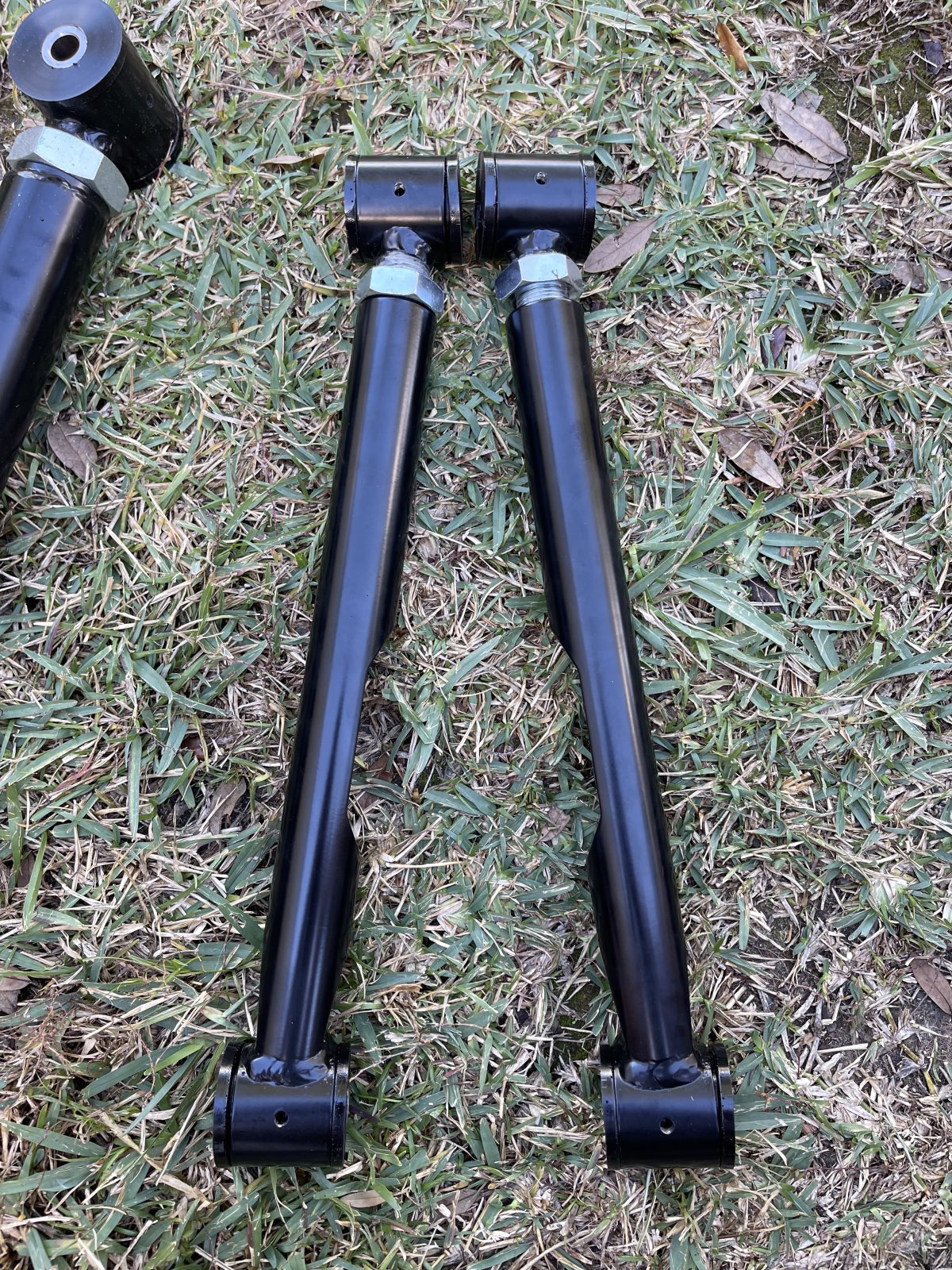

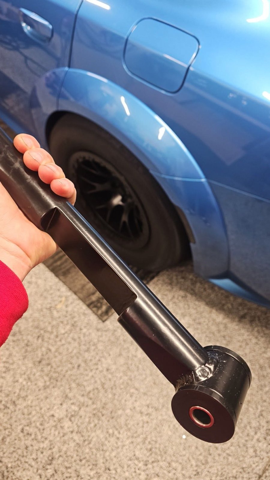

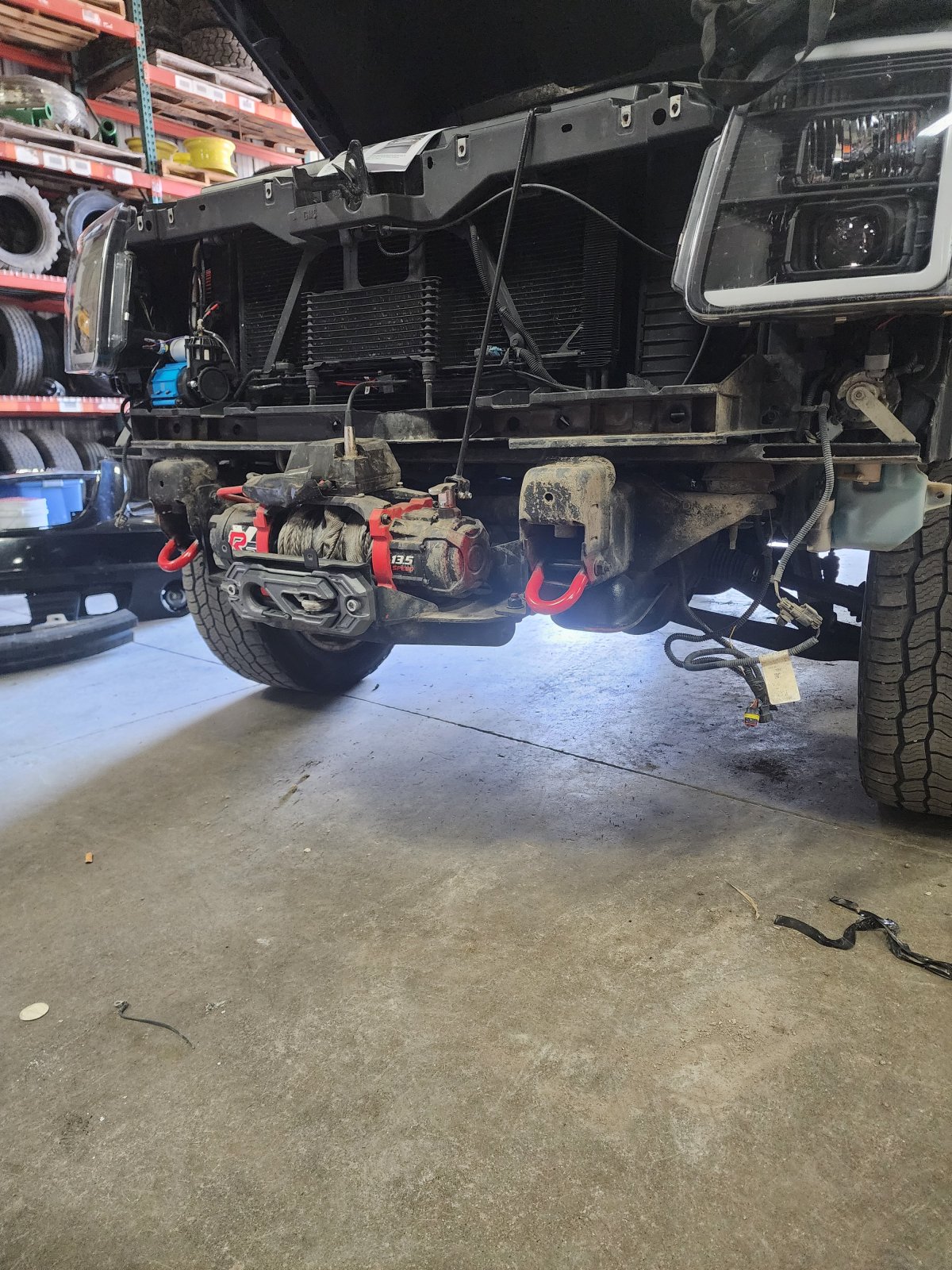

Hey guys looking for some help. If anyone’s installed the Apoc rear arms, did they weld mine with the notches on the wrong sides?
The notches are supposed to be for caliper bolt clearance, so they should be facing out towards the calipers. Some earlier ones did not have notches. It seems like they should be oriented as pictured, with the threaded narrow end towards the front of the truck, and the wider end towards the rear with the notches closer to the rear. I installed them with the notches facing inwards because it seemed like plenty of clearance. Apparently turning up an incline can cause it to hit.
Apoc is telling me the threaded ends should be towards the rear, but that would move the notches towards the front and doesn’t seem like they’d be doing anything to clear the caliper bolts at that point. Trying to figure out if they’re telling me some bs. I ordered them late July and they just got here 2 weeks ago, with 6 delays from Apoc (that I had to reach out about each time - they didn’t tell me up front).
And this is a picture that Tony posted. To me it looks like mine are wrong.
Any help would be greatly appreciated. It’s like pulling teeth trying to get a clear answer
What year are those for? Mine had no notches..'07.

Thanks! It's suppose to be for a Sierra pickup. The winch mount is from rough country, I flipped it upside down for ground clearance.

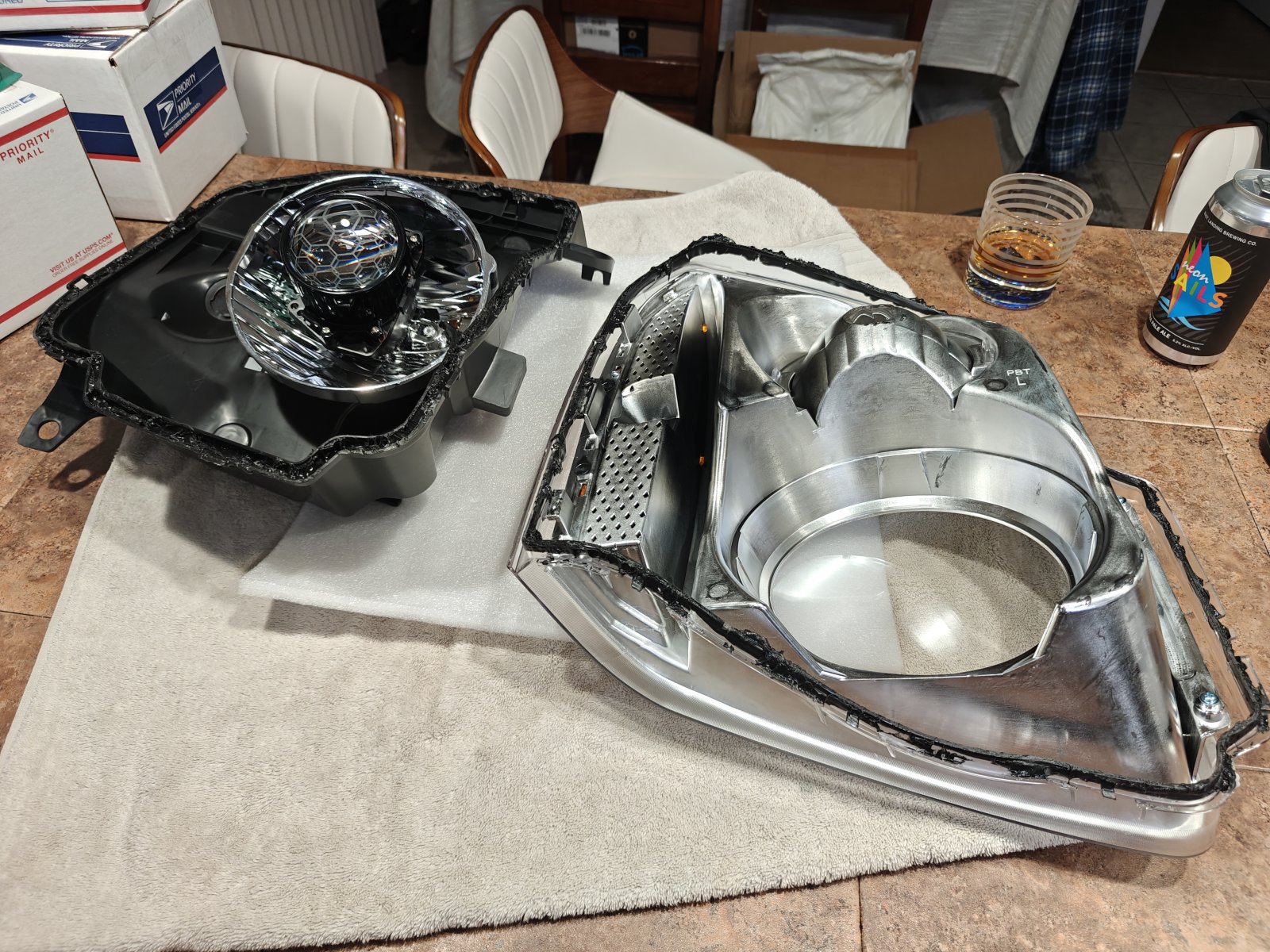

Whoever invented that black sticky shìt need so to die 100x in a row. View attachment 473344
That's too good for them, lol. I was afraid the Chinese aftermarket lights I had would melt, so I used a heat gun instead of baking in the oven. It took a solid 45 minutes to get it open, and another hour to get most of that black crap off the pieces. I wouldn't complain if it actually sealed.
