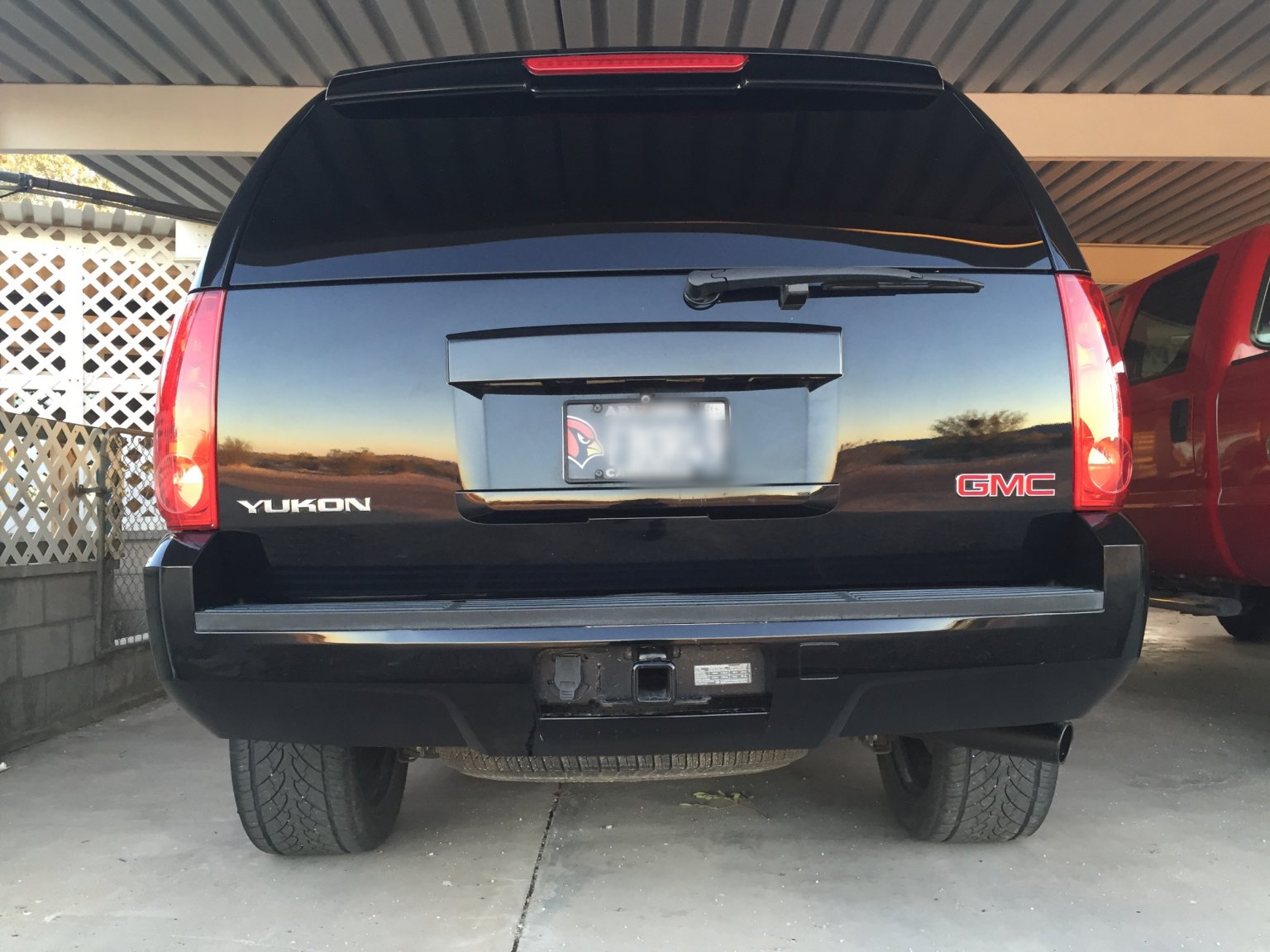

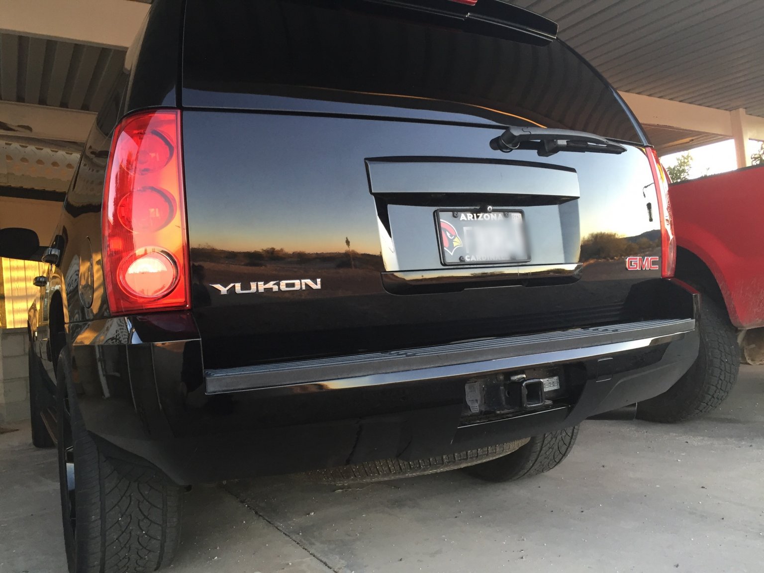

Removed the rear glass handle and Eco emblem from tailgate

Does that handle just pop off?
Sent from my LG-H811 using Tapatalk
You need a heat gun to pry it loose or some fishing line. It's stuck on with some tough adhesive. I used a heat gun and a razor blade then finished it off with some goo gone.

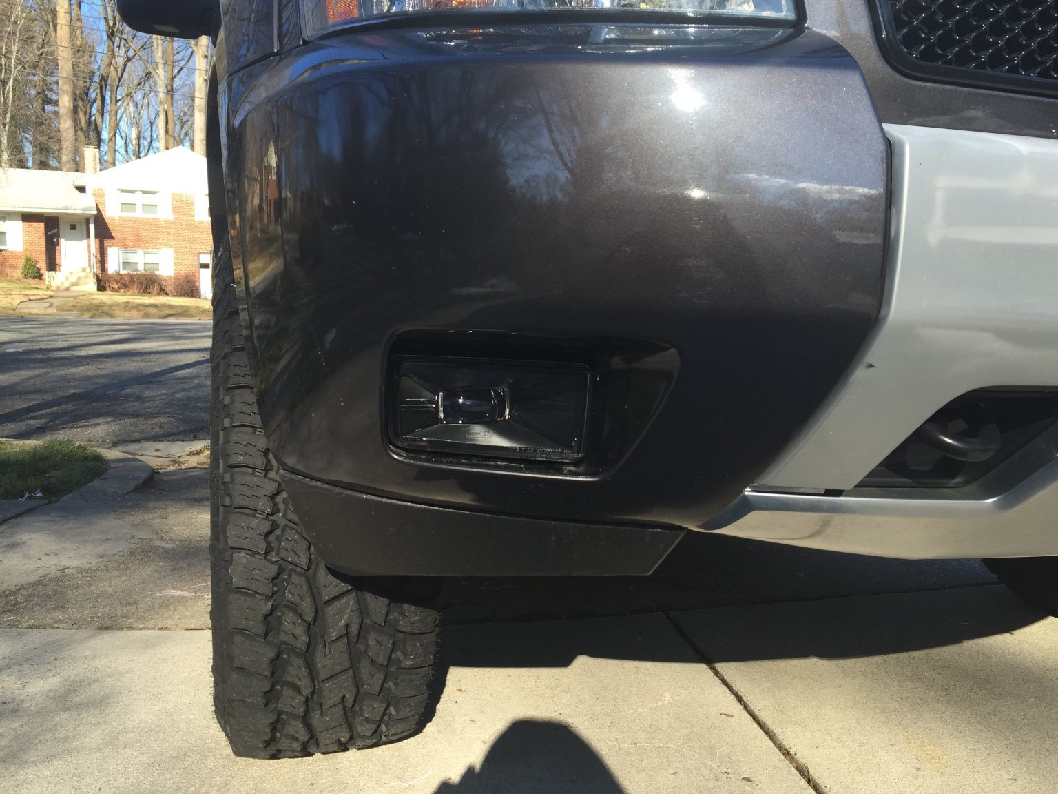

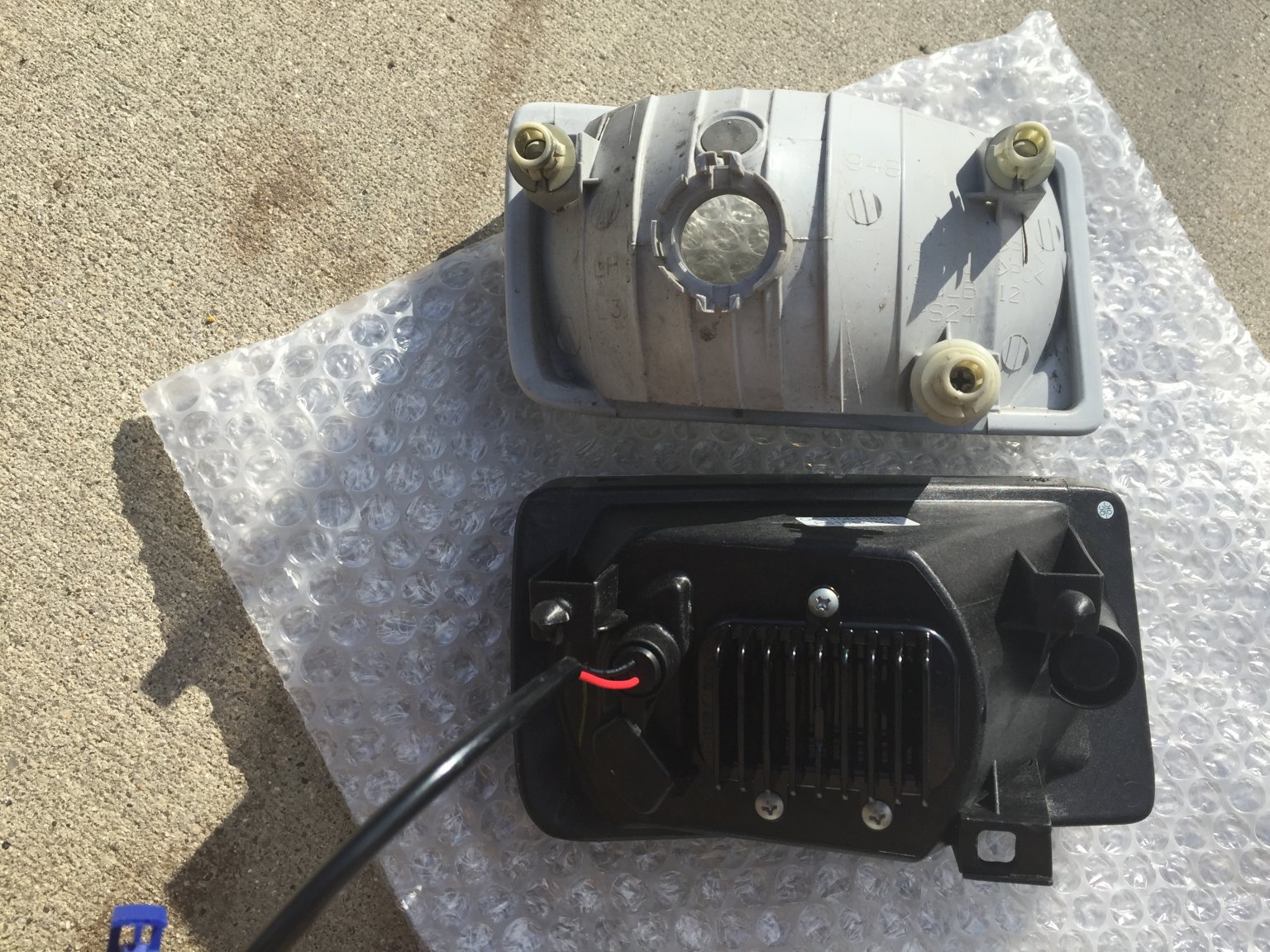

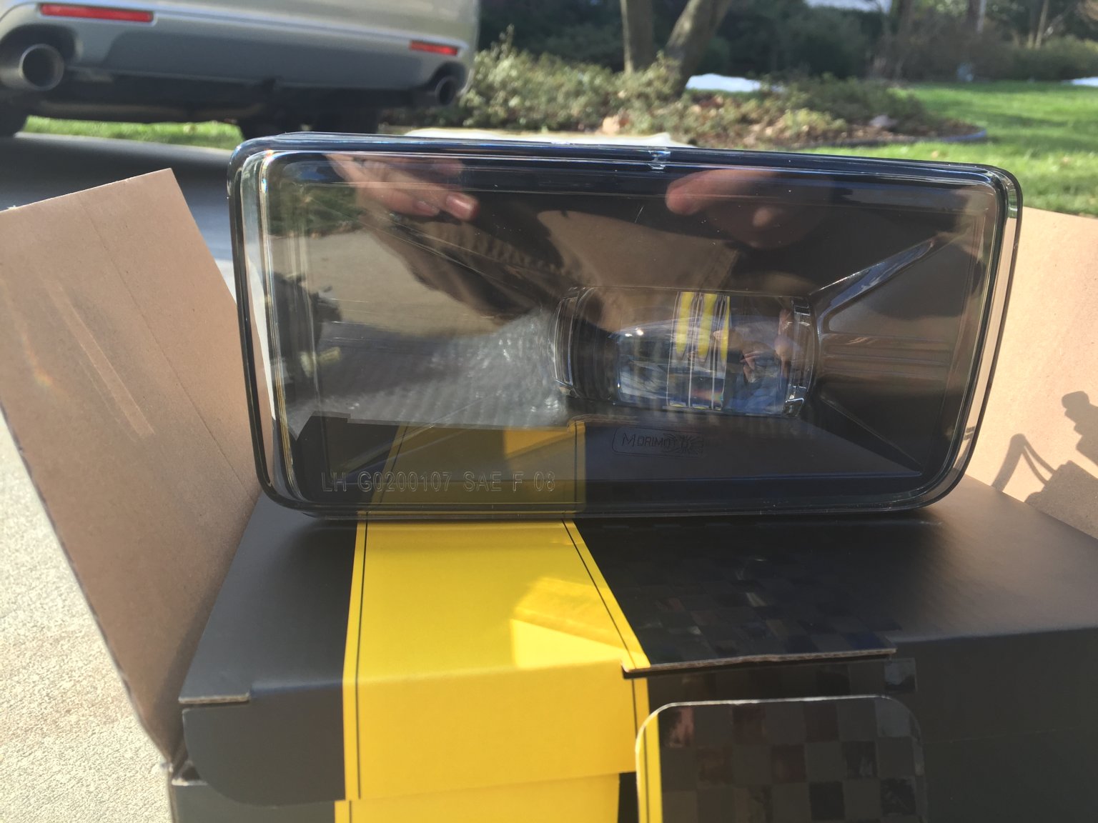

I replaced the factory fog lamps on my z71 burb with the retrofit source's Chevrolet morimoto xb led fogs (square). They were a simple replacement for the factory ones. Just take the old mounting clips off the lights and put them on the retrofit lamps plug in and you're good to go. I got tired of the hid bulbs burning out and this last time the passenger one came out and melted the housing.
https://www.theretrofitsource.com/c...verado-morimoto-xb-led-fogs.html#.VrT5itHSnIU
View attachment 59071View attachment 59072View attachment 59073
Happen to have a picture with them lit up?
