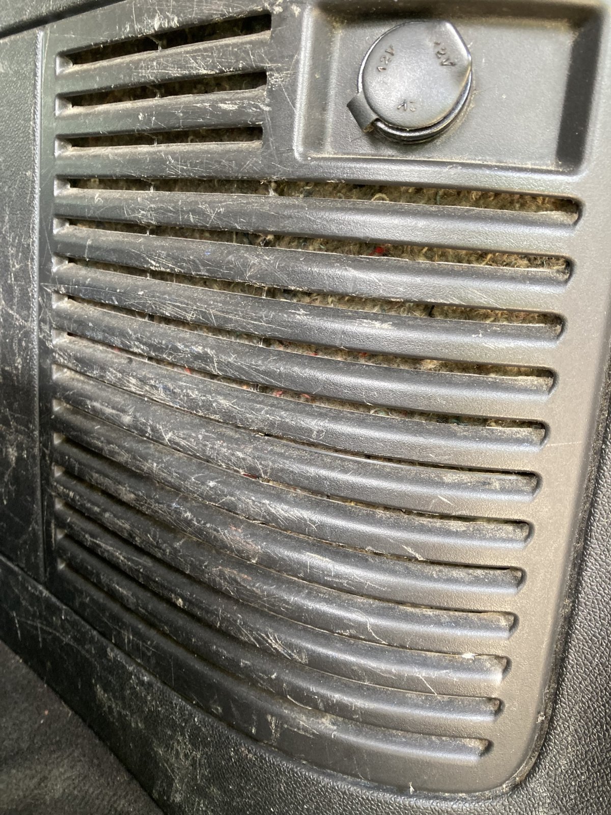

Is there a filter back here or do I just shop vac the grille slots on this rear AC intake out?

I always thought it was just carpet padding.
No cabin filter up front so why would there be one in the rear?
No filter. Yep just carpet padding.
The rear blower stays cleaner than the front one.
I think all the dust settles out by the time the air makes it to intake on the backside.
Also there is no fresh air intake for the rear.

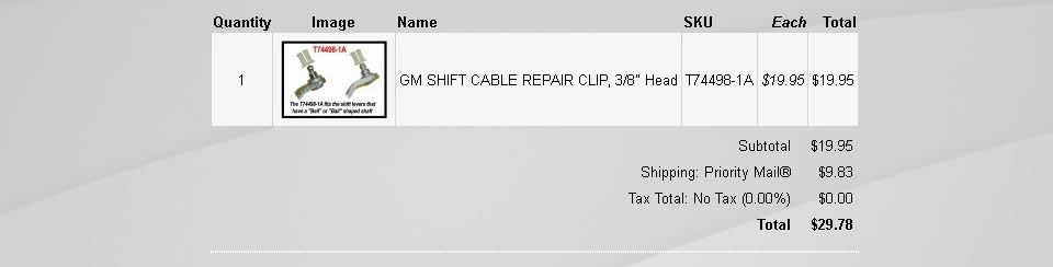

mikez71
Mar 9, 2023
3,334
4,137
i ended up using a Fitzall T74498-1A, Then drilled the nipple and put a washer on the outside and a cotter pin. it been fine for over 4 years now
autoparts store has a multipack of small cotter pins, the nipple drills easily it's not hard metal.
I guess the dorman is probably similar, would still use a washer and cotter pin though, that makes it impossible to pop off again.

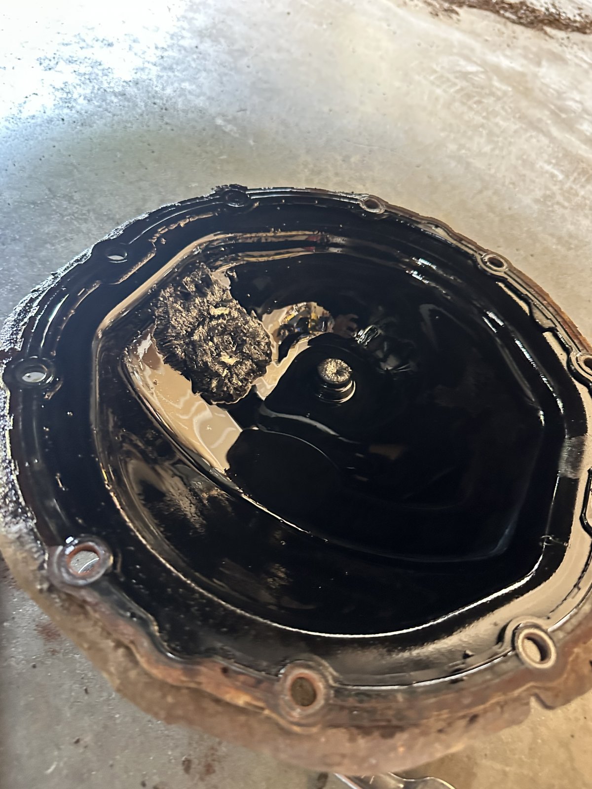

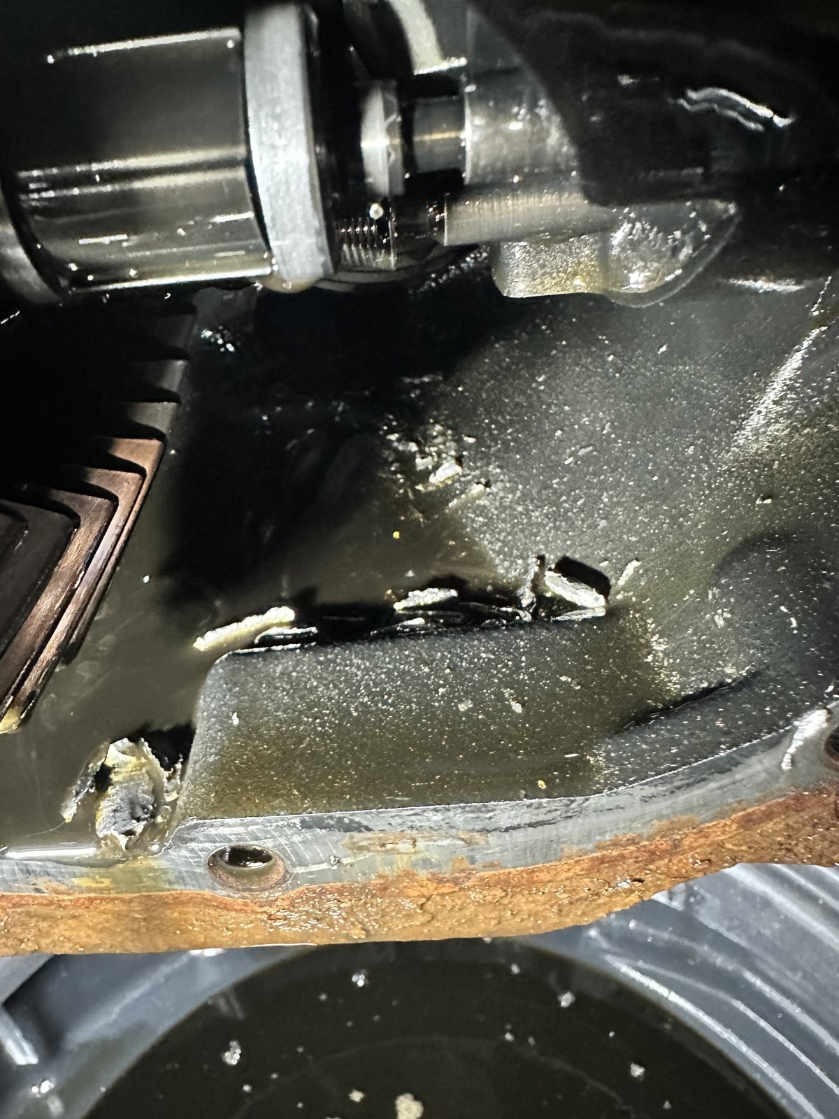

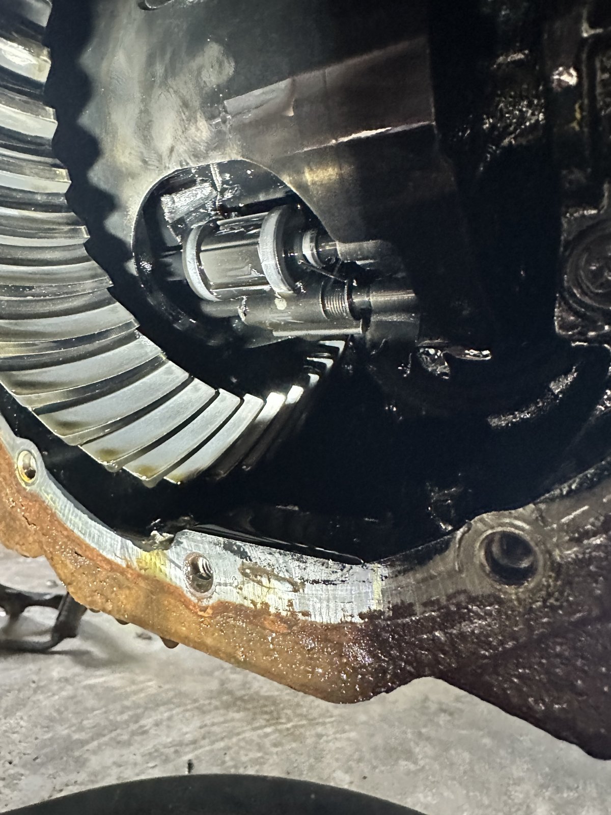

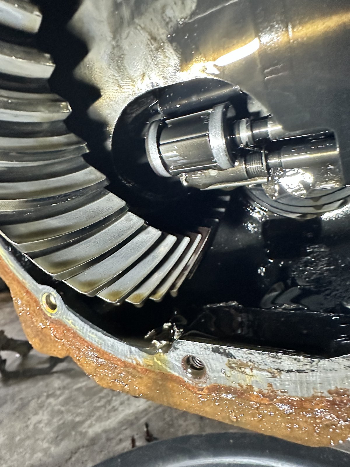

mikez71
Mar 9, 2023
3,334
4,137

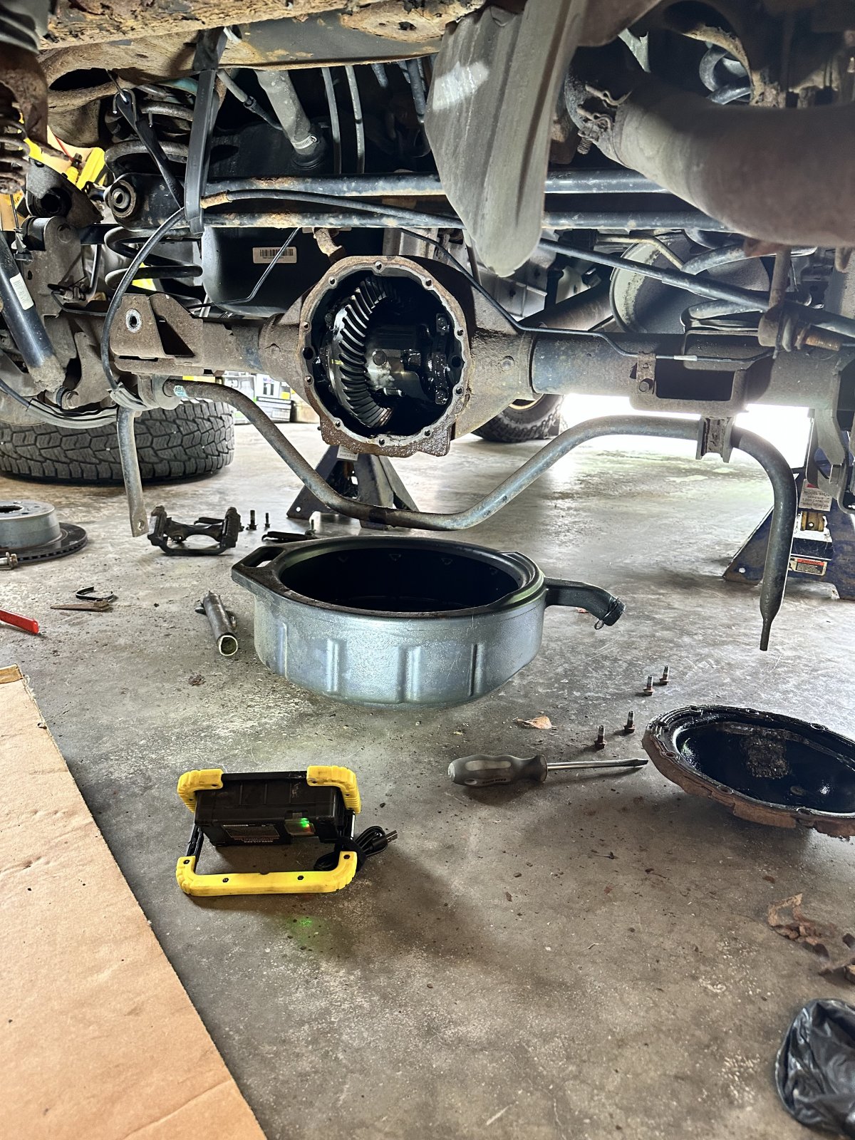

There's a lot of metal NOT on the magnet! Guess that's all the magnet will hold..
Did anything happen to cause the breakage?
What ratio? AXN axle will drop right in...
89Suburban
Bull in the china shop
Space X Supporting Member
Jan 10, 2013
18,031
51,349
SE PA
3.42s
First thing i saw when j pulled the cover….lol… thats a pile of metal…. Lmao
Yeah, my daughter happened….
That's why it's called the Gov-Bomb.
