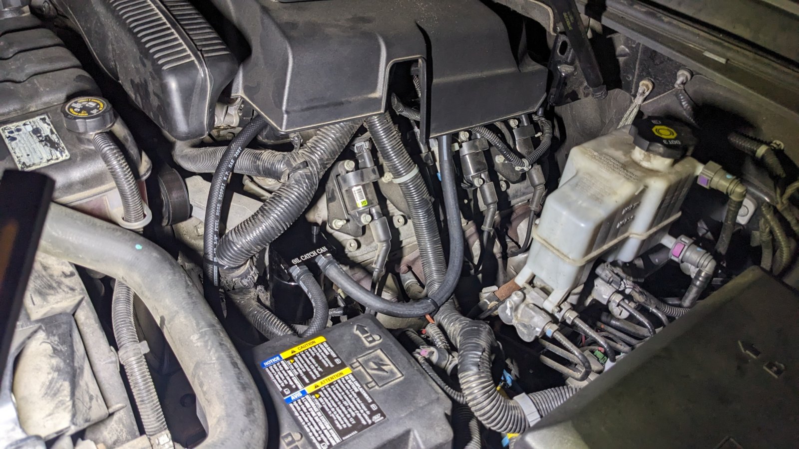

Easy there, jdpber.
I assume you're asking where we're plumbing them in. There's a rigid plastic pipe connected to a port at the rear of the driver's side valve cover, runs forward about 8" then makes a 90° curve to go to a port on the top center of the intake manifold. You'll have to pop off the beauty cover to see it.
The catch can goes inline in this circuit. So, in terms of flow, instead of going out of the valve cover and into the intake manifold, it goes out of the valve cover and into the catch can. Then, out of the catch can and into the intake manifold. How you connect the catch can to this pretty much doesn't matter as long as you have the flow correct. That plastic port on the intake manifold is very brittle and can easily crack off if you move it much at all. Safest method is to cut the plastic pipe where it makes that 90° turn a couple inches in each direction from the bend. So, you're basically removing that bend so you're left with two straight pieces of plastic pipe- one coming from the back of the valve cover and the other from that fitting on top of the intake manifold. Then, slip the hoses of your cartch can over those short lengths of pipe and secure them with hose clamps.
IMO, the best location for the can itself is on the side of the alternator, bolted to that accessory bracket. It's easy to reach for draining and doesn't interfere with anything else.

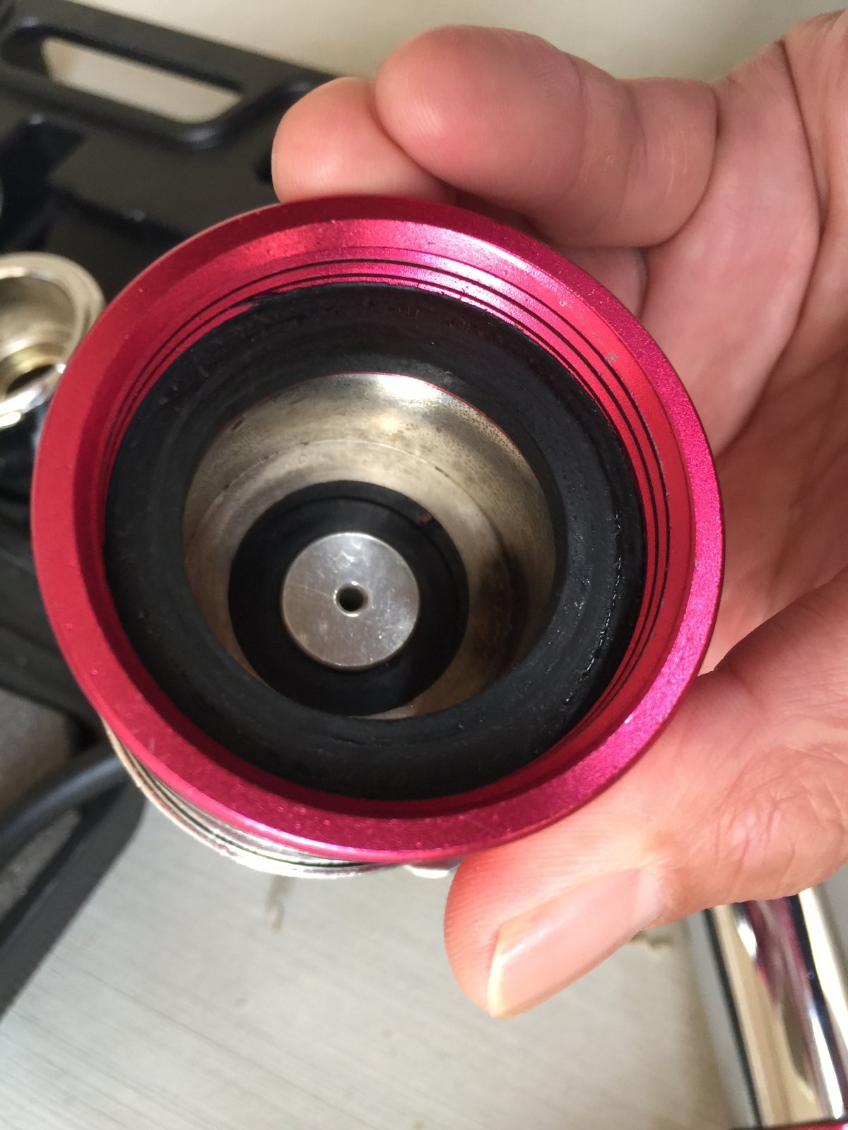

Could be, but the rubber seems to fit snugly after releasing the sprung hose section.. and I can put the entire screw on adapter in my palm and build pressure.
Adapter does not bottom out on tank, but on top of threads. Good thick rubber gasket.
A small leak with the air volume in the reservoir might be harder to find..

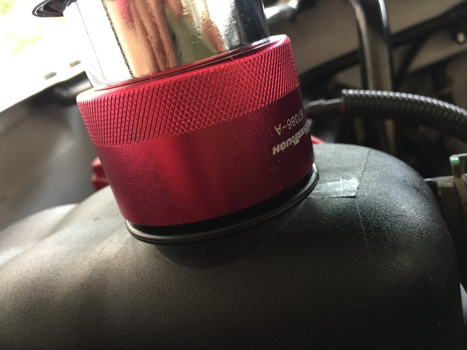

Can't pressurize the cooling system! I pump and pump and no pressure.
Seals on tool look good. I can plug the air hole on the tool with my finger and build/hold pressure.
I can see coolant in the tank moving from the airflow (the corner by the cap).
I dribbled soapy water on the seams of the tank and the small hose to radiator, and all around the tool attachment.
can't find the leak but I didn't have a sprayer for the soapy water..
Not pushing water out, so I think it's leaking somewhere in the top air part of the reservoir.
When I remove the cap with engine warm (After cooling a bit), air rushes. I think it's vacuum, perhap the leak seals with vacuum.
I have a new tank and cap on the way, will probably get a couple of the small hoses as well.
I wanted to pull the small hoses and plug the reservoir, but I don't have any caps in that size.
Let me know if I'm doing something wrong!

kit ony had 1 adapter with internal threads. Snugs up on the tank properly from what I can tell.. Will rent again when new reservoir arrives..

I got one from oreilly's, only had about 5 adaptors.
But honestly I can't see how it would be leaking because I can seal it on my hand..
and it screws on the reservoir with a thick rubber gasket which I can feel compress.
