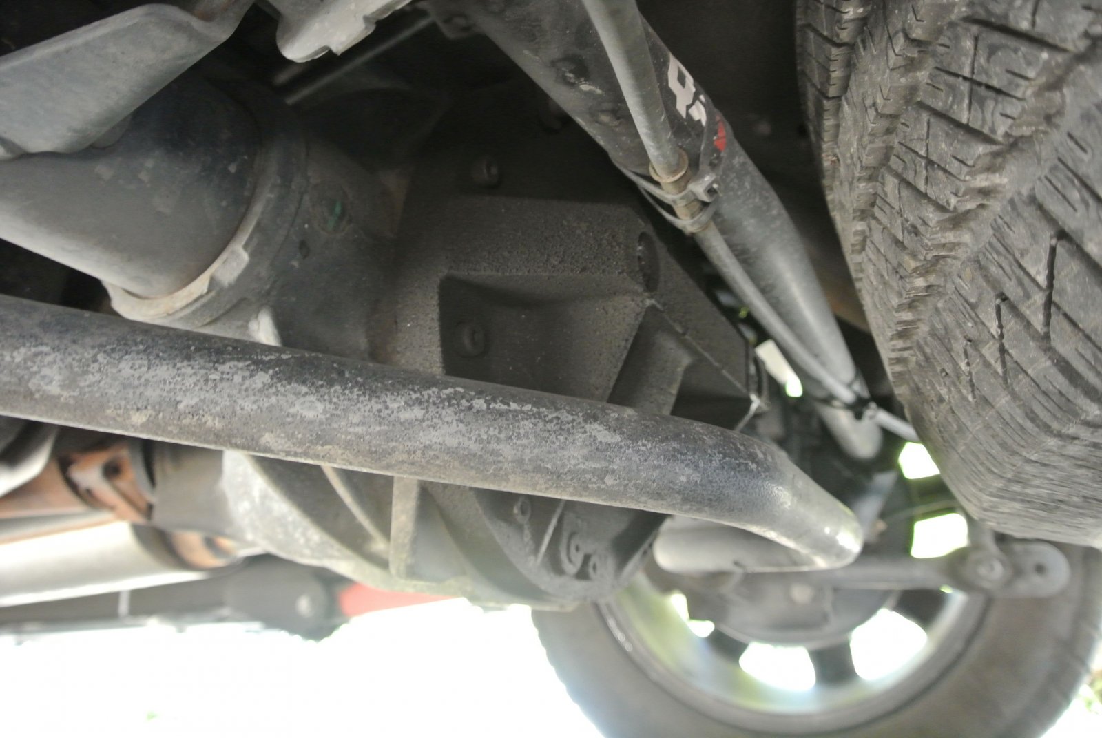

from outside appearance's it looks like QA1 is no longer making them, there is 3 available on Amazon
Summit has 3 in stock for $126
The funny thing, they also have the Yukon Gear nodular cover for $225 while Amazon has it for $109
Does this QA1 cause interference with anything else, like spare tire, etc? And what do you do with the parking brake cable that runs along and clipped to the OE one, just zip tie it to it?
no, it just has a very slight curve right over where the cover sit's, it's a pretty tight fit with the girdle.
mine is kind of dirty at the moment, whenever I change the fluid I need to put some plumbers tape on the bearing caps they sweat a little.
Is that on your truck or Yukon?
I wouldn't think a cap support cover would be needed with the AWD, as not all the power goes to it unless putting down some mad powerz, lol

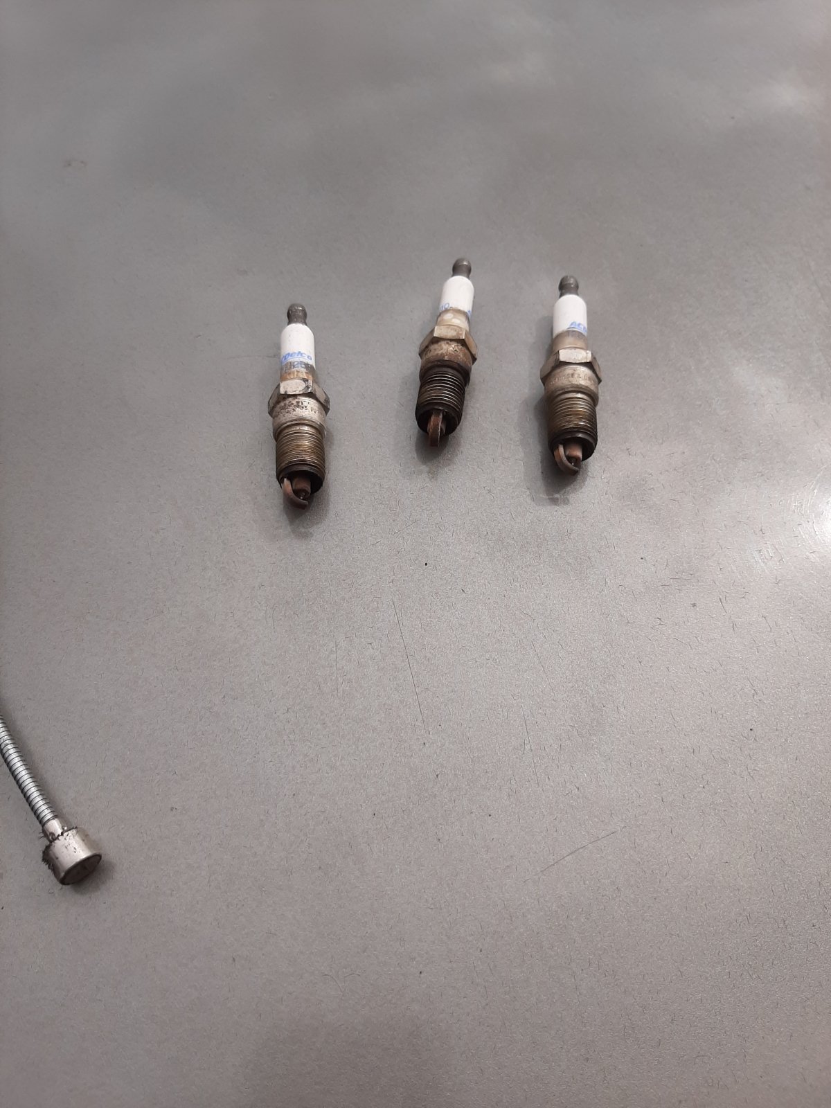

Well I'm now only getting a misfire code 302 on #2 which of course didn't get the code until almost dark. The problem plug was number 7 snapped a shaft I tighten all up and no error on that side.
Probably the wire. They like to pull the connector apart inside the boot when you pull them off, especially if they’ve been on a long time.

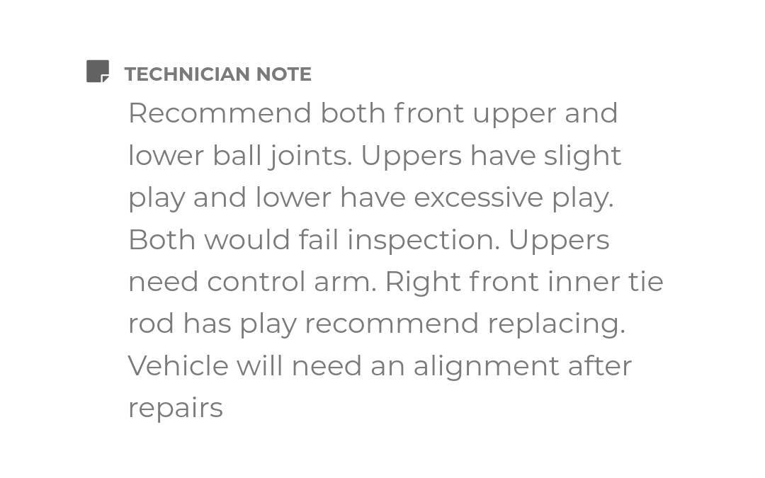

Took it to have state emissions inspection and alignment done. I don't need a state safety inspection yet because the mileage is under 150k, but I guess they did a suspension inspection before doing the alignment and sent me a txt with this info....
It has 137k on it and all the above parts are OE. Ive done lower ball joints on my 2011 so I know whats involved. Uppers are just a swap with new arms. What's involved in the inner tie rod replacement? I've done them on other vehicles, does the yukon have pretty much the same setup or is there something special?
Nothing different other than it is rack n pinion, and unless you get it pretty dang close you might get some death wobble on the way for alignment.

Just talked to the shop. The emissions inspection passed and is ready (even with my BT Dieselworks AutoSync plugged into a OBD splitter cable.
They didn't do the alignment because of the bad ball joints and tie rod when doing the before alignment inspection. They quoted me $2100 for all of it including alignment (2 upper arms, 2 lower ball joints, 1 inner tie rod) and needing all day to do it.
