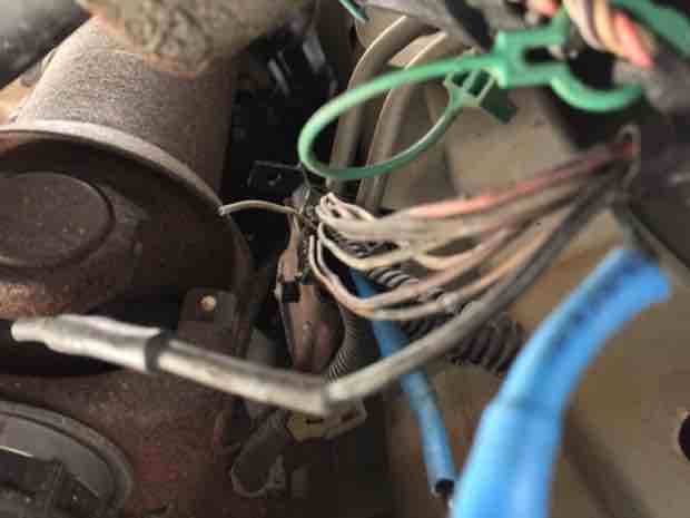

Fixed my p0449 code finally. Chased a wiring nightmare and found the broken wire. And some previous mechanics attempt to "fix" the same problem. I found 5 different spliced connections. ImageUploadedByTapatalk1426284108.243735.jpg
Fink117
Jul 20, 2013
88
This set of wires were next too the transfer case for 4x4
---------- Post added at 05:16 PM ---------- Previous post was at 05:12 PM ----------
I started with this video to test the vent solenoid first.
http://youtu.be/IWYdiuopt8k
This originally worked. But the stock wire they used corrodes everywhere which is why the guy made so many patches. If you have questions feel free to ask.
