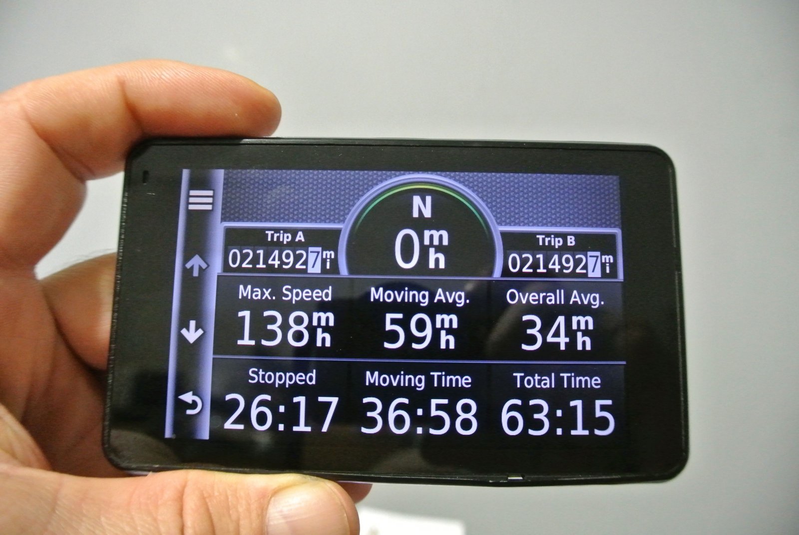

Did you have to plug anything in the OBD port for the HU to show that data?
no it's GPS data from the head unit just like my garmin has, only difference is I have never reset the trip on the Garmin, the pioneer records each trip and then saves it, after a few trips it overwrites the old trips when it runs out of memory, still can't believe I put 21k on this Garmin, I only use it for road trips where I might end up in a dead zone. You can get out here in the mountains and end up lost easy

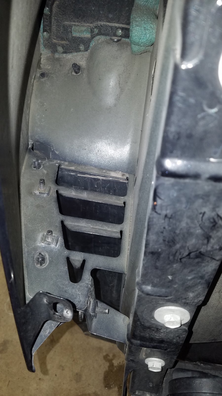

Have you ever looked inside the fender below that hole for the airbox? That area is kind of closed off and has a few louvers punched into the sheet metal. View attachment 360348
I have not. But I guarantee you it's not hurting for air volume and the temperature of that air is FAR lower than what a hacked-up air box would allow in. When idling for a few minutes, my IATs eventually got up to around 3° over ambient. When cruising, 1° at most and it dropped there almost immediately.
When I remove my inner liners to mod the sheet metal for tire clearance, I'll study that corner. Thanks for bringing it to my attention!

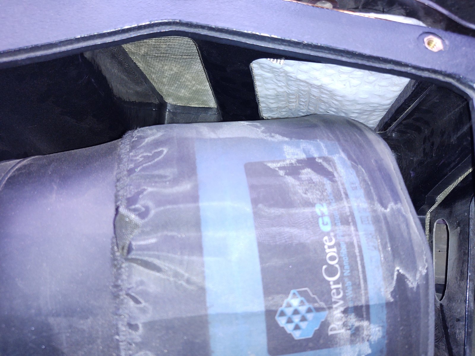

The volant version can have an air scoop attached to the bottom to grab air from under the bumper on the pickups. Wonder if it would work on the wagons?
Ah, 4" OD straight down.
Has a large opening facing the fender well where the factory opening is.
And two openings in the front that I blocked off for now to help push air through the radiator instead of around it and into the intake... Still need to install my new rubber shrouds for the radiator to fix that.

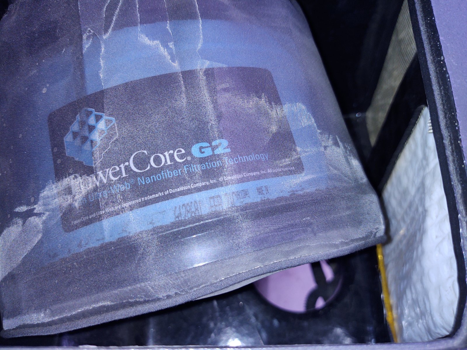

Corsa uses the power core G2 dry filter.
