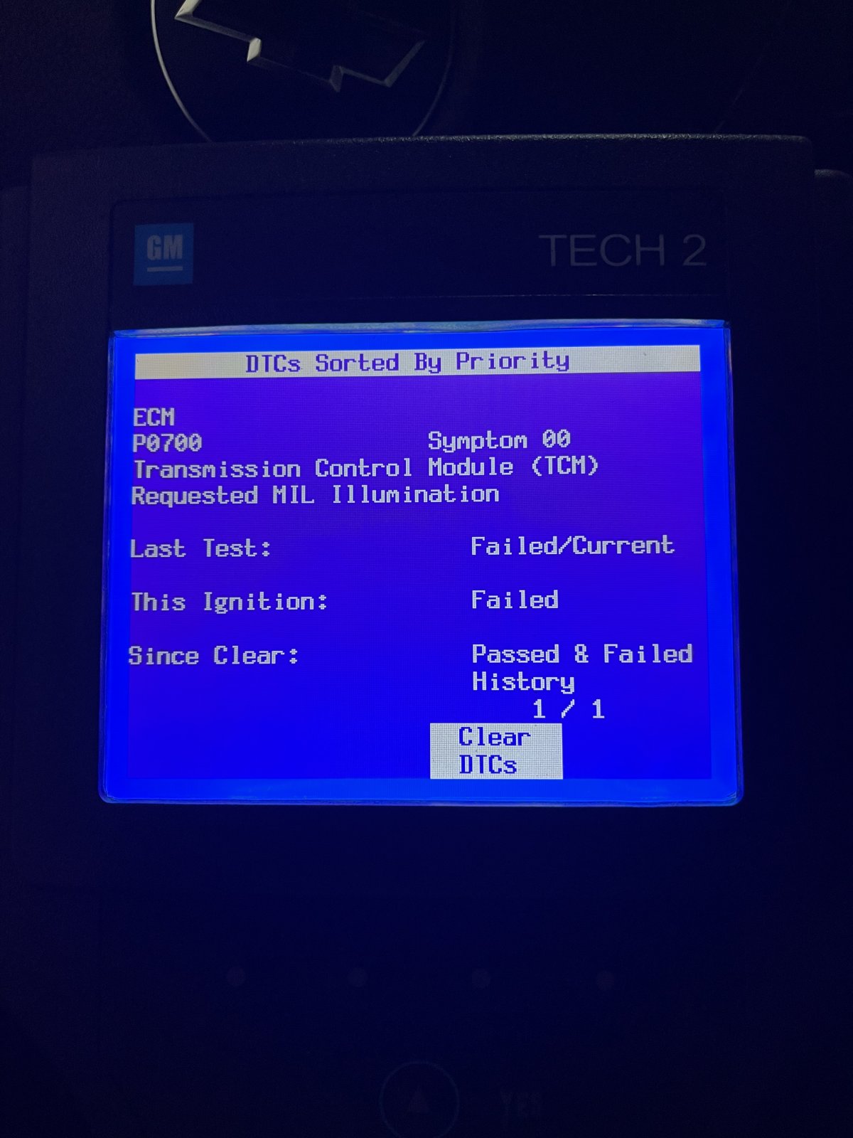

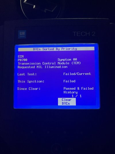

I was headed home from the dr’s office yesterday and while i was on the phone with my sister my service stabilitrack message popped up along with my service engine light. Was able to get home, hooked up the tech 2 and got this. Cleared the code, went for a long drive to see if it would happen again. Hopefully it was just a 1 off thing
What trans do you have?
30,563
48,043
that sucks, the TCM is inside and is part of the valve body I think the valve body can be changed by dropping the pan and then it's a few more bolts I watched a video of a guy doing it made it look pretty easy. But it could have been a different part maybe it was the techm
one thing to check is the wiring harness, there is a bulletin for the wires coming loose from the harness connector and causing a variety of problems including your p0700
this is it right here
Sheesh… fingers crossed it was a fluke
What’s the code after the tcm? There has to be more than one.
bulletin say's it could be 1 or more
"Depending on the vehicle and build, technicians may find one or more, but not limited to the following, High Speed GMLAN Communication DTCs set as Current or History:"
