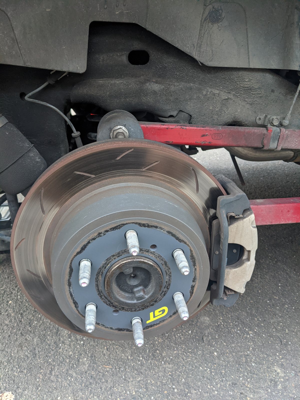

Had to bend the brake pad tab to stop the mouse, new brakes are on the way, only a cuunt hair of pad left and figured I may as well lube the control arms while I am at it

30,563
48,043
Mr. Nukem,
Which pads did you buy? Still can’t figure out which pads to get for my front calipers.
I buy the autozone premium ceramic, that's what I have on there now, when the new rotors show up I can take the old pads over to autozone and get free replacements under there lifetime warranty. I originally put the police semi metallic pads on there and they lasted me about a year, the premium ceramic have been on there about 2 years. I am very ******* brakes nothing last longer than the premium ceramic they would probably last a normal person much longer.
