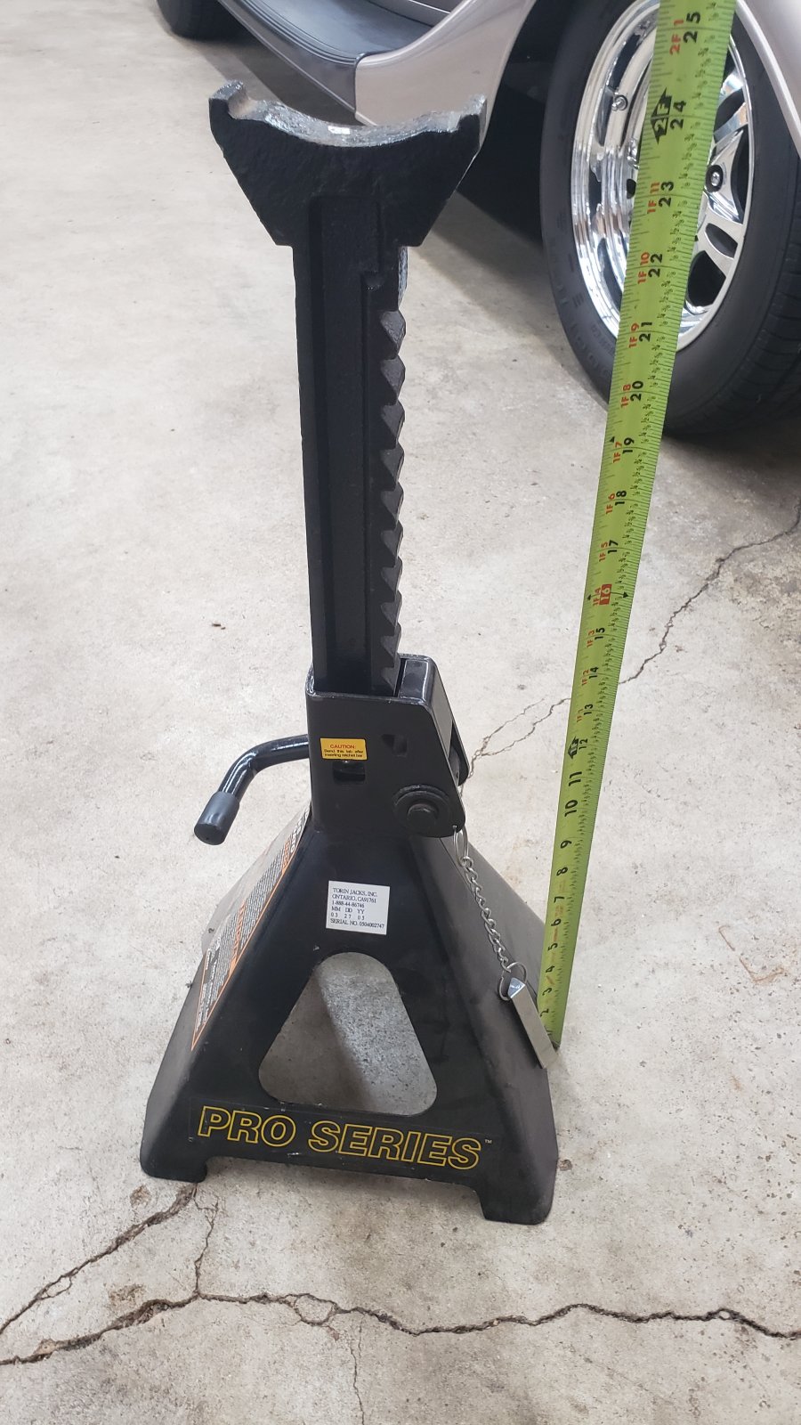

Yesterday we got around to replacing the tie rods on the Sierra. Our Pro-Lift 3-Ton jack stands are barely tall enough to reach the bottom of the frame, we used two on the side we were working on and lifted from under the control arm until the tire was clear of the ground. The ACDelco 3-Ton stands were too short. I think we'll eventually pick up some 4 or 6 ton stands, they can lift above 14 inches.

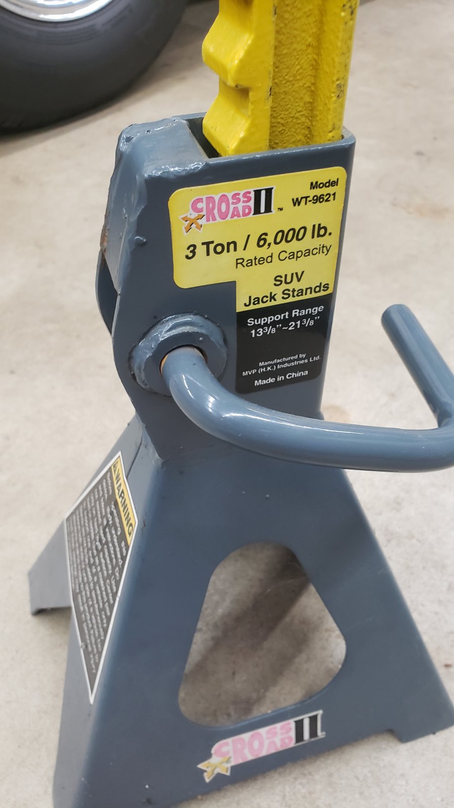

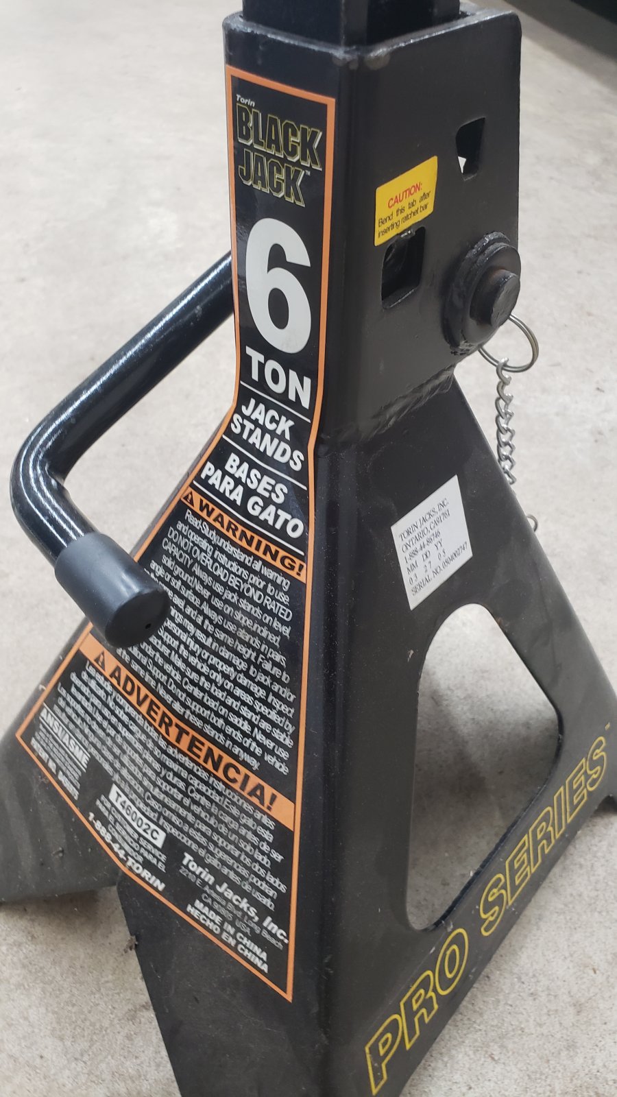

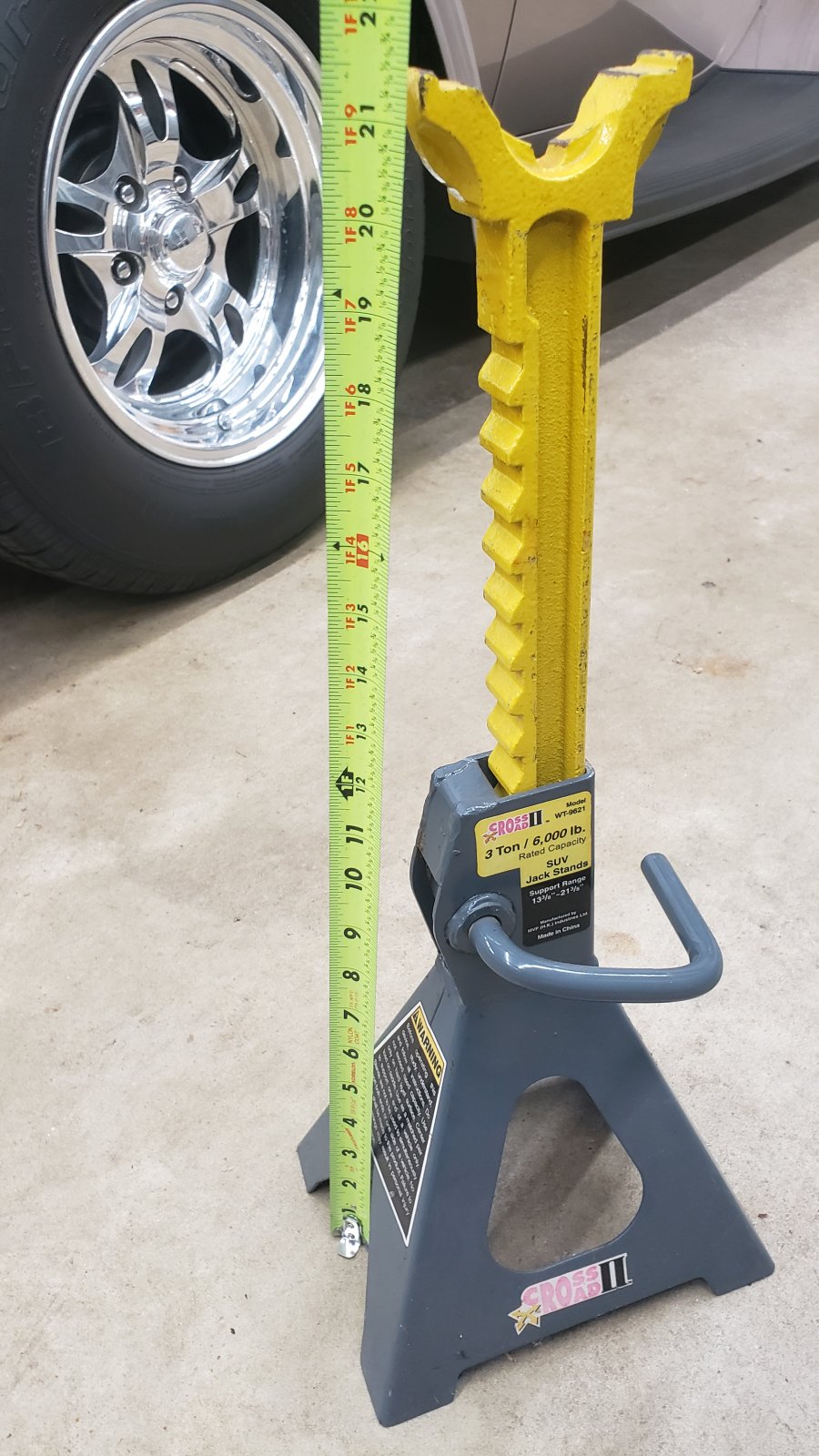

My Torin 6 ton stands go up to 24", but I hardly ever use them. I use my Crossroads 3 ton stands the most, they go up to 21", and I have 2 sets of 2 ton stands.
