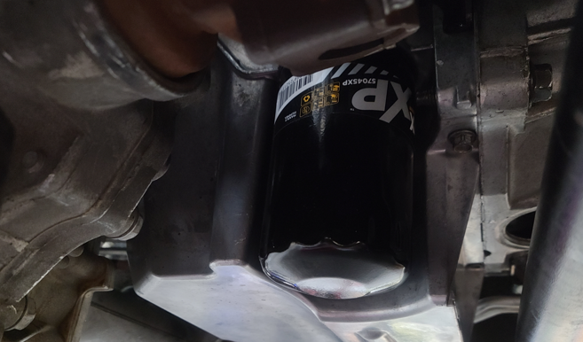

So i noticed a little while back that the filter for my wifes 2011 buick enclave v6 has a larger capacity filter that appears to be a match for the tahoe.
I did her oil for the first time the other weekend, and noticed that the prior owner put on a different filter.
Slightly larger capacity than the one that the car calls for.
So i went
:hmmm2:
I ordered a couple to check out.
Tossed one on the hoe for it's first run.
Pretty much flush with the bottom of the pan!!
I think we have a winner.

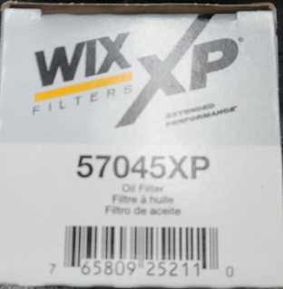

Yup, here's a couple more "long" filters from GM, Mobil, and K&N.....
PF63
M1-212
HP2011
Also mentioned the 57045 filter in this same thread back on Monday to Avalonandl
and you even "liked" it, lol

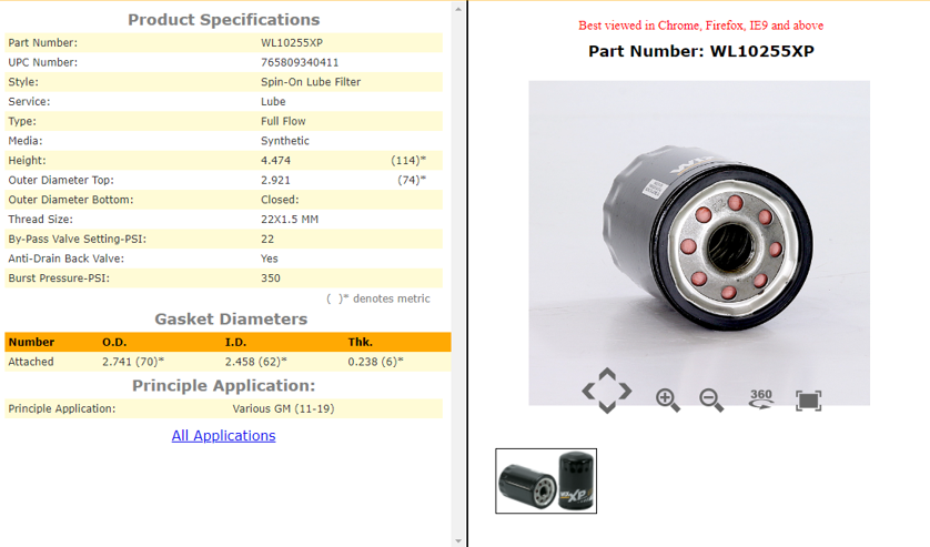

I just did some spec pulling for some filters in my build thread.
I think i might go with the 2011 enclave filter.
has a oil bypass pressure of 22psi vs the 12 that the hoe's filter calls for.
pn: WL10255XP
PF63
M1-212
HP2011
Yeah i actually saved the pn, and just noticed it was there. :jester:
but now we have an image!
pn: WL10255XP
Is that better?
What exactly does that mean?

Is that better?
in my brain it sounds better.
Less psi = it will bypass sooner?
Higher bypass psi = force stuff through the filter for longer before it starts to bypass unfiltered oil?
