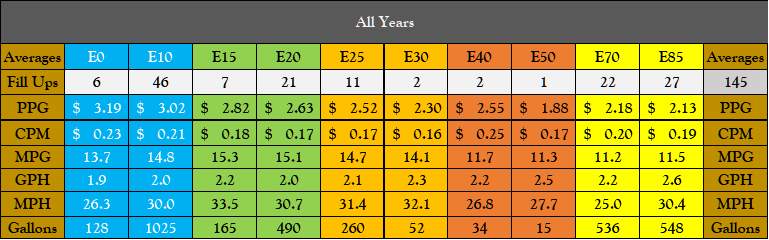

Here are my averages after 145 refuelings:
Note: E0 and E10 are always 93 octane. The only time this motor sees 87 is when mixed with E85.
Bill, there are lots of stations that sell ethanol in Florida but it does depend on where you live. There's but two in the Daytona area, 8 or 9 in my county, dozens in and around Orlando, about a half dozen in the Tallahassee area. Don't you live near Roger in the Naples/Fort Myers area? There's about six or seven Marathons, Racetracs and Union 76s and some are real proud of it!
I run it for three reasons, for the fun of it, for its cleaning properties and when mixed and or when the price is right, because of cost.
If you look at the chart posted above, when we mix E85 and gasoline to get an alcohol content of E15 or E20, my motor at least, gets it best gas mileage. At four cents a mile difference, it adds up to twelve dollars less spent on fuel over 300 miles.
Of course, those who burn 87 will have completely different numbers and experiences. Since getting my license at 16, I've endeavored to stay away from low test gas whenever possible, it's just not good enough for these old fashioned motors. DI motors? Different story as Gary taught me.
I have a giant Lead shoe I wear while driving, but with the border patrol style front bumper cut, tow mirrors, 33" tires, and front end lifted 3"s(rear only 1"), I average about 8.5mpg on corn and 10.5ish(I haven't run it in a long time to do any numbers comparisons) on 87.
All highway is maybe only one or one and a half MPG higher for each.

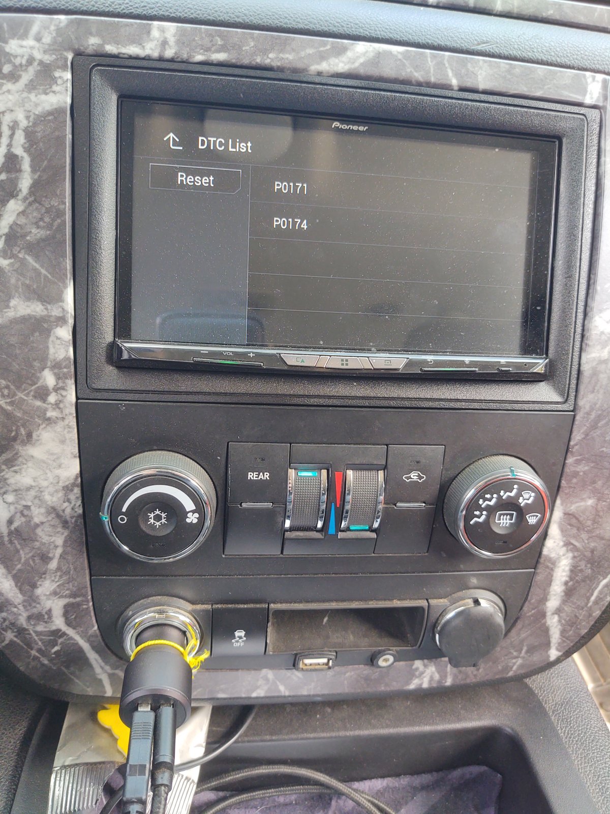

On another note.
Took a while, but it finally doesn't like the Corsa.
Guess I should actually put my wide band in that I've had laying around for at least 2 years.
Time to relearn HPtuners and do some maf fixing to correct the lean fuel trims.
