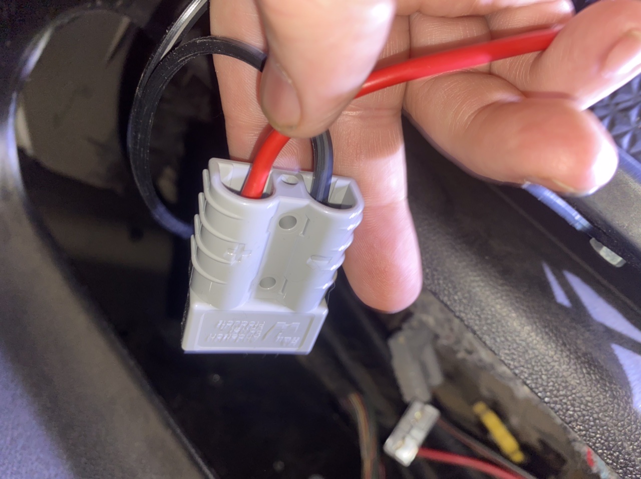

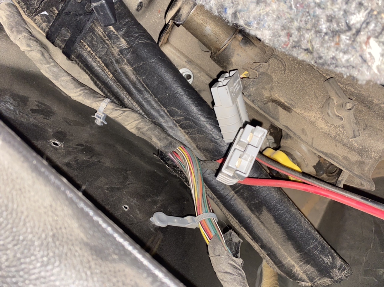

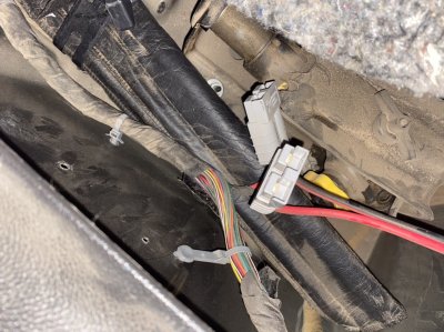

Hard wired the fridge into thecopcar. I had previously terminated the 50 amp trunk feeds, and just needed to add a matching powerpole on the fridge cord.

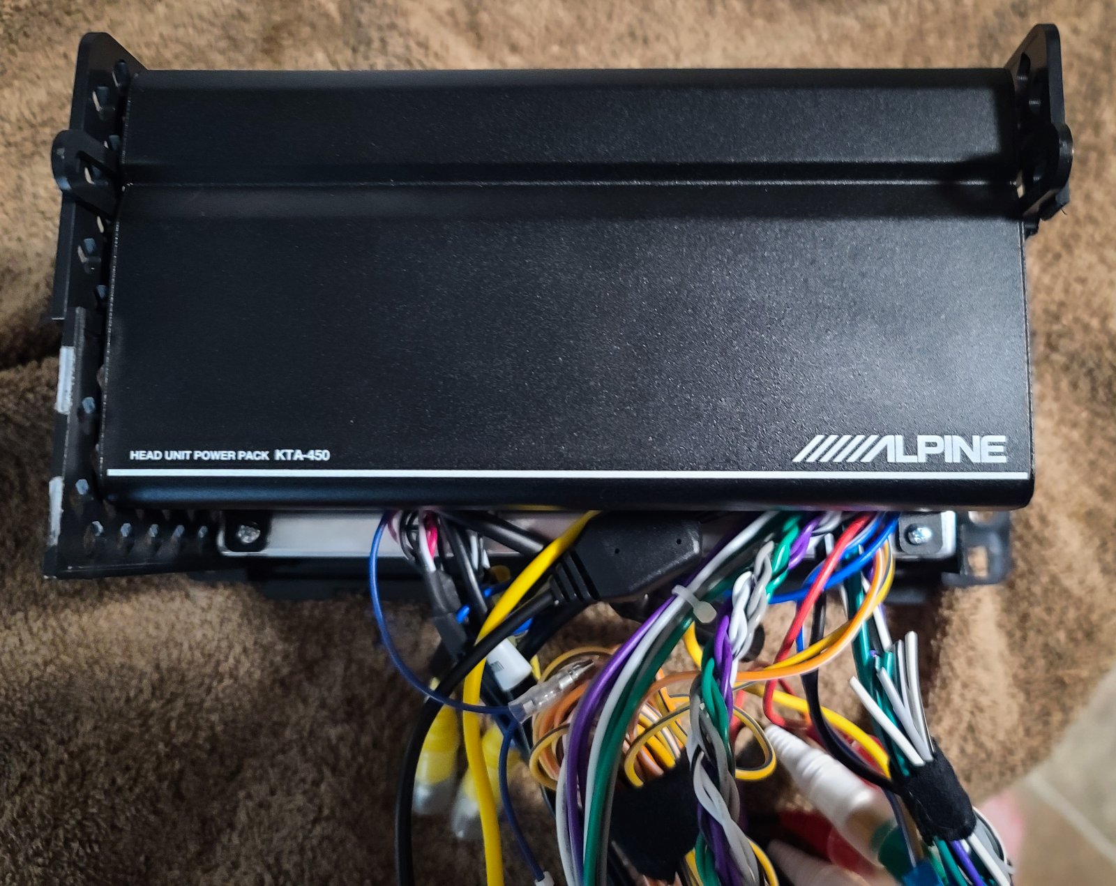

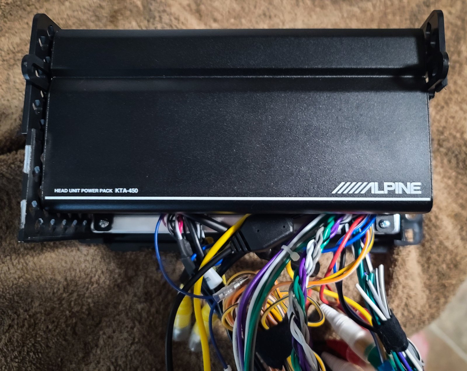

No gain adjustments or anything else you need to adjust on that amp? I like to be able to access mine.
It has a dip switch for 2 or 4 channels, a high pass filter for front and rear (off/60/90/120hz), and gain front/rear. I'll have to pull the head unit to tweak gain, but I'm not constantly driving these speakers so I'm not that worried about it. But I can adjust the gain without removing the DD mount.
