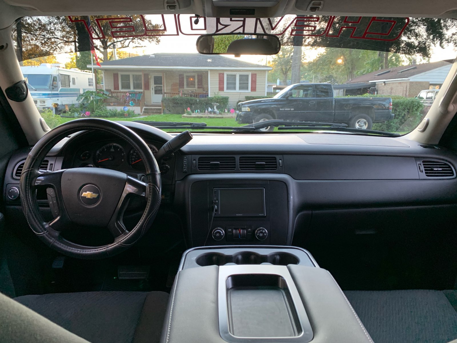

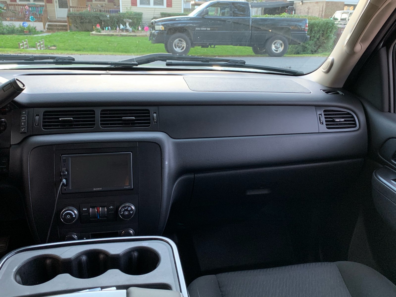

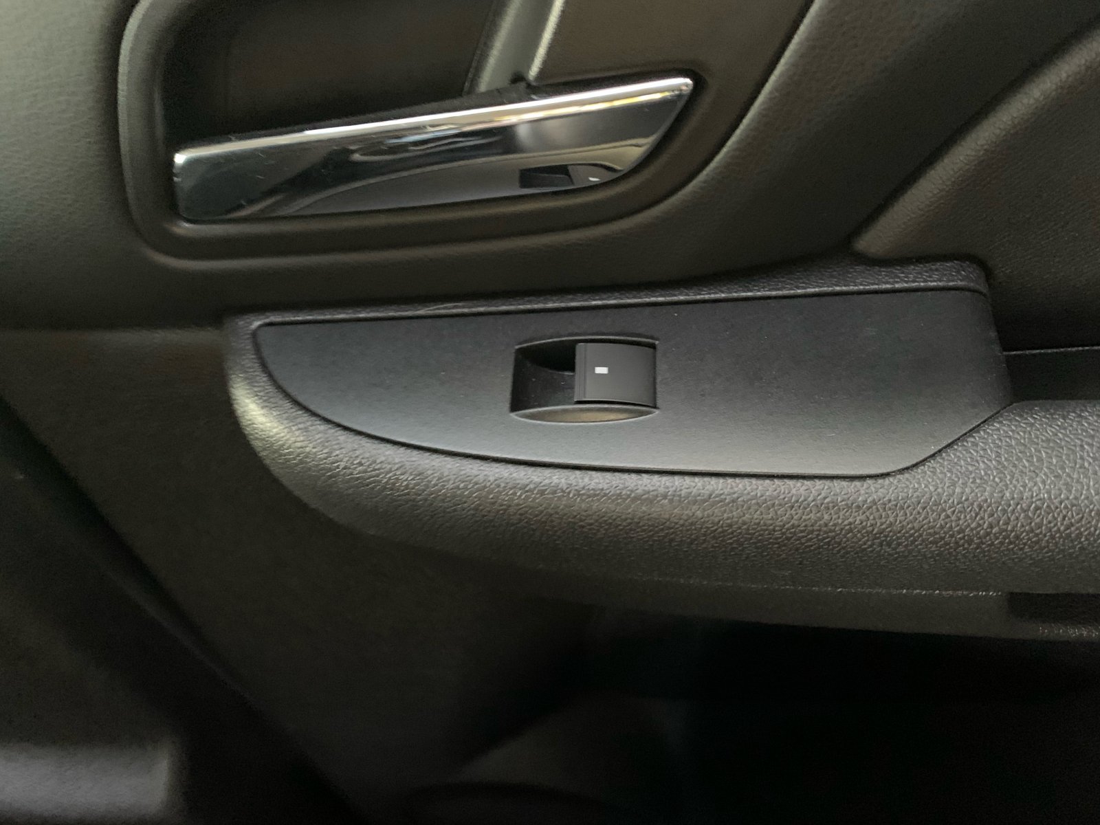

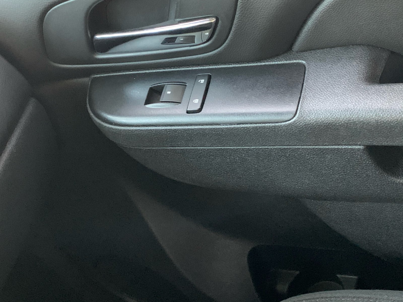

Did all the aluminum panels on dash, around window switches, and stereo surround as well. Turned out pretty decent

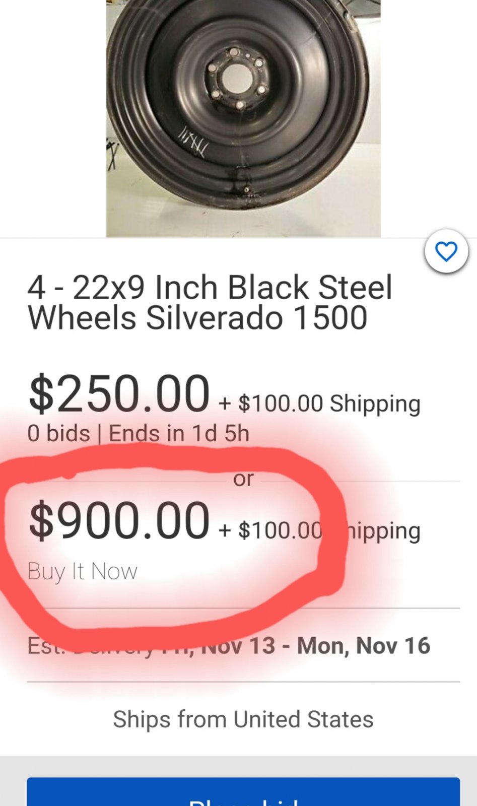

I’ve looked at them on and off. At $400 I might be tempted. I ended up with a second set of PPV wheels bought as singles for $65-75 each.
Did you buy them with center caps? Those are more expensive then the rims sometimes. PPV rims are the same as reg Silverado steel rims. Just need to drill and tap bolt holes for the PPV center caps.

That looks good. Any tricks to pulling them? I want to wrap mine. But I'm terrified of breaking them pulling them out. I'm kinda ham-handed when it comes to stuff like that.
I just used a super thin steel flat bar for the door switch panel. The stereo surround I did the same from the bottom edge. The dash trim, I just pull by hand from the left. I’ve had that one off a few times, like when I added the driver info switch. The vents will uncoil from the back as well, so you only have to deal with a “flat” panel.

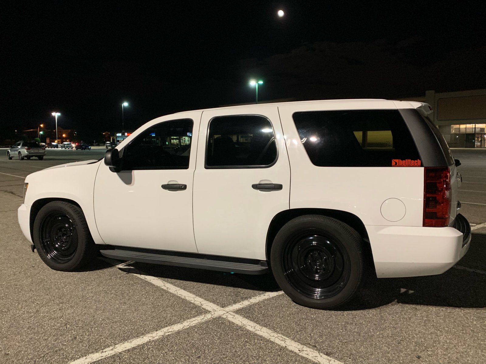

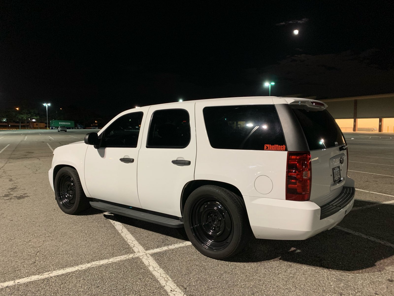

I bought my transit wheels from a guy in NY, that I found on a forum. I got them in March for $400+ 200 for the set of Michelin’s on them. Paid $300 through U-ship to get them to VA, when travel was being restricted. So I have 900 total in mine, but I’d drive up next time....and he said he DOES have other sets.

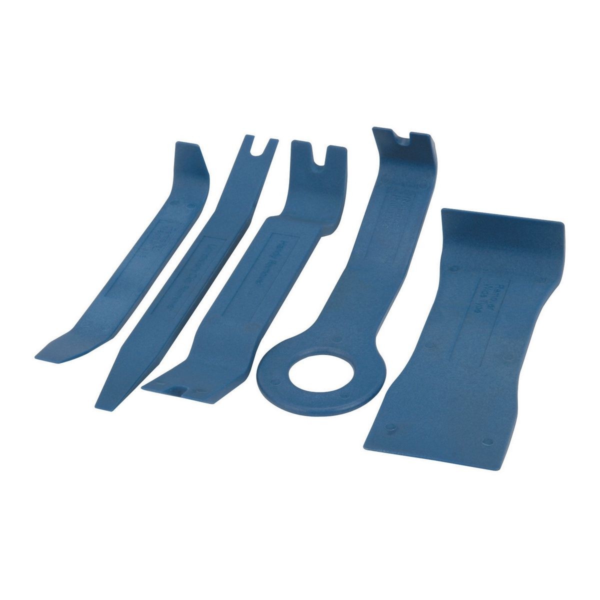

I use plastic trim tools. The one around the stereo can feel like you’re going to break it before the first couple clips pop loose, then just work your way around it. The plastic tools will keep you from scratching anything in case you slip. Harbor Freight has a set for less that $10.
