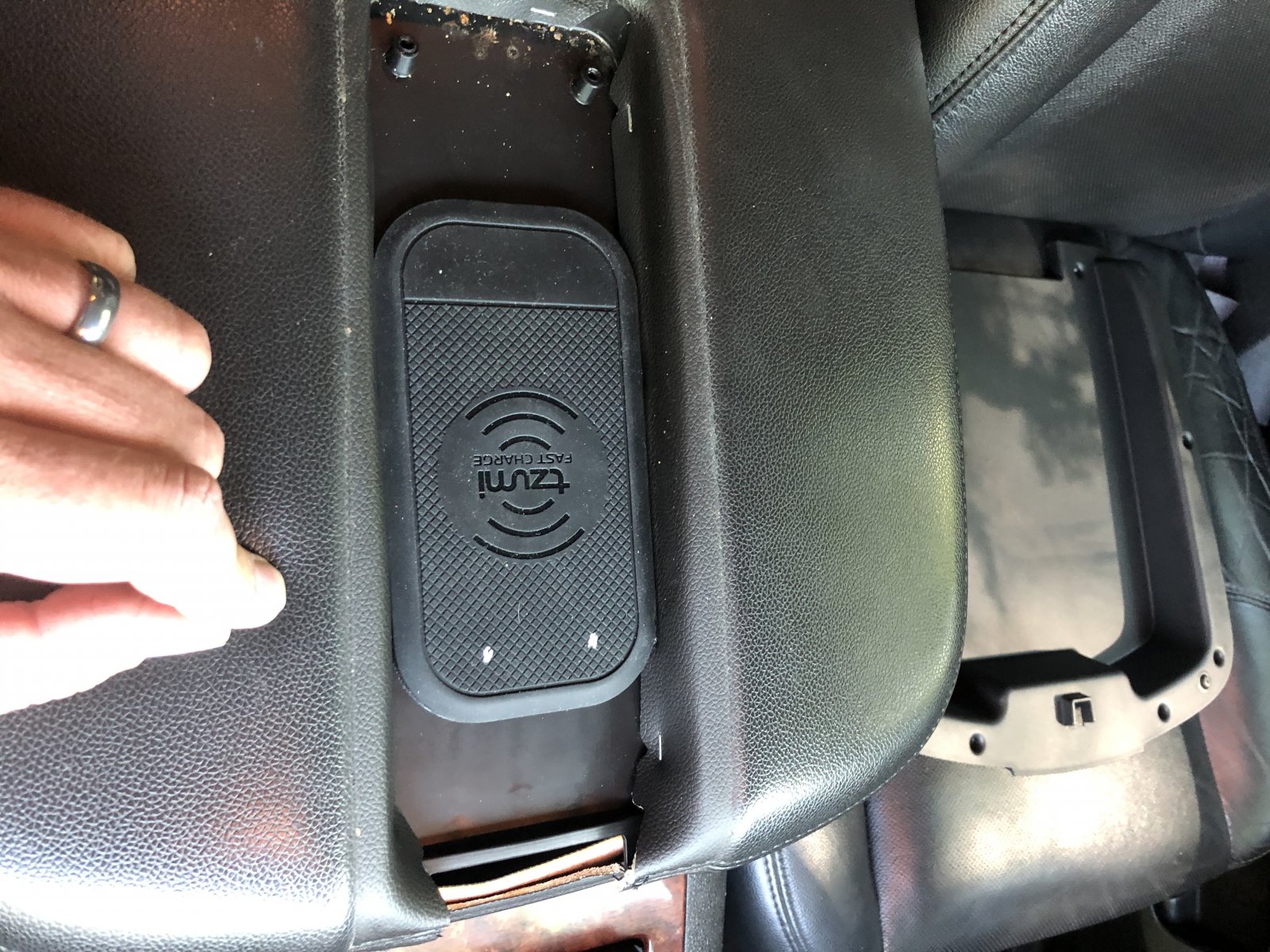

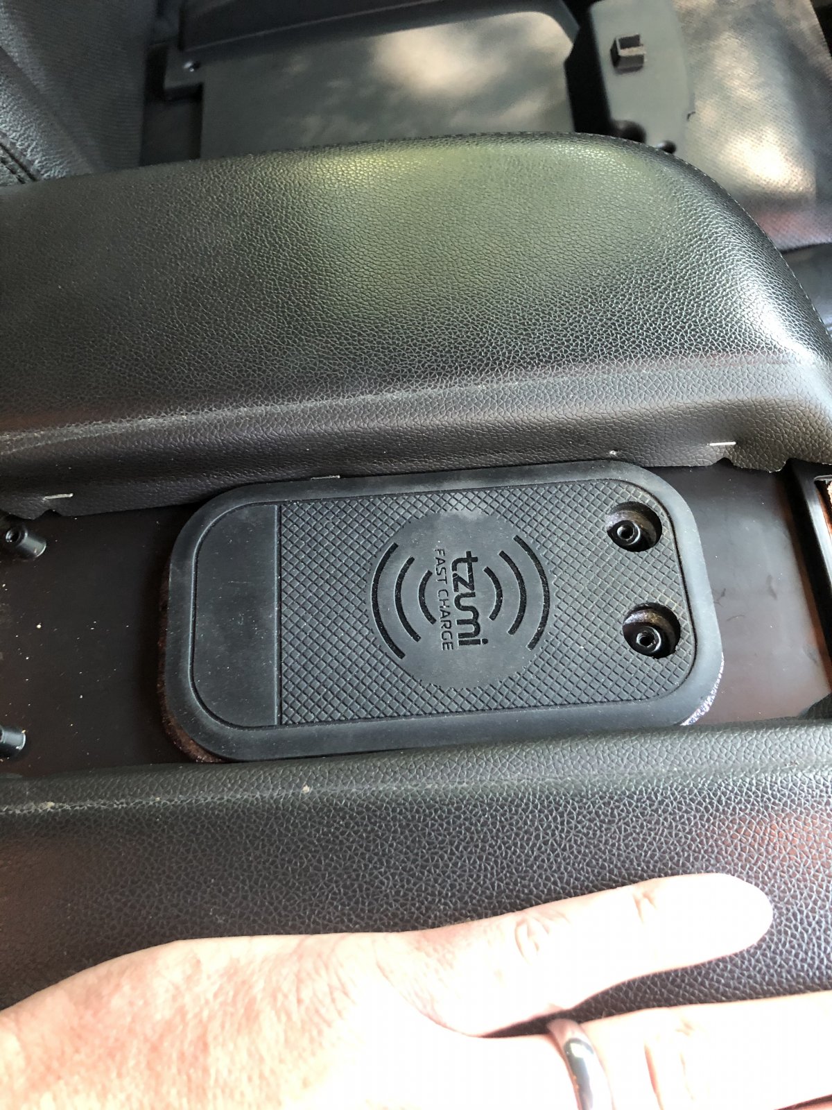

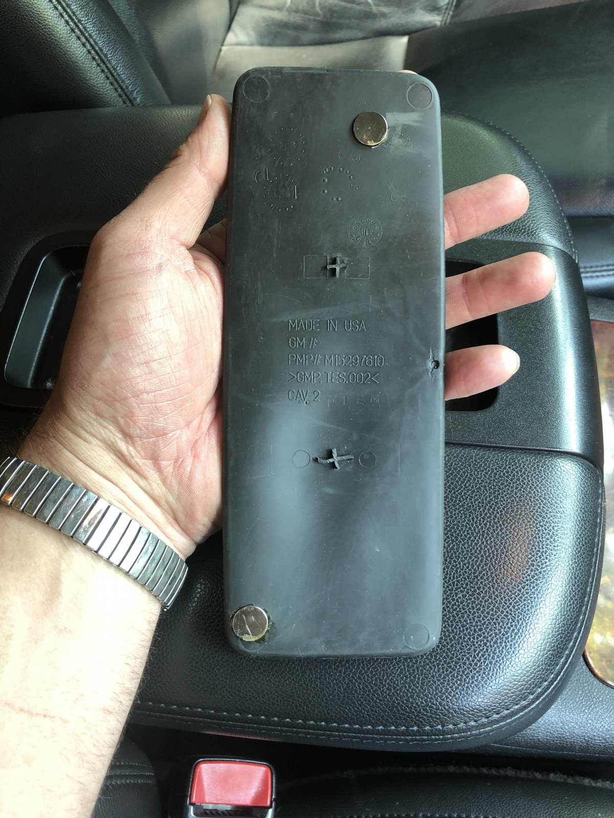

$7.00 wireless charging upgrade. Pretty slick.

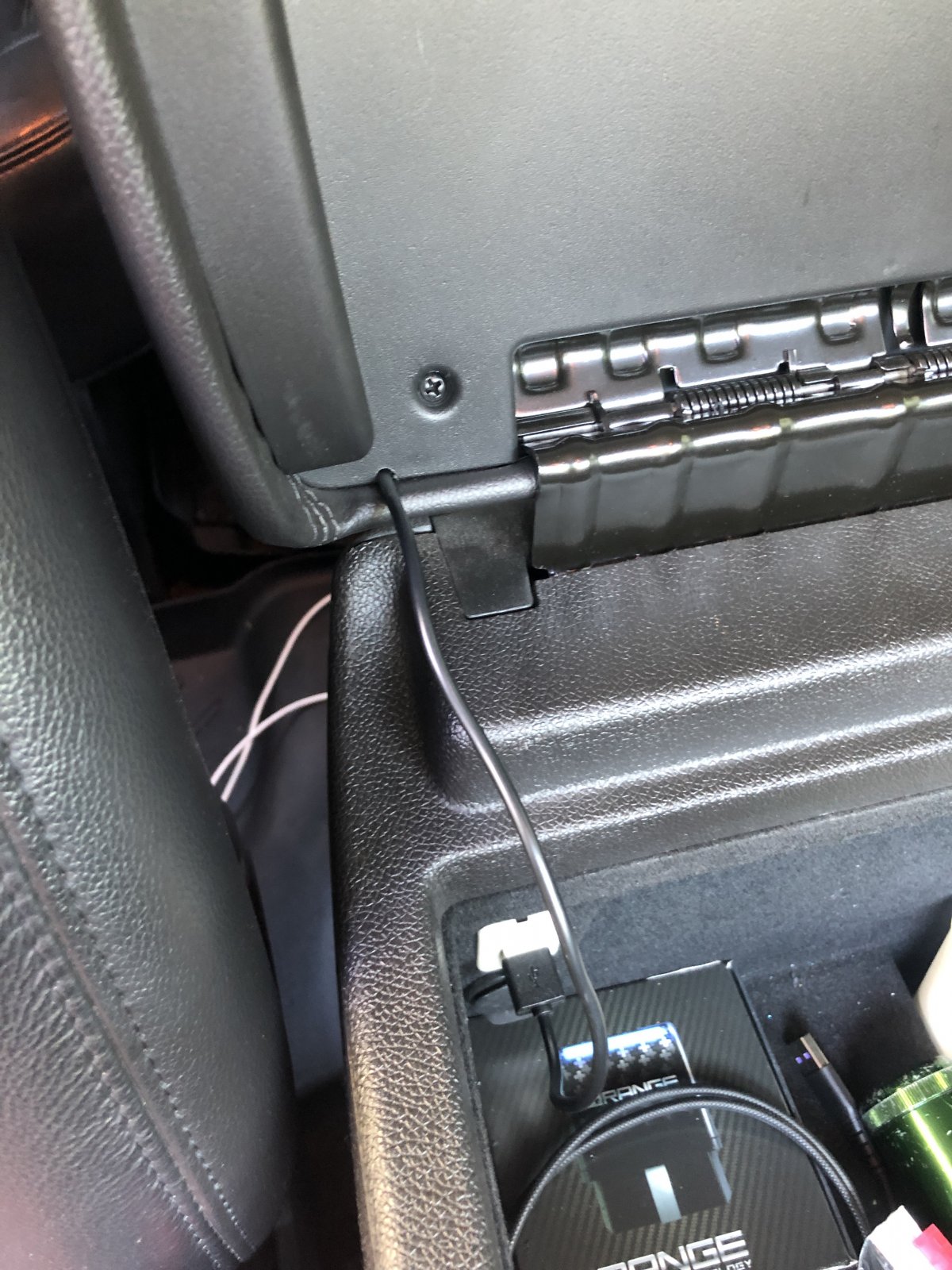

What is there, a power socket on the inside there??? :confused:

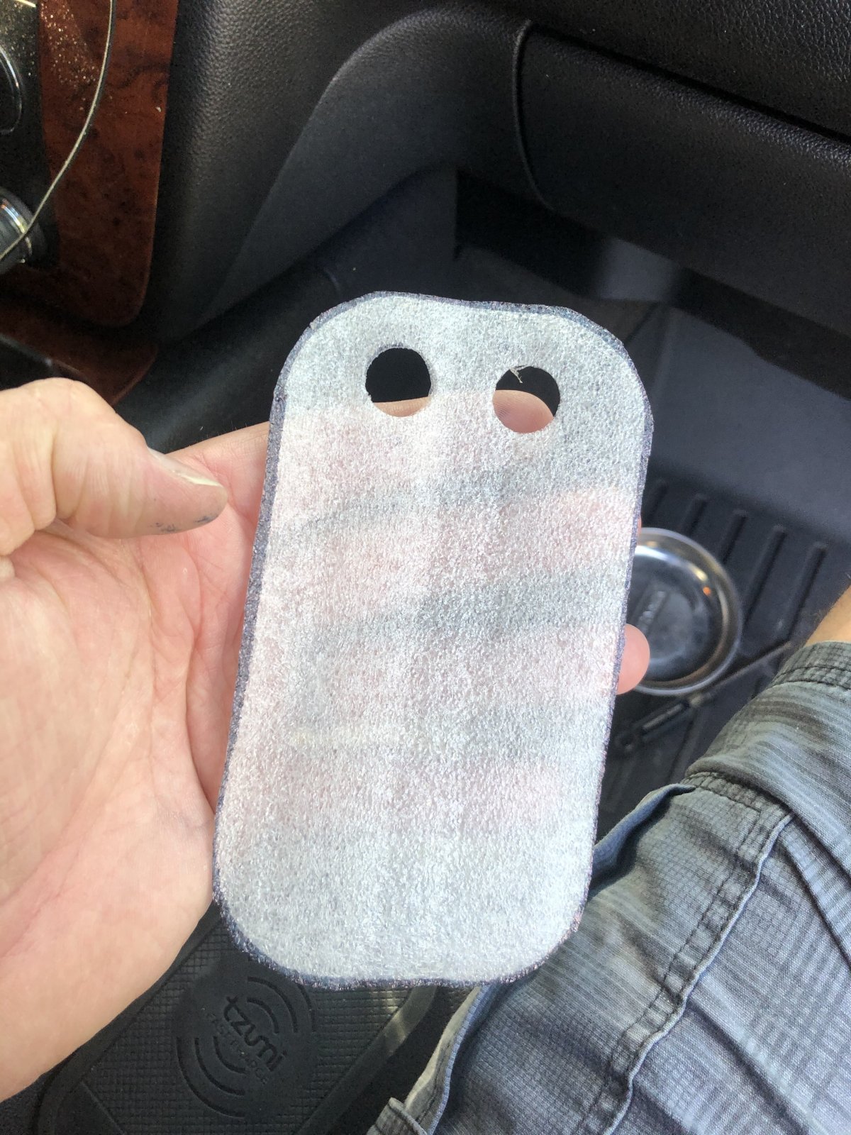

I had to make a little pad to hold the charger up tight to the tray so I used some closed cell packing sheet.
there is a usb port in there that connects to the head unit for loading and playing music. I have a memory stick full of songs but navigating the list in the head unit is awkward. I primarily stream pandora through bluetooth using the aux port so it was cleaner to grab my power there. There is a cig socket right under it too if needed but the usb is controlled by key on.
That's pretty sweet, did you do a work thread on that?

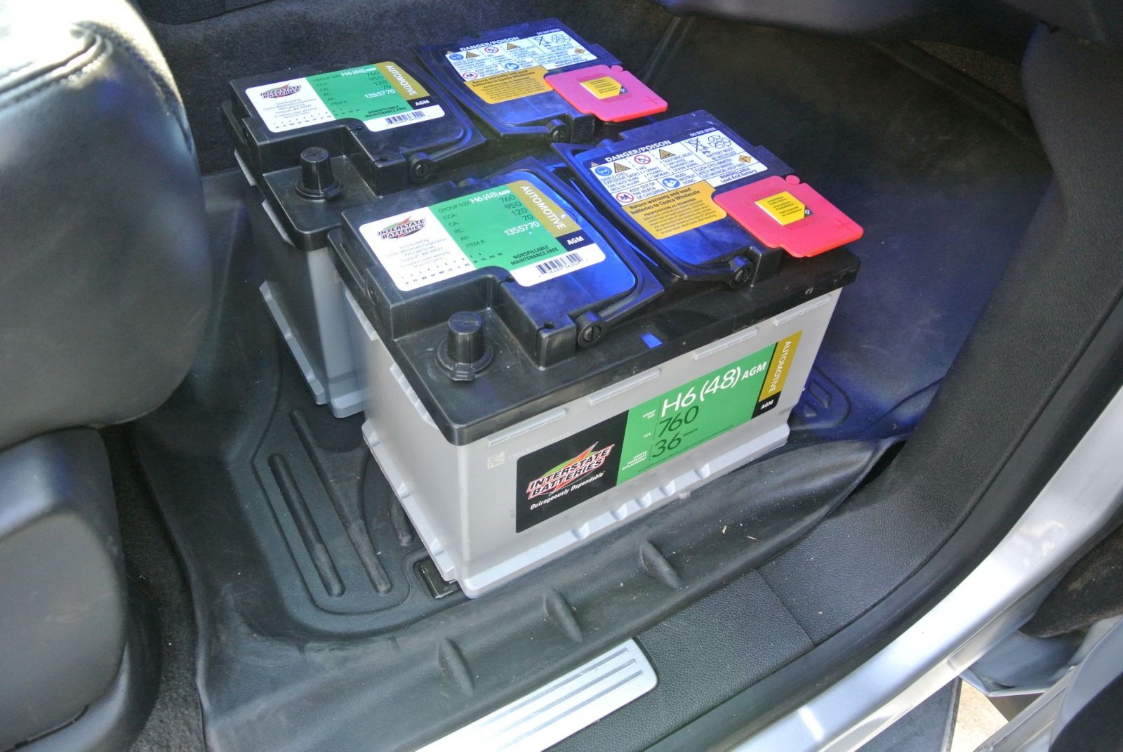

Haven't done it yet but I picked up 2 new Interstate AGM's, pretty sure one of the odyssey is done for and the other is a year newer so going to start fresh with 2 of the same age, going to get a new ground cable made up tomorrow so both battery's are connected to the rvc just because.....
