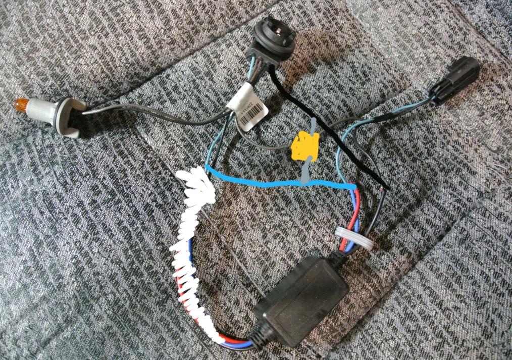

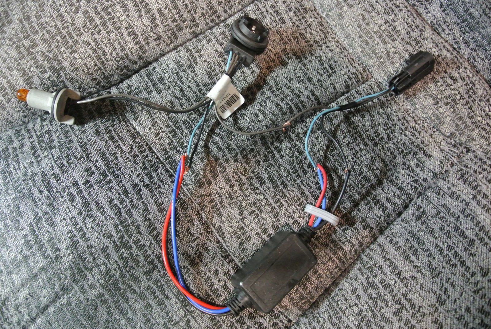

it starts out as 3 wires blinker/marker/ground, then it goes into the bulb connector and 2 more wires exit to the corner marker for a total of 5
if I connect just the blinker portion it works, until the marker lights are turned on
if i connect the marker and blinker it works until the marker lights turn on
kind of weird
View attachment 244066 View attachment 244067 View attachment 244068
I think your problem is the way you have the "resistor" you are using wired.

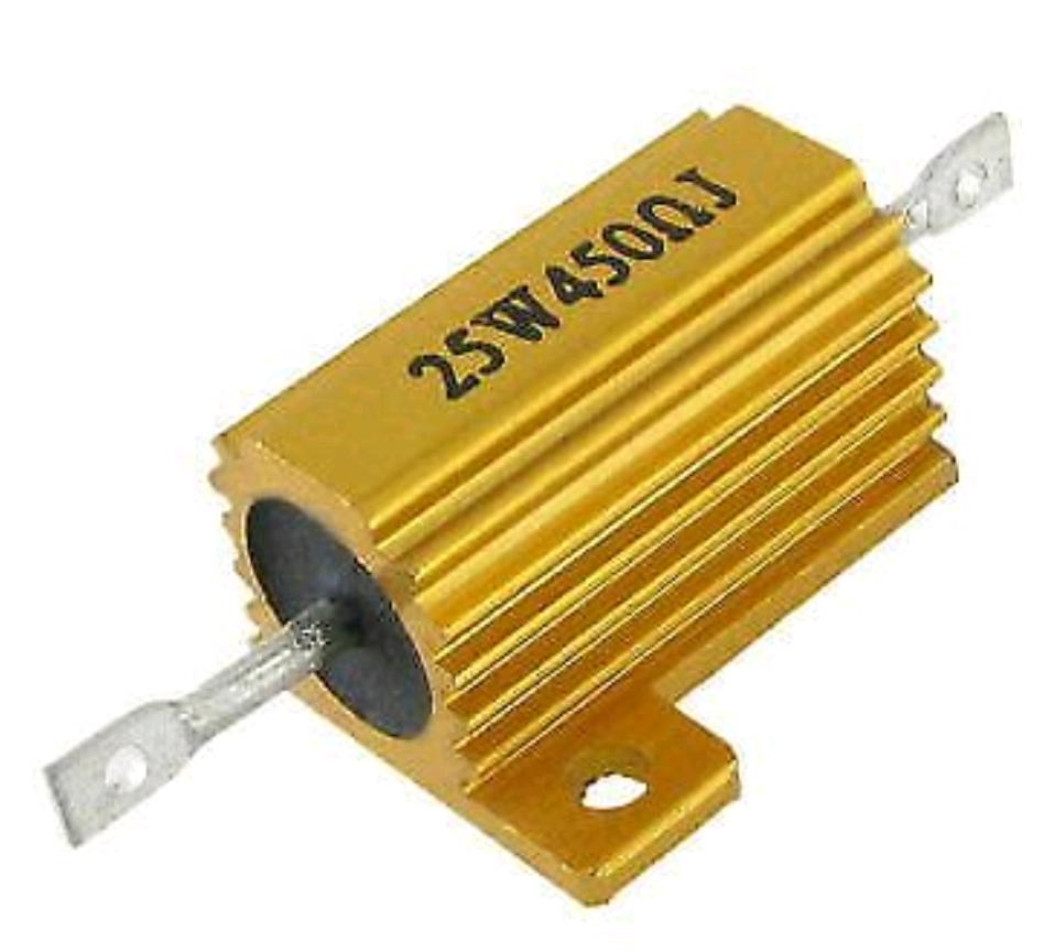

I used something like these...
And you would hook 1 end to the positive turn signal lead and the other side to ground.
Your "resistor harness" has 3 wires... I can only assume that 1 is ground, 1 is parking +, and 1 is turn signal +... you have the parking + and turn signal + hooked together.
I would disconnect those and only try it with one hooked up at a time.
The way its hooked up in your picture you have 12 v going through the 194 side marker bulb and feeding back into the ground side of the resistor harness which defeats the purpose. Hook the black ground wire from the resistor harness straight to ground.
My guess would be that the red wire is probably the turn signal (resistor) side of that harness, but I'm not sure.

it was originally a plug-n-play harness, it works-when just the blinker is on, it also work with just the 1 red or 1 blue wire, I only had them both connected because I was trying different combinations of wiring to try and get it to work when the marker lights were on. I will try what you are suggesting but I think my "fix" is going to be to just make the one corner light a marker light and have the bigger bulb be just a blinker and run the wires accordingly. It seems that the resistor just isn't strong enough when it is used for both the marker light and the blinker.
***maybe I can connect a relay so it cuts the marker light when the blinker is on? I have a couple micro relays that should work

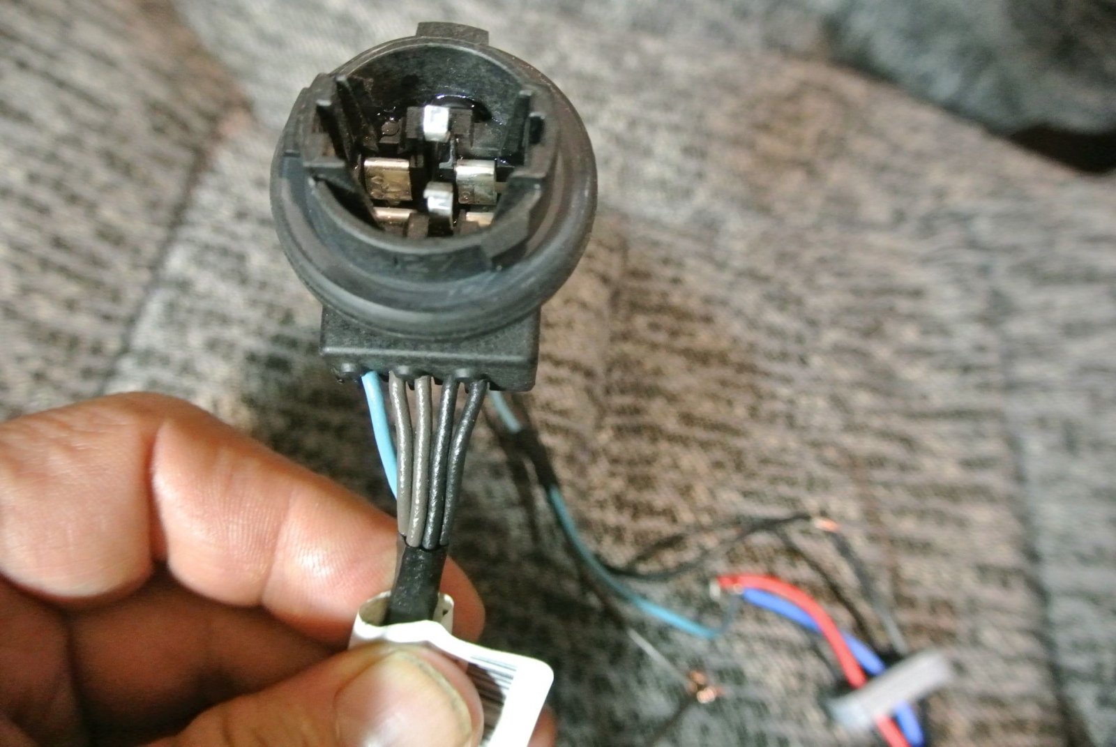

I feel like a crazy person, the resistors only work with there bulb sock and the bulb socket does not fit the housing, because the oem socket has a common ground or something it wont work so I ordered a different set.

I dislike these premade resistor harnesses because you don't know what else is inside the box besides the resistor... like diodes and such.
Your factory harness has...
1. Blue wire = turn signal +
2. Gray = running light +
3. Black = ground -
Your resistor harness is a pass through harness. In theory you should be able to connect the Red wire, on the resistor harness, to your trucks blue wire and the black wire, on the resistor harness, to the black wire on the truck harness... off of the same side of the resistor harness without passing through to the other side of the black box.
Do you have a DVO meter?
Can you test resistor for continuity on your resistor harness to verify which wires are hooked to the resistor internally?
My guess is black on either end of harness should read continuity.
Red to black should read resistance.
Blue to blue should read continuity.
Blue to black should read open.
In theory you should be able to hook it up like this...
I drew a gold resistor between the black and blue wires because the black box should act as that gold resistor when wired in this manner.
The small marker light shouldn't have any effect on the turn signal wire as they aren't connected together from the factory. It might blink with the turn signal if the parking lights power gets interrupted (turned off) while the turn signal light is illuminated.
I know on the older S-10s the marker light would flash in sync with the turn signal when the parking lights were off and it would flash opposite the turn signal when the marker lights were on but this was due to how they had it wired. It would ground itself through the turn signal filament in the dual filament bulb.
I wish I was there to look at it with you... I'm certain we could make it work.
