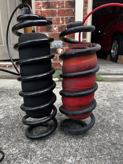

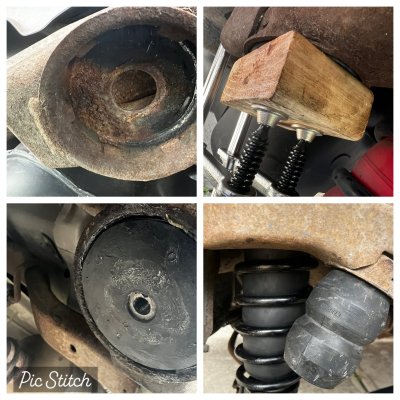

Wiped the dust of parts boxes taking up space in the garage.
Installed replacement Z71 rear springs with new air bladders. Old vs New.
Installed rear Timbren bump stops. Had to disassemble the bump stop and press them into the cups on the frame. The way Timbren suggests did not work for me.
Truck sits 1” taller in the rear with new springs. May settle in a bit with time?
Not a bad way to spend the morning..
