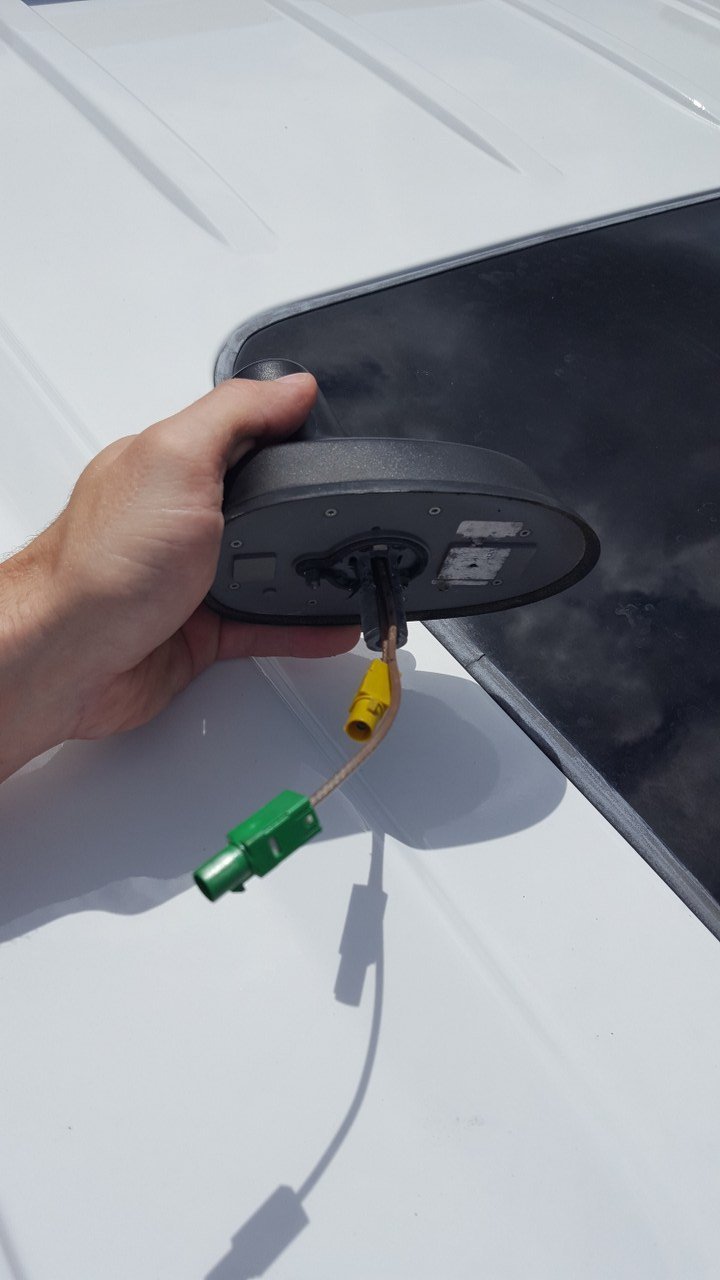

Just finished the XM and Onstar antenna delete.

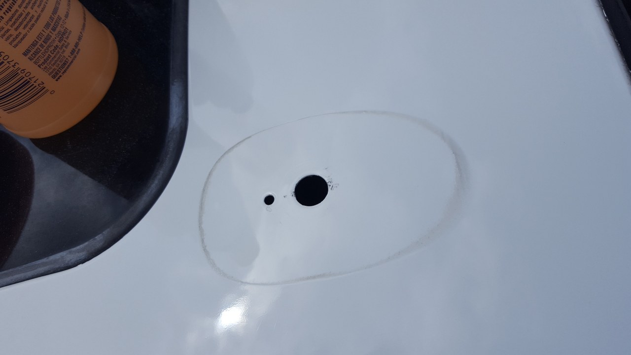

XM removed:

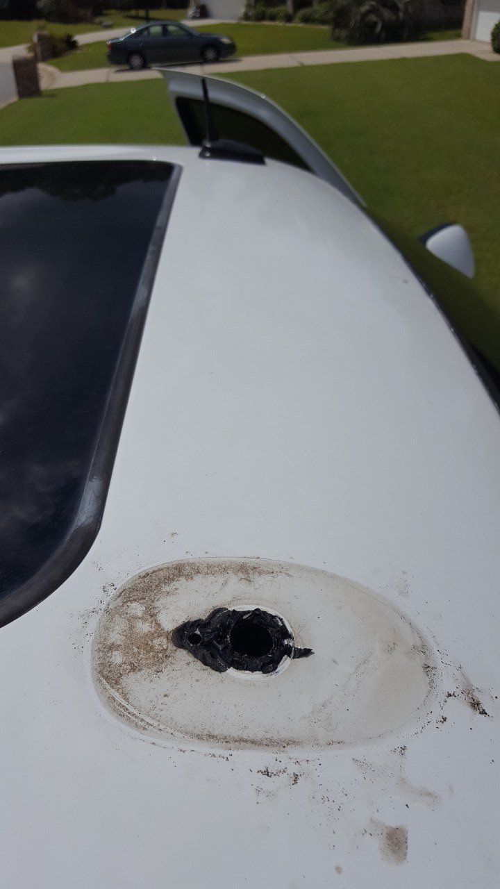

What was left behind:
After some APC and elbow grease:
And after some DA polisher action:
It's definitely not where I want it to be, but it's a start.

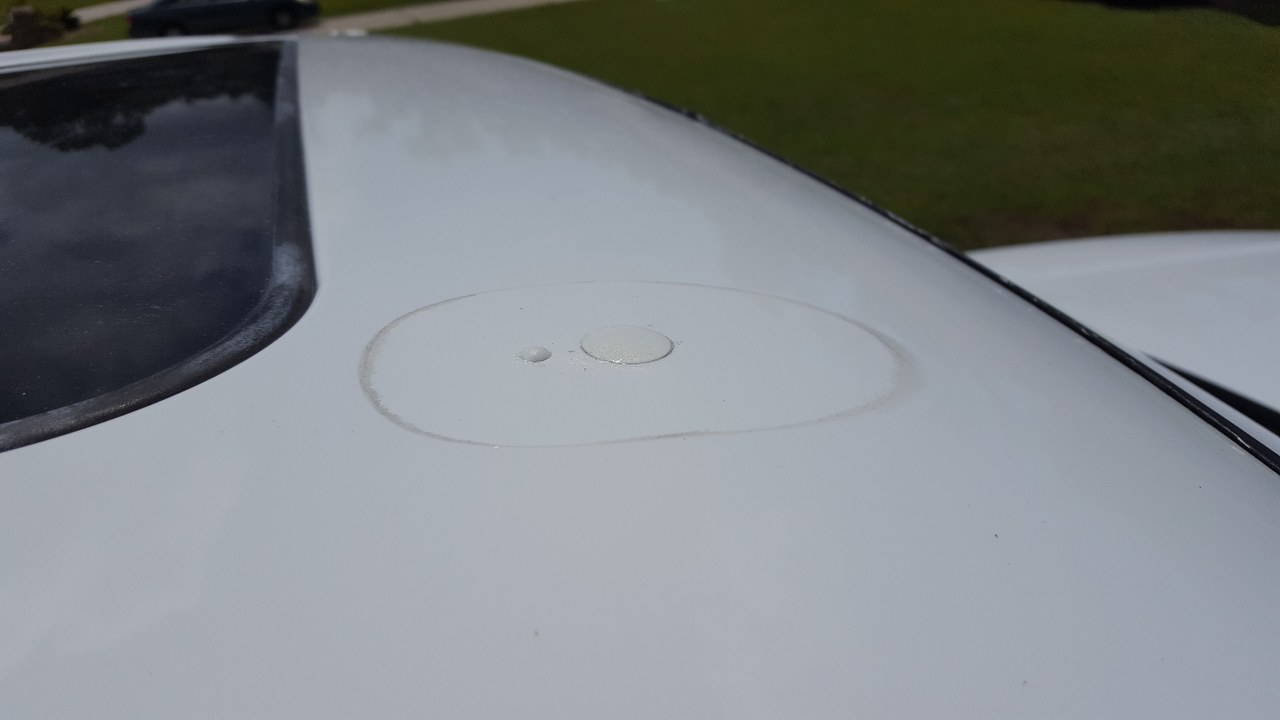

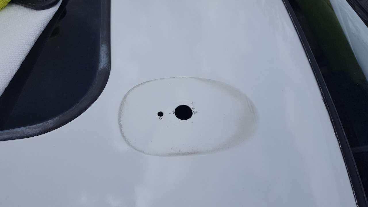

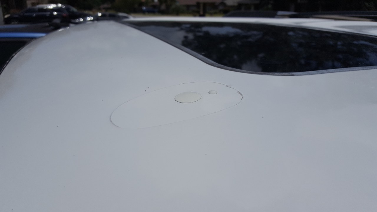

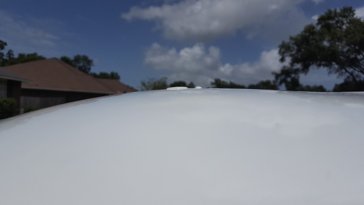

Plugged up. I think the Duplicolor Clear yellowed on me a bit, but at least if I want to redo it, the plugs themselves were only like $4 total and sealed with silicone adhesive sealant.
The other side finished. This side came out a bit better:
The profile view:
Much better!
I still need to clean up the excess silicone once it cures, and maybe hit the area with the DA again.

What's the process to do this? Does the headliner have to come down to get these antenna's out?
Yeah, it does. Remove the 4 screws from the sunvisors, 1 screw from the upper control pod assembly and pop it down, pop off the A-pillar plastic, remove rubber around the sunroof, and pop out the clips from the passenger side handle. Headliner should drop down enough to get a wrench in there. It was a 10mm for the Onstar on the drivers side, and a 22mm for the XM.
