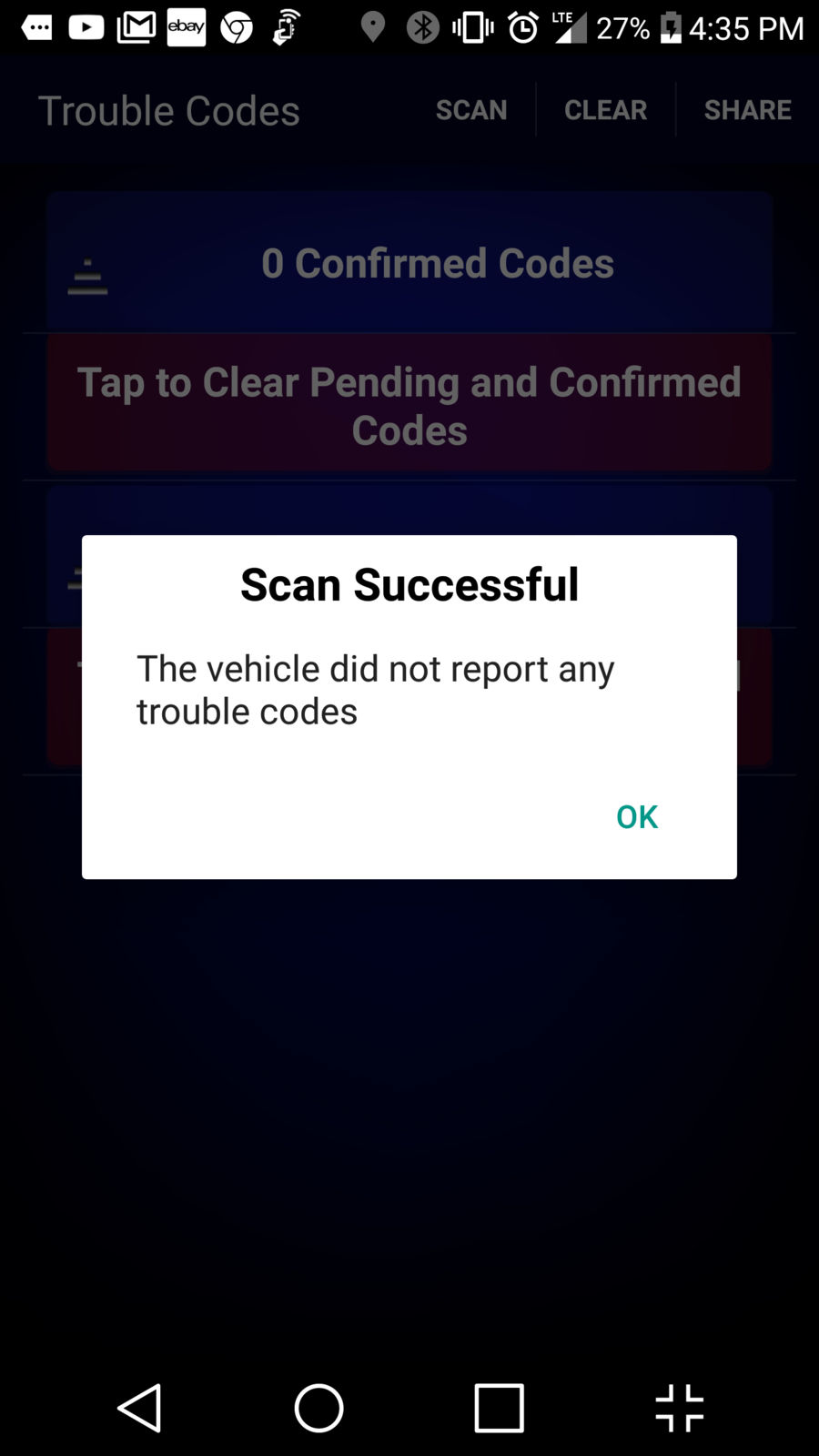

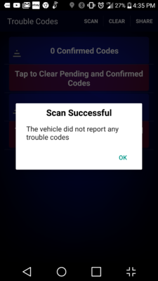

Hvac codes are gone! Finally was patient enough to let the thing do its ac relearn completely.
Also fixed the airbags. Super easy fix.

Disconnected battery for 15 mins. Reconnected battery. Turned vehicle on and the hvac had set itself to 74 auto (i have the digital hvac) left it alone idling for 10 minutes.

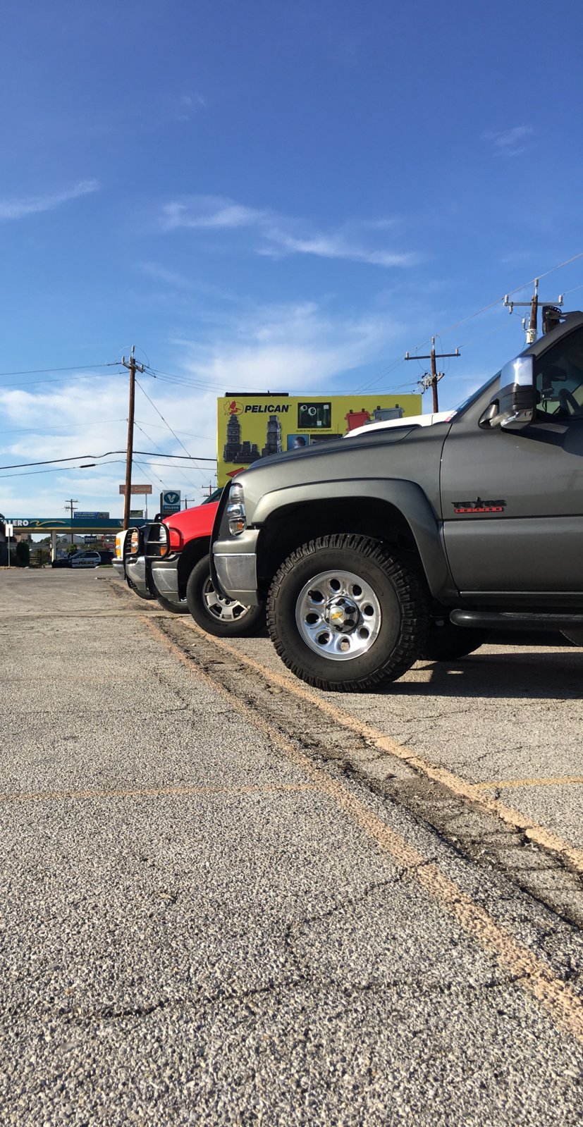

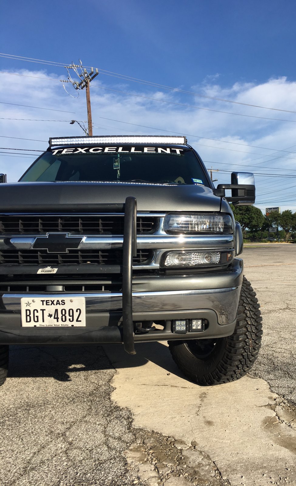

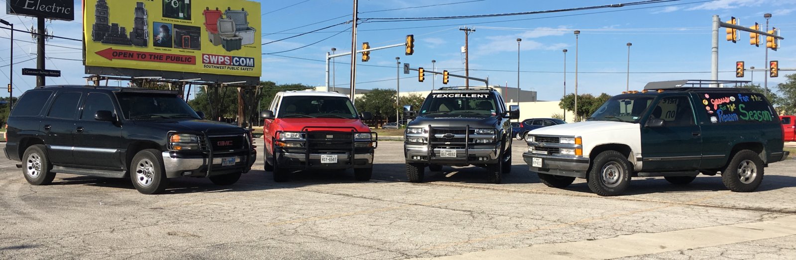

Took some pics of the fleet today, along with a guy who we met while setting everything up. Had a nice K2 Silverado.

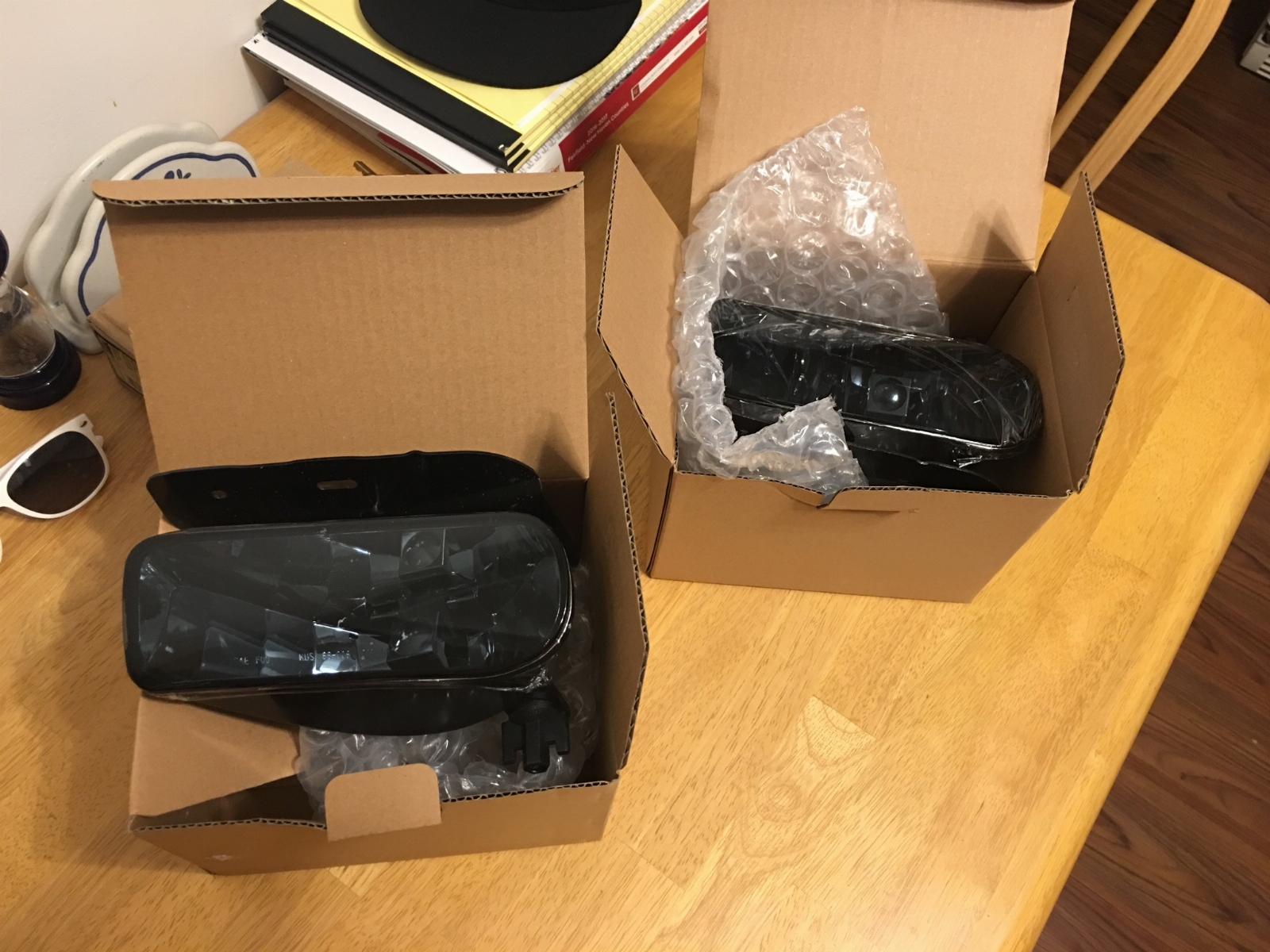

The smoked fog lights for the Escalade came today hopefully putting them on tomorrow
I actually bought a new set of those off cl awhile ago. They we're nice, until one lens popped off while I was driving! Make sure the lenses stay on.
95escahoe
Aug 2, 2010
5,162
4,466
Seems to be a pretty common issue with these lights factory or not, I have had a crystal clear set on there since last August hopefully these last that long and then some
33,203
51,461
Maybe smear some clear silicone around the edges as an extra adhesive. Can't hurt.
