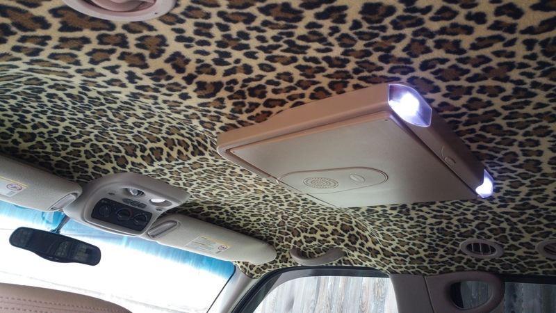

I also did my headliner a while back, just never posted a picture. I know a lot on here won't like it, but I do.

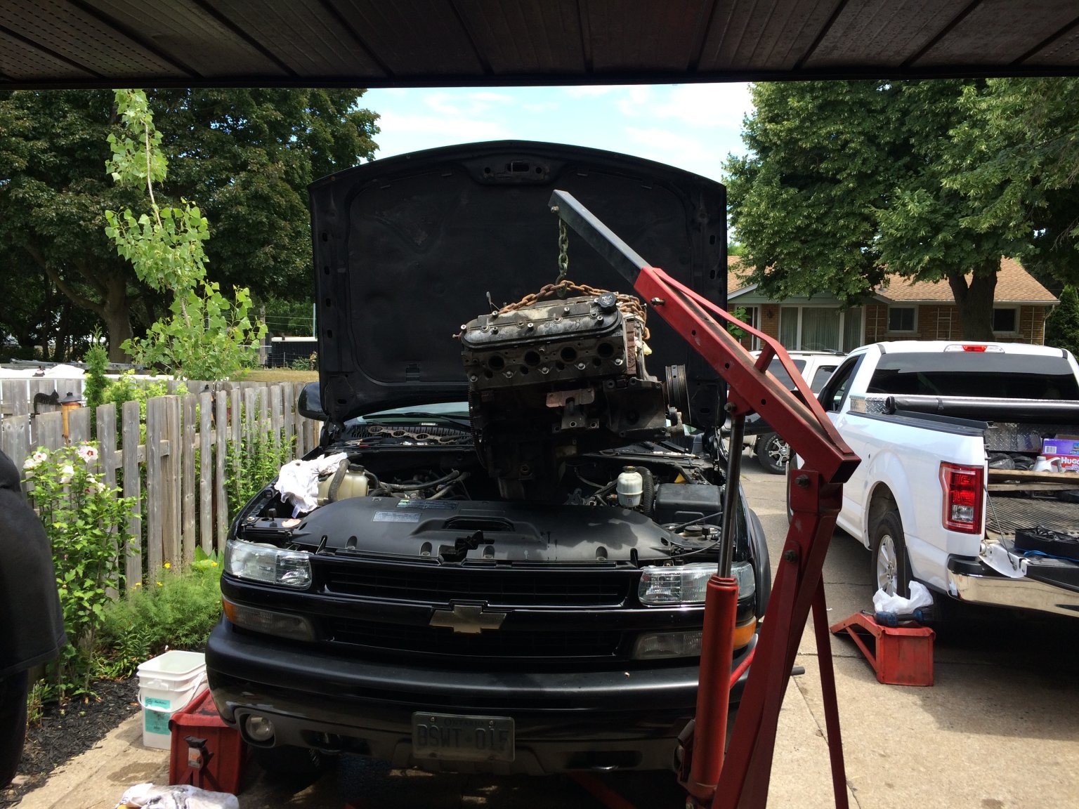

Got the tranny out and decided to do the 6.0 also. Was going to wait a few more weeks for that but don't want to take the same stuff off twice.
Does anyone know if I for sure have to do the vats relearn ? I have read most people don't have that problem but just want to make sure.
So progress report is tranny out and top end of motor is disassembled. Tomorrow water pump and she should be comming out. Any luck the 6.0 in and mostly put back together.

Vats has nothing to do with an engine swap if thats what youre asking.

6litre is in and bottom buttoned up. AC is on and power steering bracket in on. During the week I will pick away at the rest. Still have to put the tranny in.
So far every sensor is the same. I used the 5.3 oil pressure sensor cause it was shorter. The other sensors on the block I kept. The 5.3 intake and exhaust will be going back on with all sensors attached. Nothing out of the norm so far.
