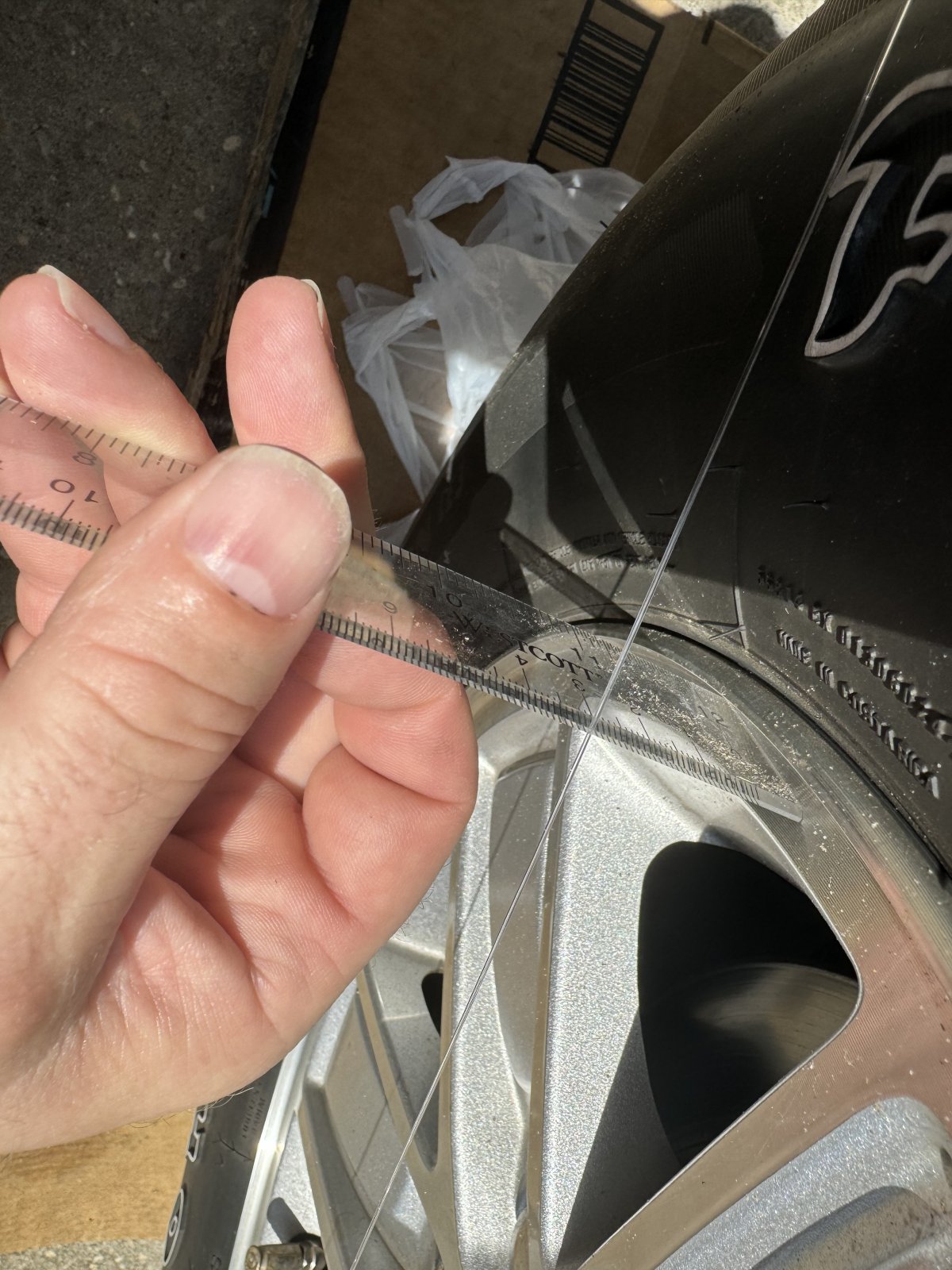

After 2 fails apiece at the GMC dealer and Chevy dealer and them first claiming it wa good to go, then blaming my new tires (I also swapped those around too!) I decided to do the ole fishing line, jackstands and a ruler alignment. What’d ya know, now the steering wheel isn’t crooked and it doesn’t drift left anymore. Ridiculous. Left front wheel was toed out. Assume the camber/caster were good enough- I mean they were green on the print outs
