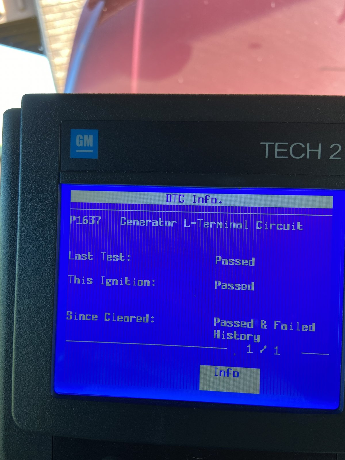

Today, driving one of the 4 trips back and forth to school for the kiddo, I noticed my charger light come on… uh oh..
About 6 months ago, when I did my efan conversion, I also did the alternator, serpentine belt, a/c Idler, and belt, pretty much everything but the water pump up front.. the battery however is dated 2017.. so rolled to the auto parts store, the battery tested bad, and $300 or so later, I left with a new Optima Red Top, to replace the old one ..
Replaced.. and still not charging.. dammit..
Tested the voltage from the alternator stud while running, and measured 11.58v. (Thanks for the suggestion @Fless!) so my 6 month old refurbished AC Delco was already shot.. contacted Summit, who I ordered from, and it’s on back order (of course).. so for now, I have a cheapie that’s getting the job done. I’ll hang onto it for the next time. Sheesh.
Back in business… and look at those damn miles creeping up..! I rolled 226k this morning..

I would have thought they might pick up on a weak or dead alternator during their testing. Don't those test routines look at both the performance and function of the battery and alternator when those guys do these tests? I thought it was part of the fool-proof step by step process guided by prompts on the tool.
Even though it was about 5 years old, I am wondering how bad that battery really was. On the up side, you won't have to worry about the battery for a while...

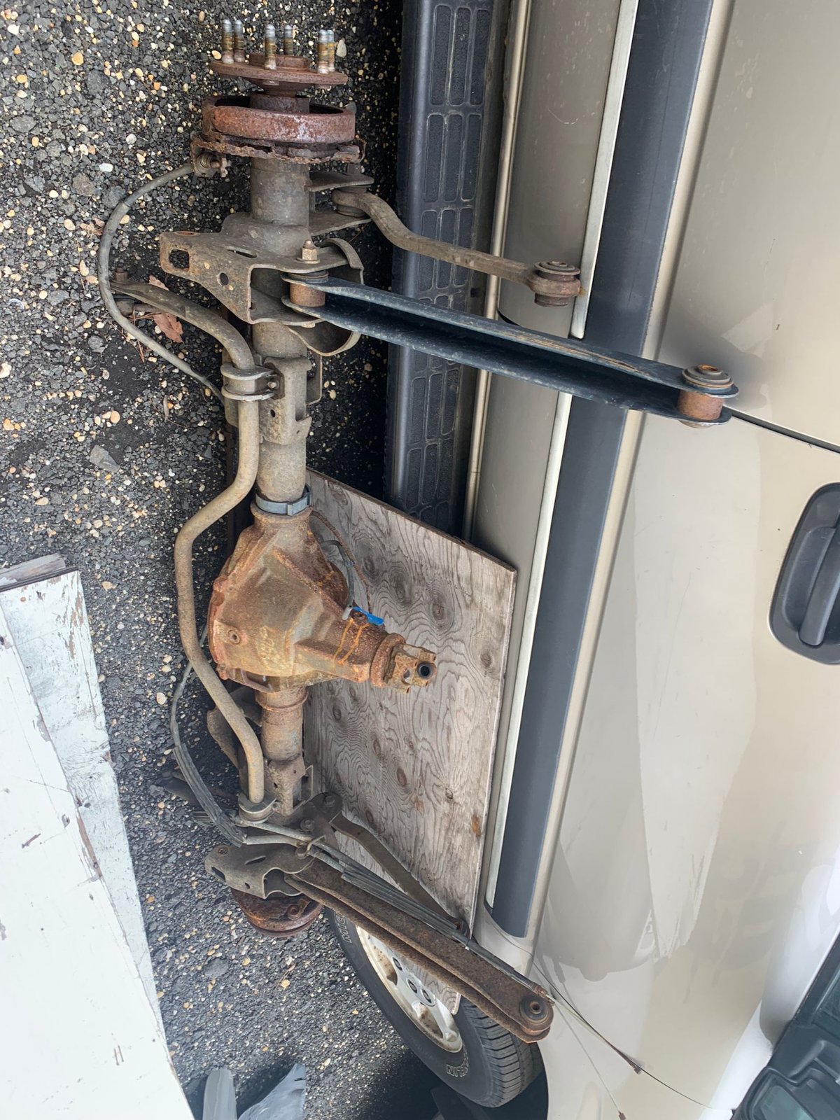

Possibly found another rear, supposedly a GT4. Is there a way to bypass if it has the JL4 option--which my truck doesn't. 4 hundo.
Sometimes a bad battery will have real low internal resistance and that will cook the alternator. So maybe the battery took out the alternator? Only good thing is that you still have the conventional charging system.
