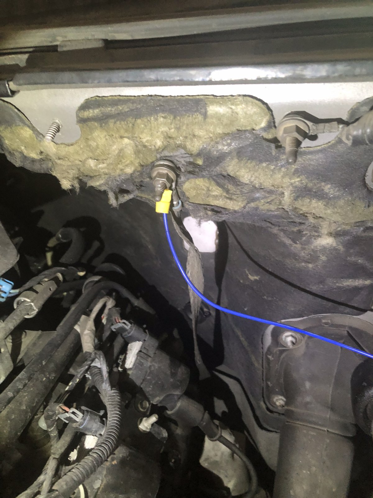

Hey Bud, don’t be surprised if the new dash switch doesn’t work. My 05 Tahoe had same issue 1 yr ago. I replaced switch, all good, until recently. Watched YouTube video. Someone posted lengthy analysis. His solve worked for me.
I found the ‘4 wire’ harness attached to plastic inner fender
on drivers side. GMC notorious for bad grounds. I found the solid black wire leading from this harness, spliced my own (blue) wire to this solid black wire, and ran it to the firewall. Pics attached.
****! Problem fixed. Hope this helps.
