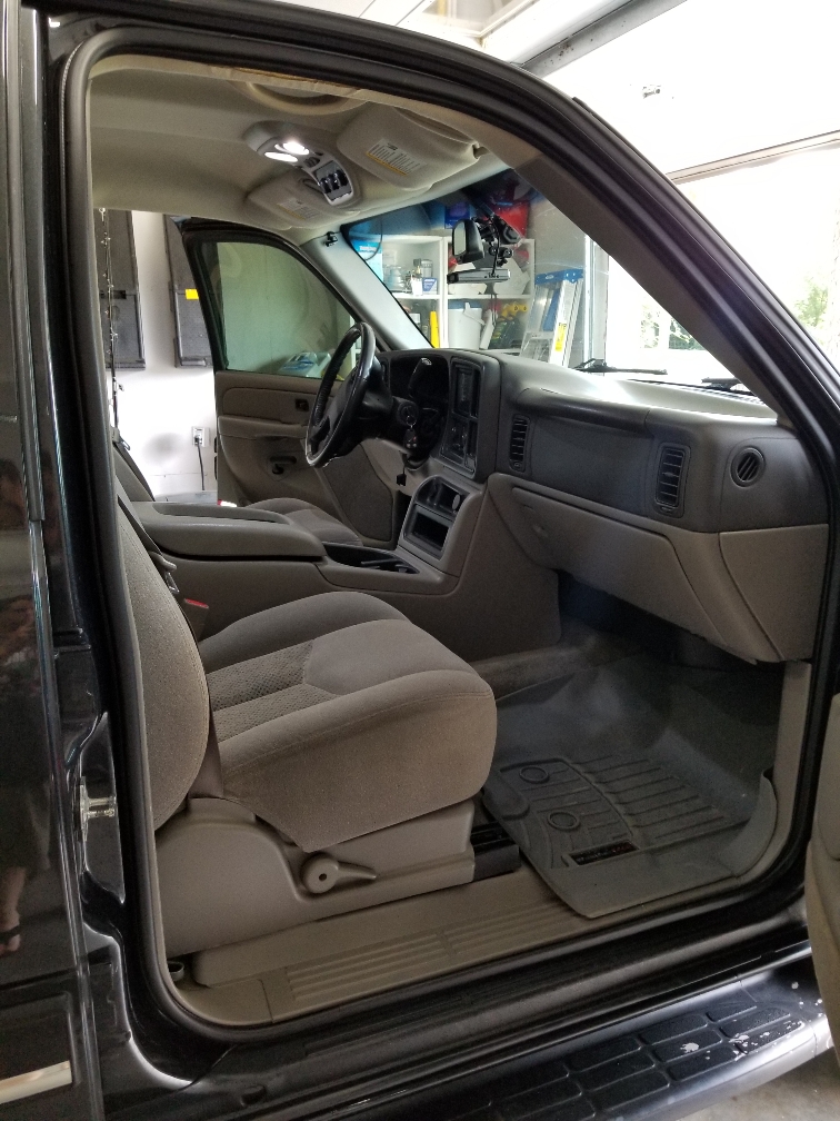

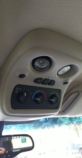

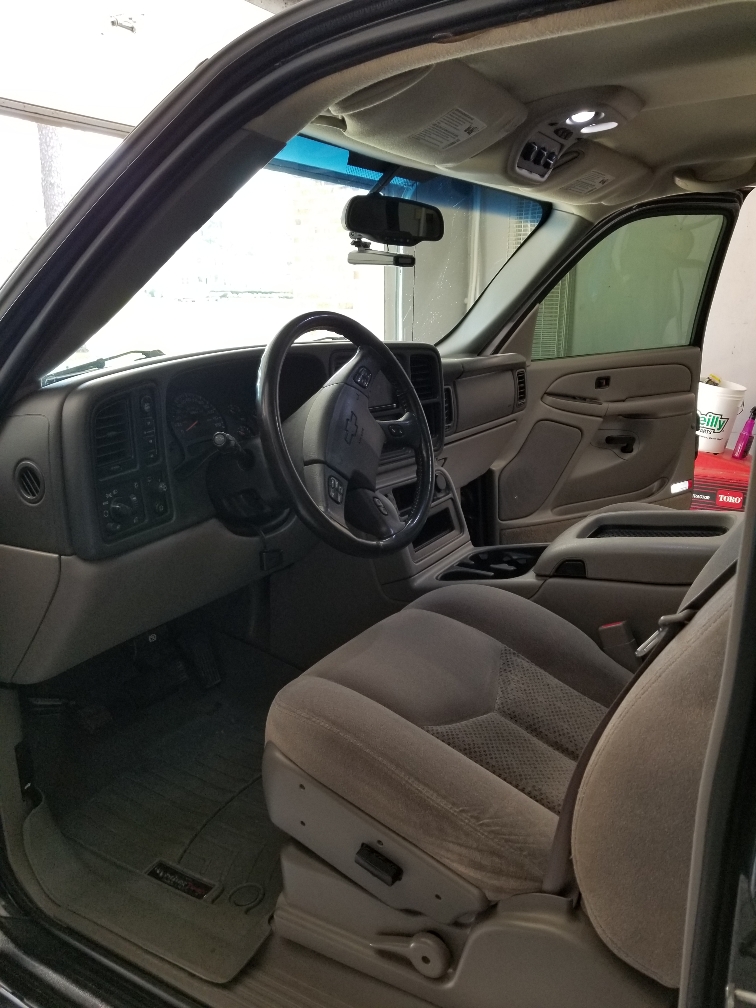

Scored some good stuff at the junkyard on Friday. Got a full console (I had a jump seat) and homelink!

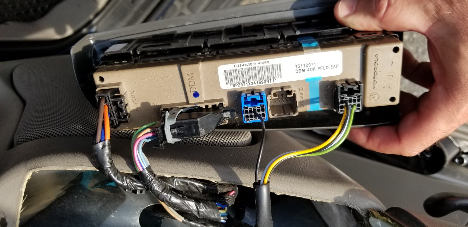

Also got a DDM with power fold so that I can actually use the power fold on these mirrors but it doesn't work properly. Unlock and pass window dont work. Can these switches be taken apart and cleaned?

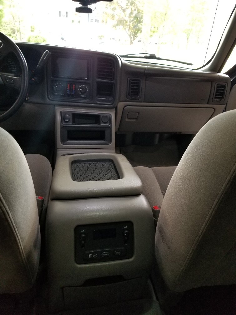

Lookin good, much better than a jump seat. They make a cubby to replace that rear “entertainment” system
Oh yeah? I was thinking about what I could use that space for. Do you have a link for it?
It’s a very rare piece. Found mine at the salvage yard out of a wrecked SSS

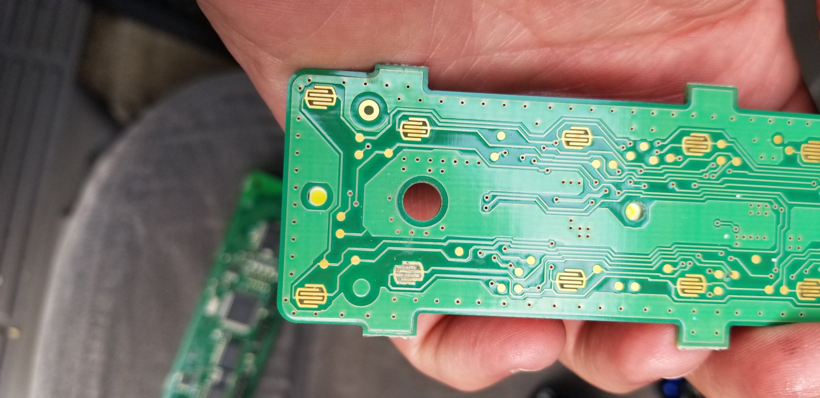

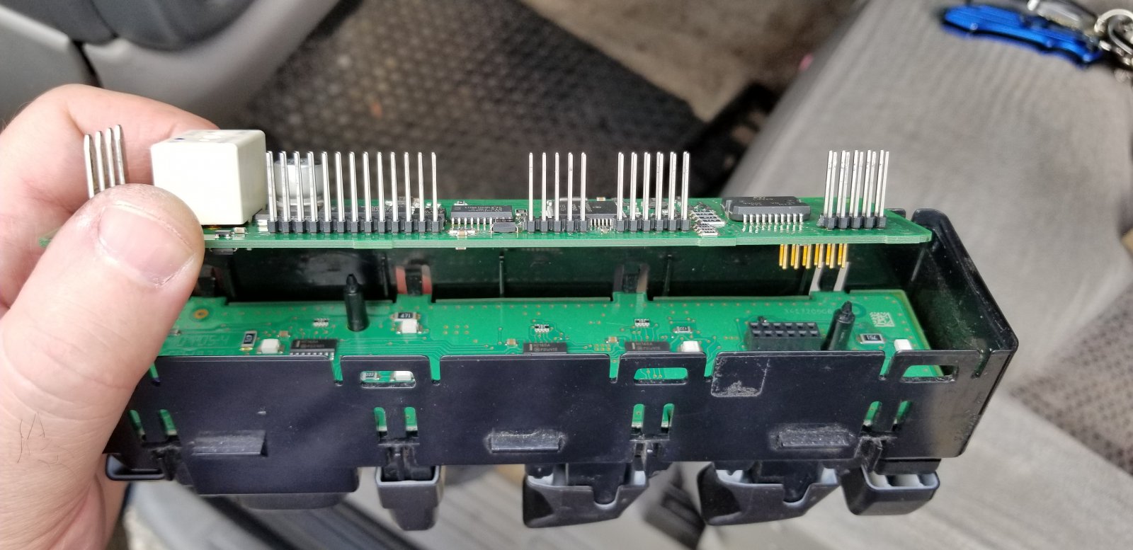

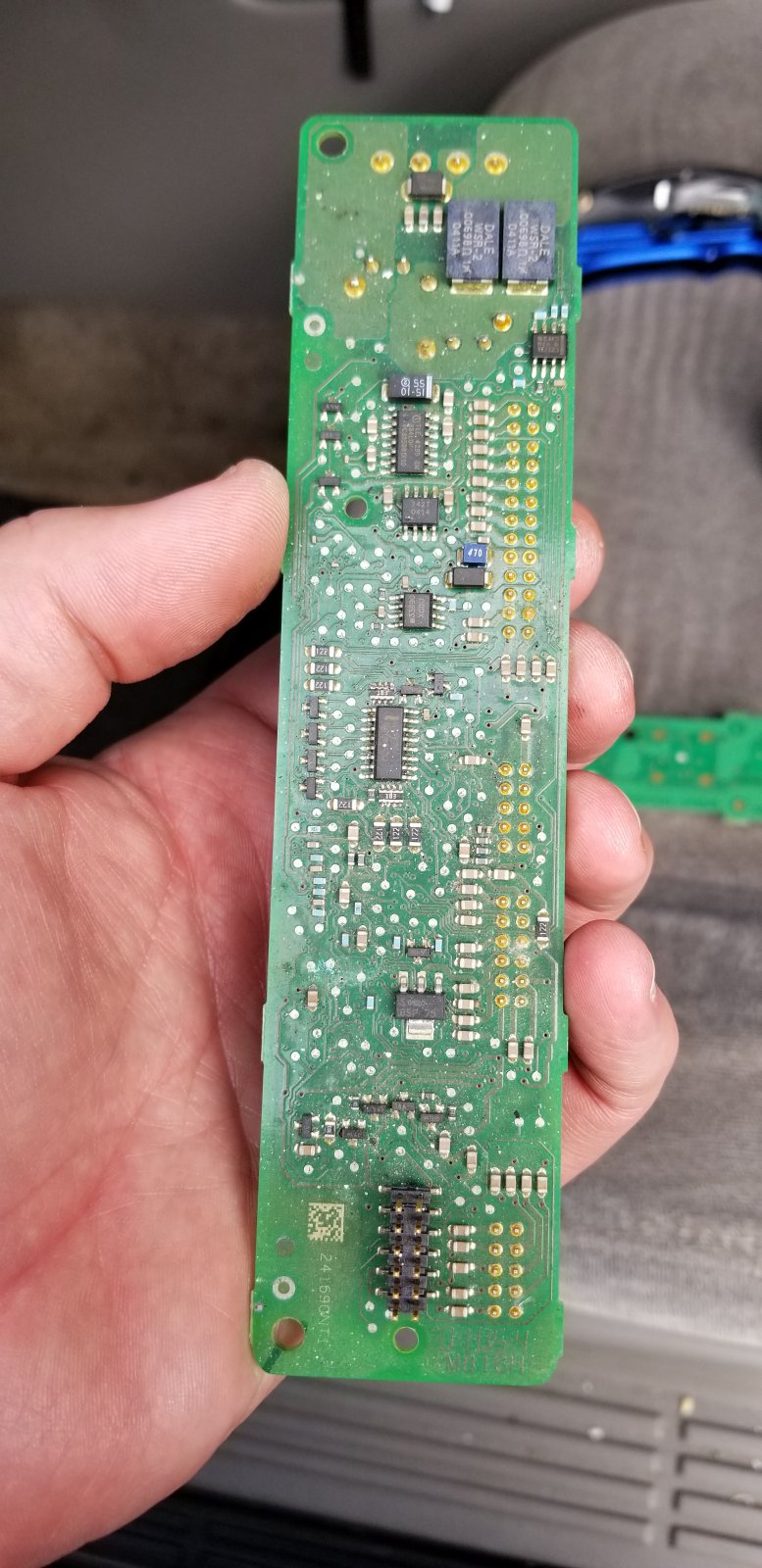

You can take the whole master switch apart and clean the contacts.
Worked for me. If you look close you can see the 1 contact that I cleaned that was giving me trouble. I just cleaned off the corrosion.
That cubby is no longer made. I did the same mod as you. Had a spare cubby but sold it to a fellow member. You can usually find them in the cc pickup trucks with the same center console. I think with the Bose option.

You can take the whole master switch apart and clean the contacts.View attachment 248321 View attachment 248322 View attachment 248323 View attachment 248324 View attachment 248325
Took it apart this morning and cleaned it up. All is good now! The passenger window and the unlock button did not work on the switch before cleaning.
