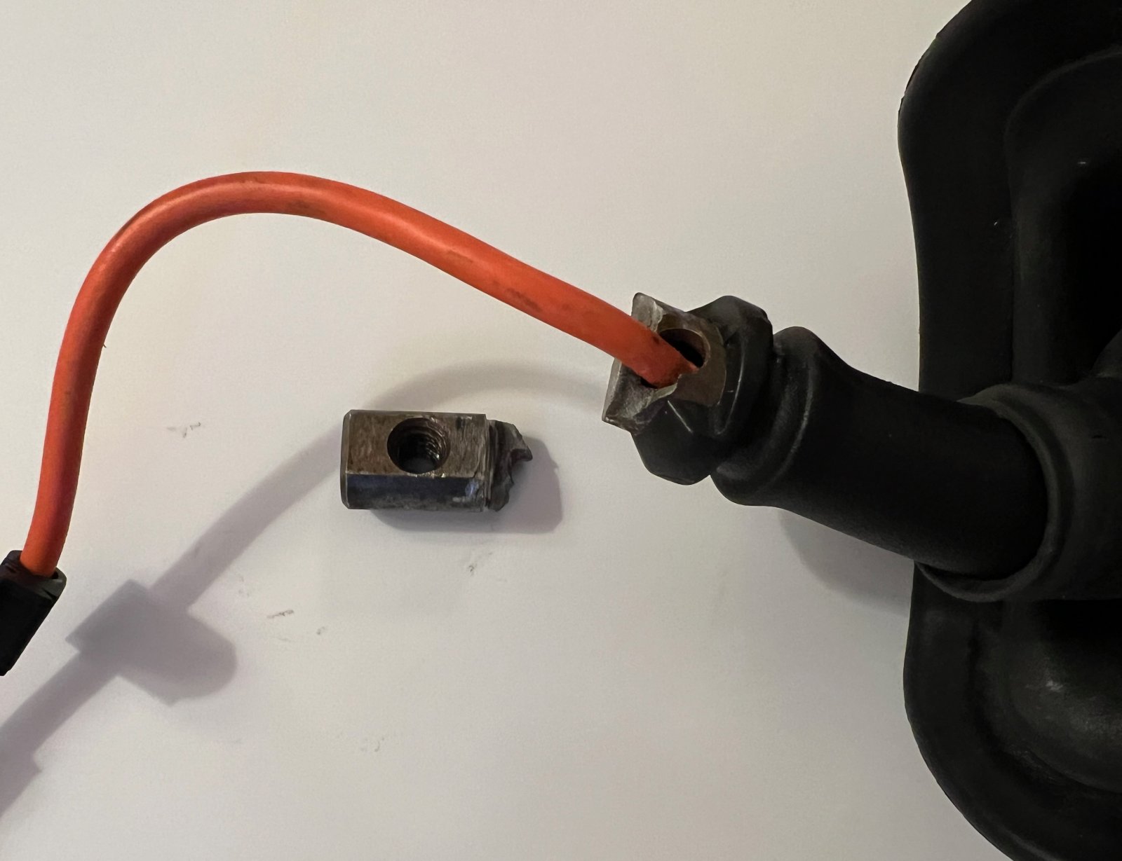

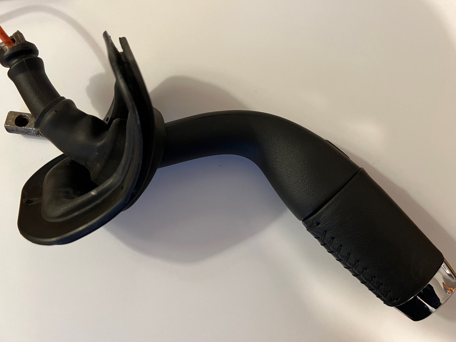

Wednesday, pulled out of the driveway en route to a cabin in Broken Bow, OK, and the shifter seemed a little wobbly. Grabbed it and it went limp. :wtf2:
I knew what happened before I pulled the clamshell :eek:. To properly orient the NNBS shift lever I installed, I followed these instructions and notched the metal and bent in a vice. Perhaps I went too deep with the cut, but the repeated motion of pulling down on the lever combined with soft metal severed it right in two.
Was able to use a small screwdriver to operate the transmission and made the trip to/from. I no longer have the original, so I will order another NNBS chrome/leather like the broken one. I might try to bend it in the vice without the notch. Maybe some heat? Just don't want to be in that situation again but without the bend it hangs so low (too much innuendo for one post) when in "Drive".

Damn, that’s crazy. I just bent mine in a vice, no notch. Didn’t even need much pressure.
