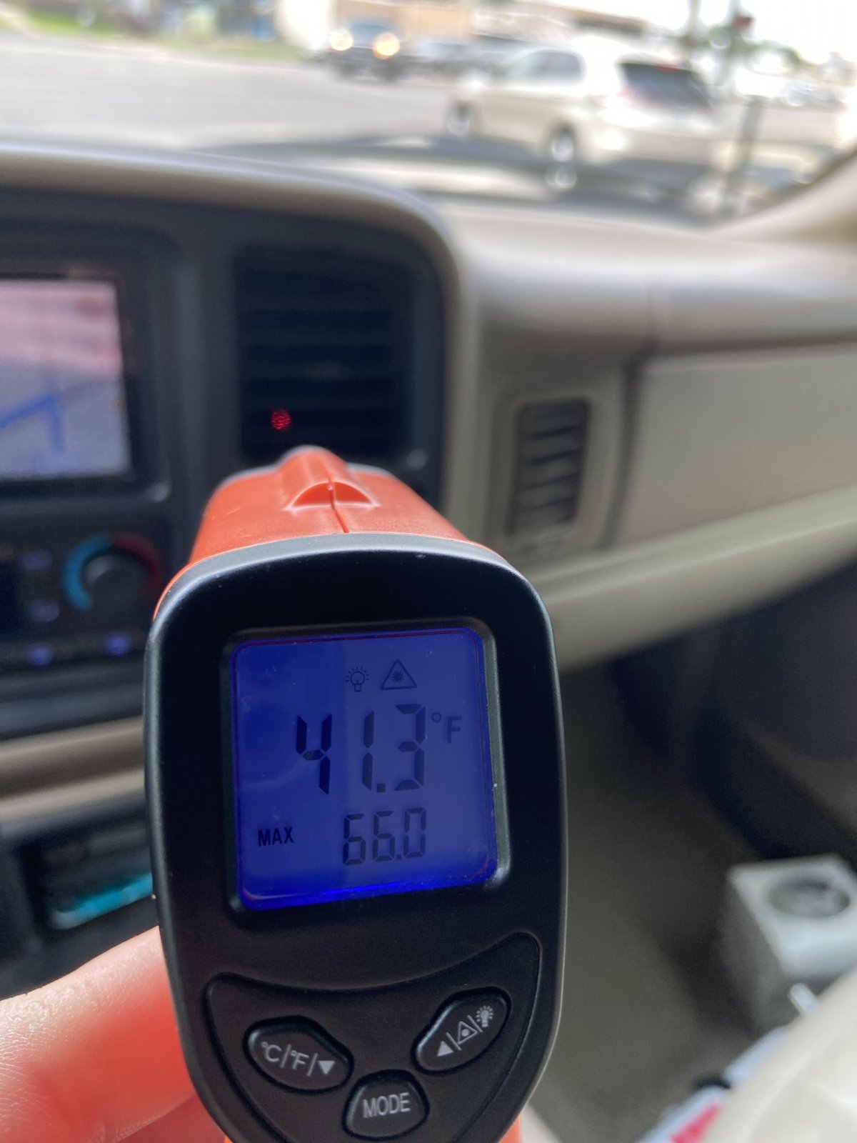

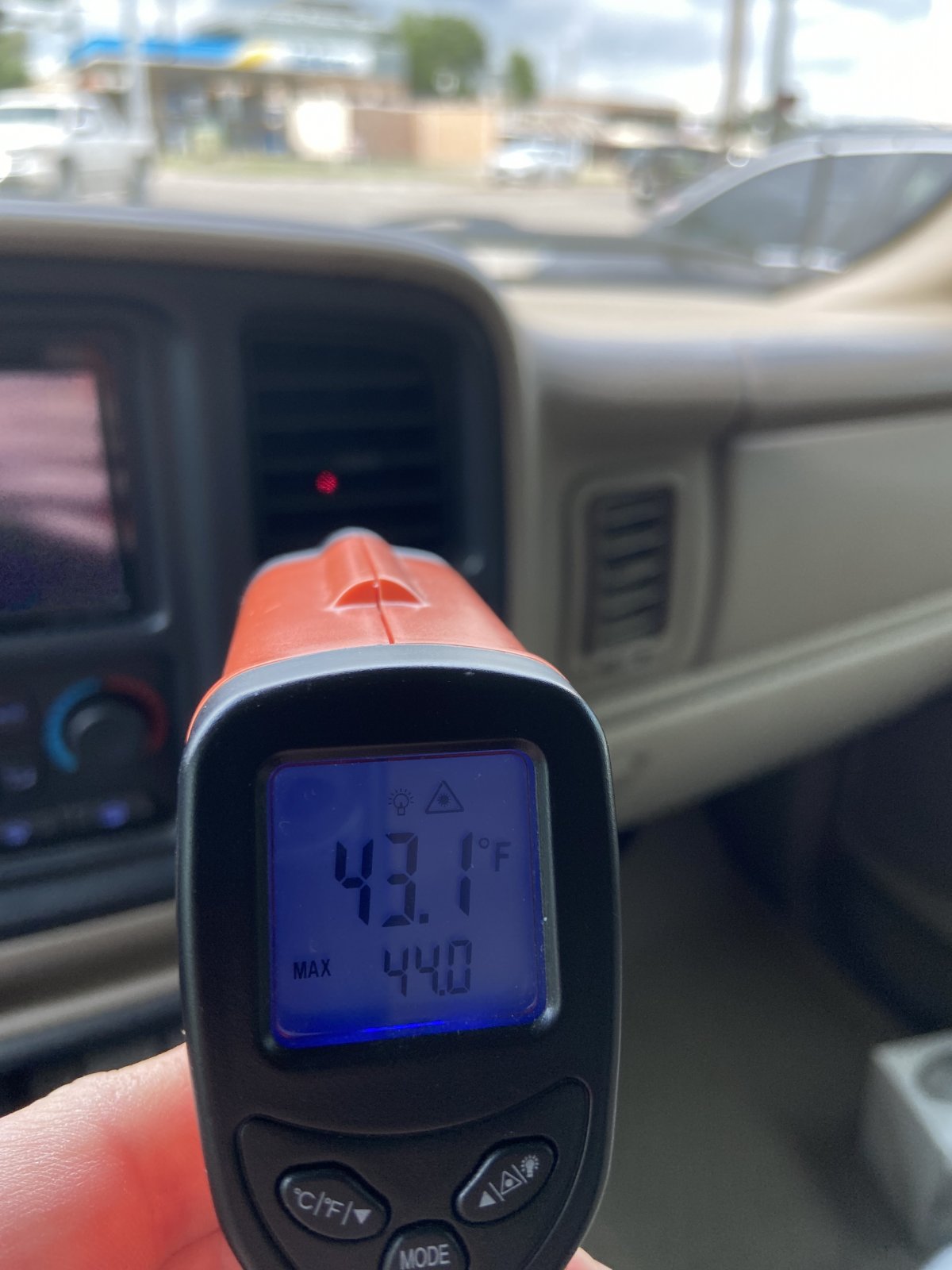

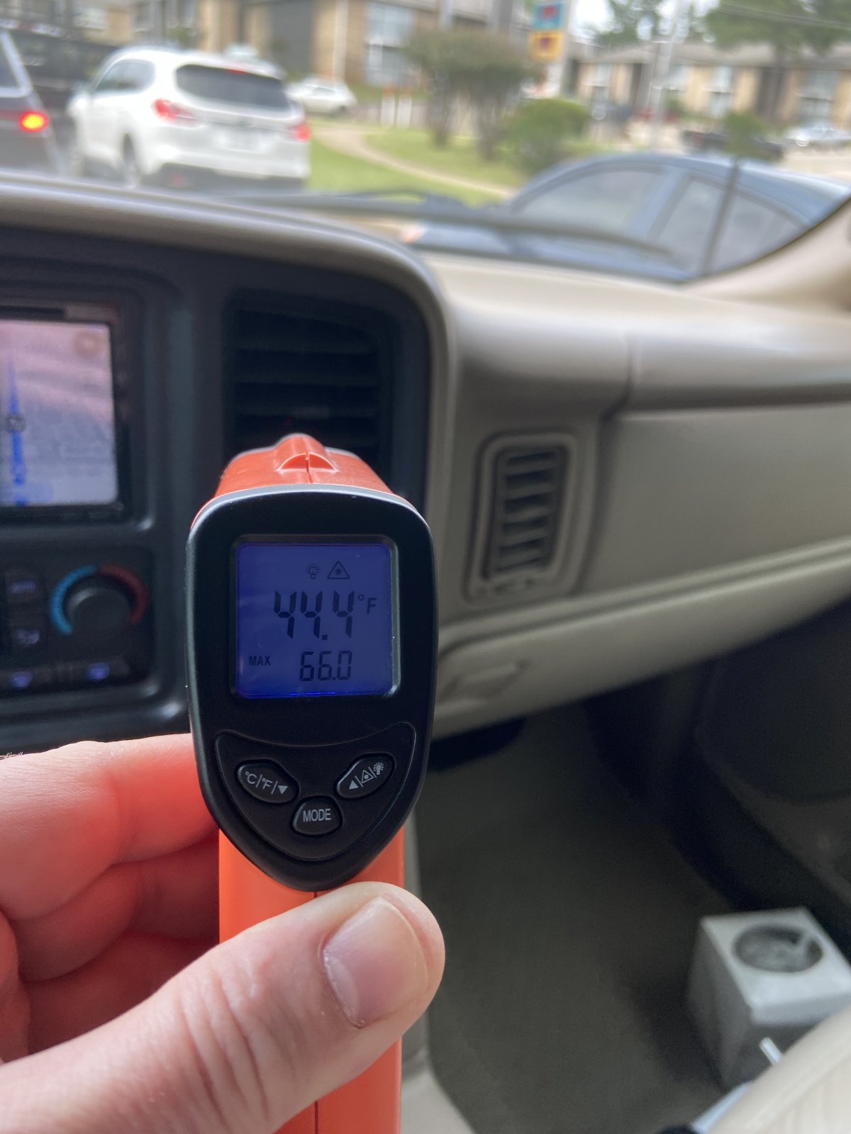

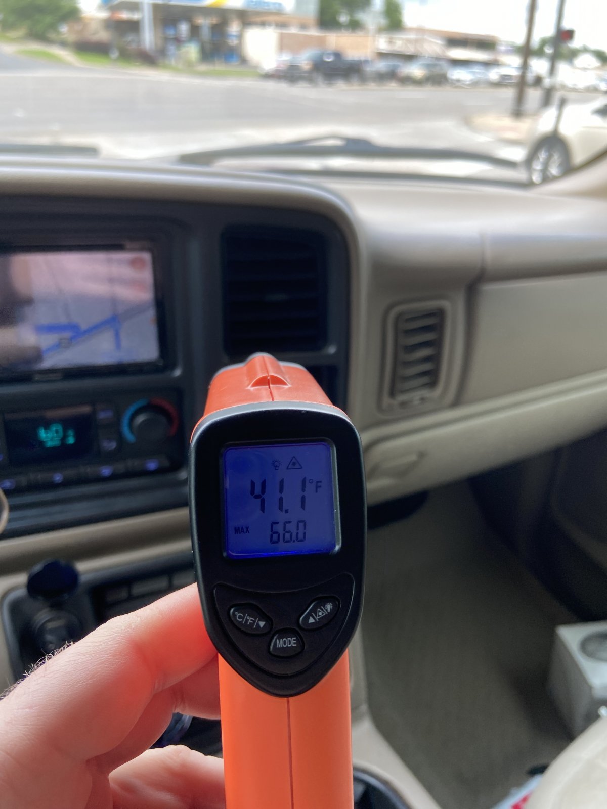

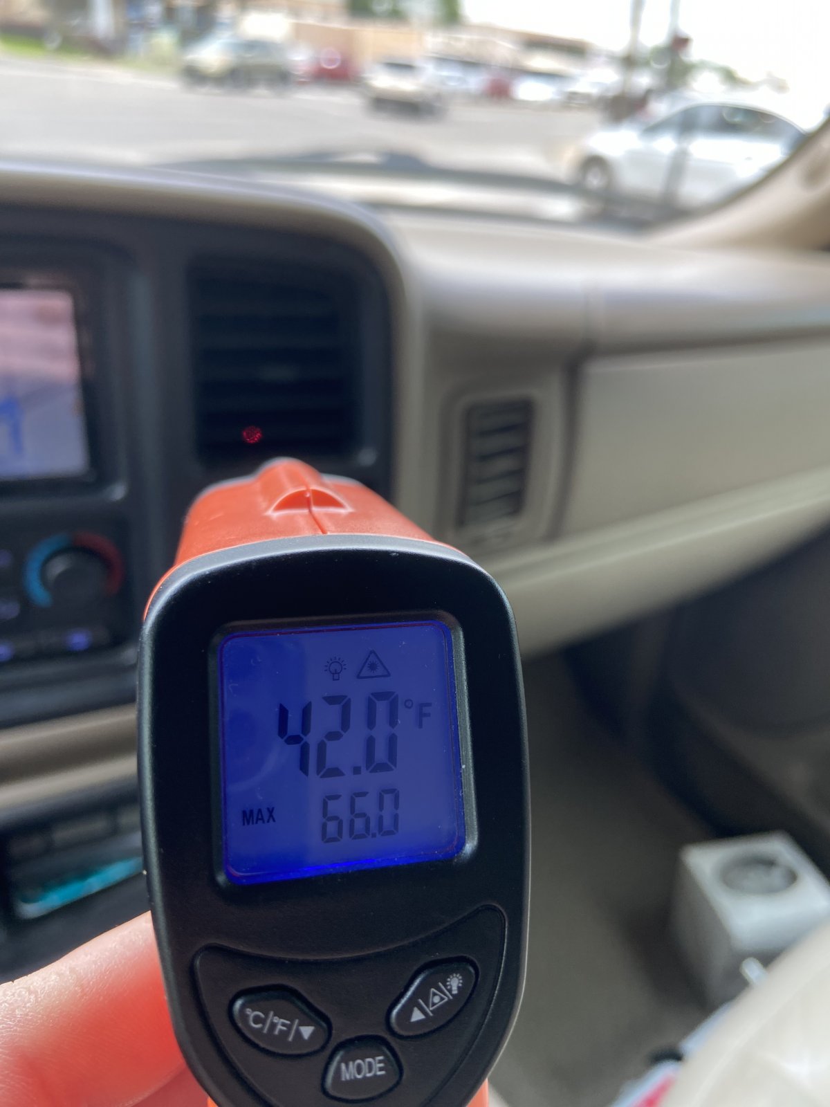

Just picked up the kiddo from school.
Ambient Temperature: 78°
Relative Humidity: 70%
I read between 49 starting the drive from a parked idle (in garage), to a low while cruising of 40.6, but wasn’t able to get a picture while driving. Lol
Around 41-43 while idling at a stoplight:
I wish my home A/C worked that well! It’s around 49 at about a mid-house vent.

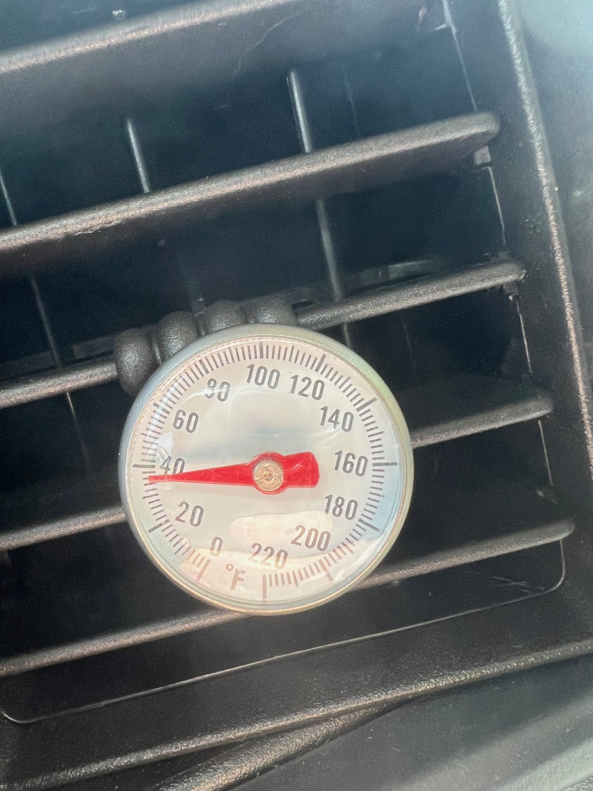

I haven't used my IR, yet. The shop did and claimed 38* but I didn't see it. I have one of those old man thermometers stuffed in the vent. THIS PIC IS BEFORE MY LEAK/VALVE REPLACEMENT. Best I've seen lately is 42* but that's after pulling out of the garage. Usually around 50*
Lol. I’ve got several of those, and initially, looking at my home temps, I was using my ThermPro, which is super accurate. But I got lazy, standing there with my arm in the air.. so decided to go with the IR.
