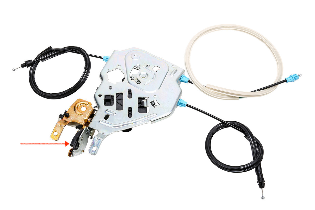

Thanks for the video. Unfortunately, my button is fine - doesn't stay pushed in like in the vid. Even tested it while vehicle locked as in the video. The piece of metal that acts as a catch doesn't work properly. It opens perfectly, but stays open. I can push it closed with my finger but that prevents the glass from closing. If I get the metal piece "nearly closed" I can sometimes get the glass to catch properly and held closed. Piece in question identified by red arrow:

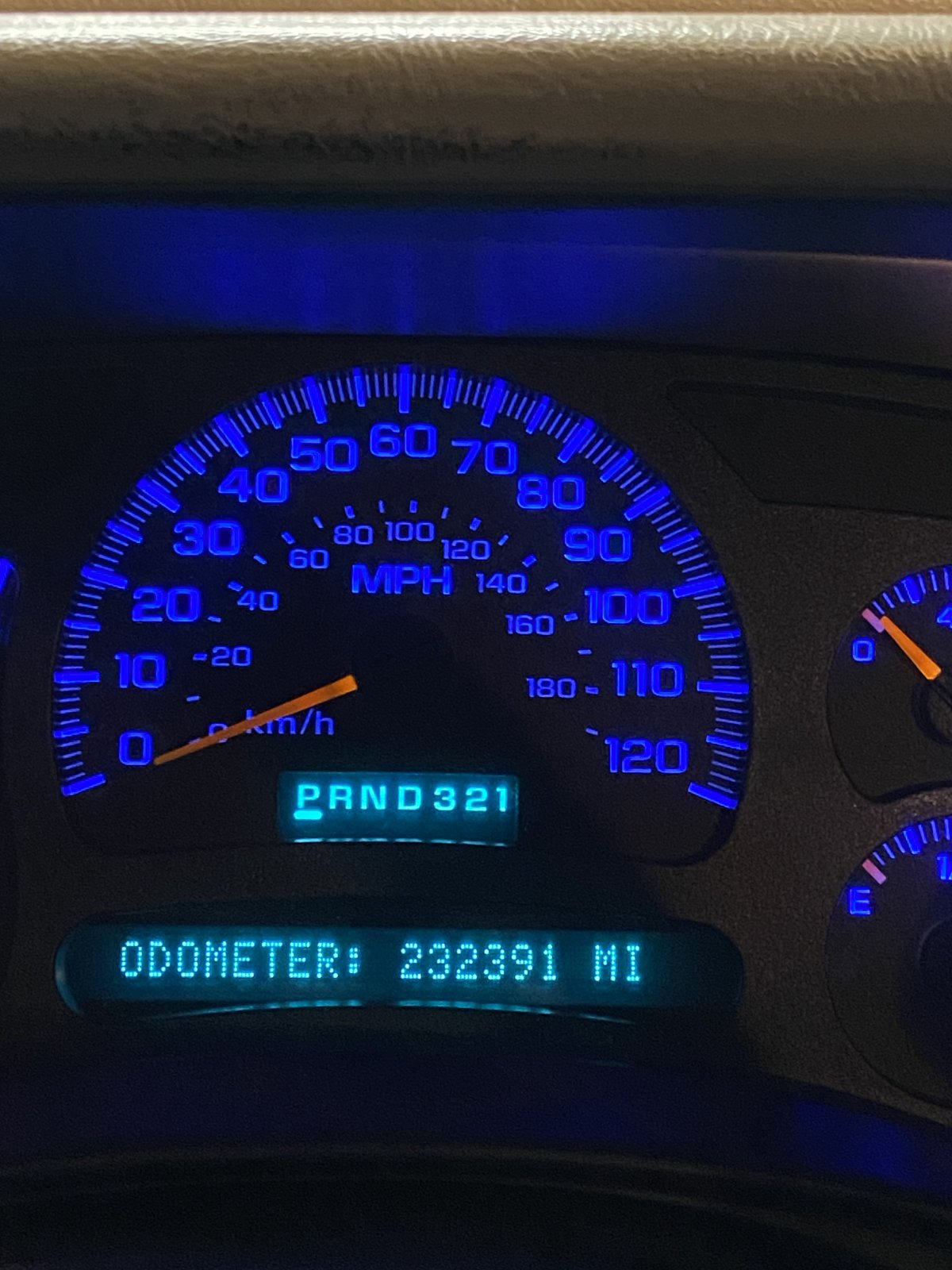

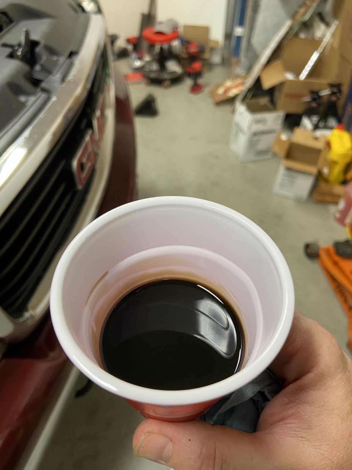

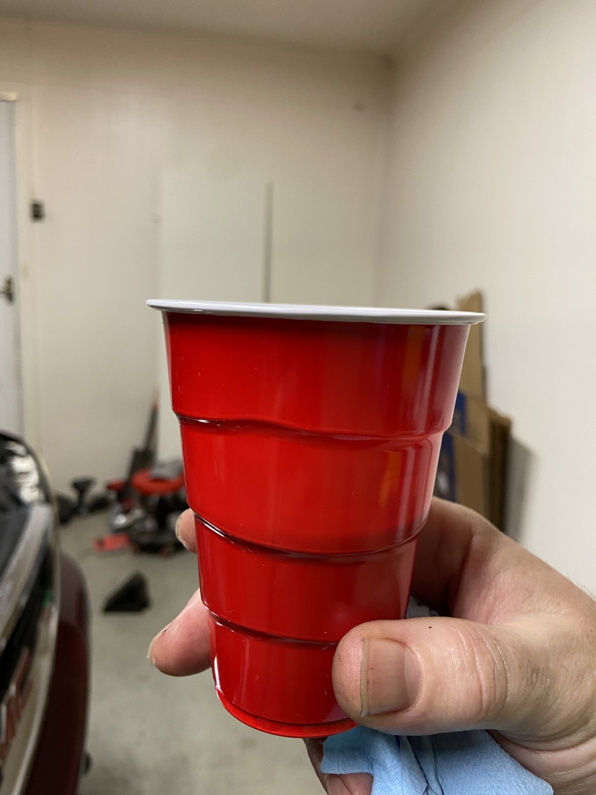

Changed the earl. 232,391 miles. Typical amount in the catch can. Oil was fairly dirty, even after a 3k interval.
