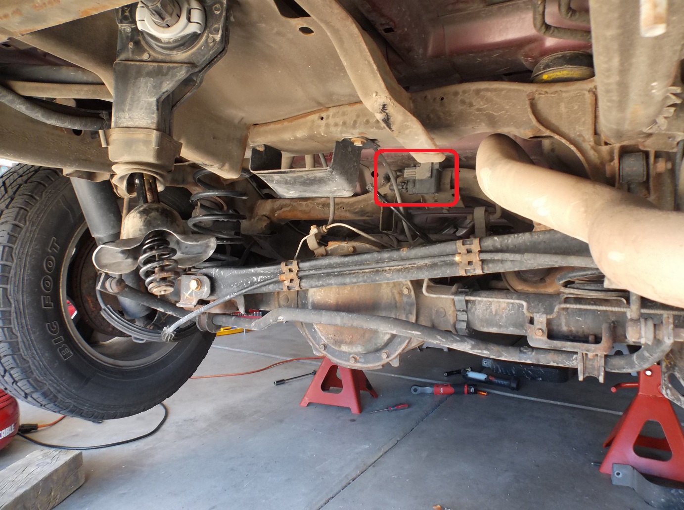

Suspect an intermittent canister vent valve, or a circuit problem on that valve. Mine was intermittent when I changed it out.
The purge valve on the engine should be closed with the engine off so it will seal that end of the evap system. Normal. Most of the time it's closed until commanded to purge the canister fumes, done only when engine running. If it was incorrectly open (when engine off) it would be allowing fumes into the intake manifold, causing flooding and hard starts. And being open it would have the opposite effect, relieving evap system pressure. Nothing to see here.
You can test the canister vent valve by trying to blow through it and alternately applying 12v DC to the terminals. It should be open (able to blow through) with no voltage, and closed with 12v applied. Location shown below on '04 Flex Fuel system.
MassHoe04
Nov 4, 2021
1,588
2,842
Western MA
The purge valve on the engine should be closed with the engine off so it will seal that end of the evap system. Normal. Most of the time it's closed until commanded to purge the canister fumes, done only when engine running. If it was incorrectly open (when engine off) it would be allowing fumes into the intake manifold, causing flooding and hard starts. And it would have the opposite effect, relieving evap system pressure. Nothing to see here.
I have a Tech 2, so I can check the valve response to open/close commands.
I haven't had time to pull it out and test yet.
Purge valve is new. Never had problems filling the tank. Even after the pressure build-up last night, I was able to fill the tank OK.
At least I know the cap is not the issue! If it can hold back that amount of pressure, it sure isn't loose or not able to seal tightly...

I wonder if you have charcoal pellets clogging your EVAP lines, causing the pressure to build rather than vent to the purge solenoid/vent canister when it's activated?
Moderator
16,369
33,856
People's Republic of Colorado
It could also be a plugged canister, but that's a bit further down the testing line, I would think.
Do test with the Tech 2, but don't be fooled by the commanded state of the vent valve, it can work electrically but still not open/close properly. As I noted, mine was intermittent and testing on the bench confirmed that.
