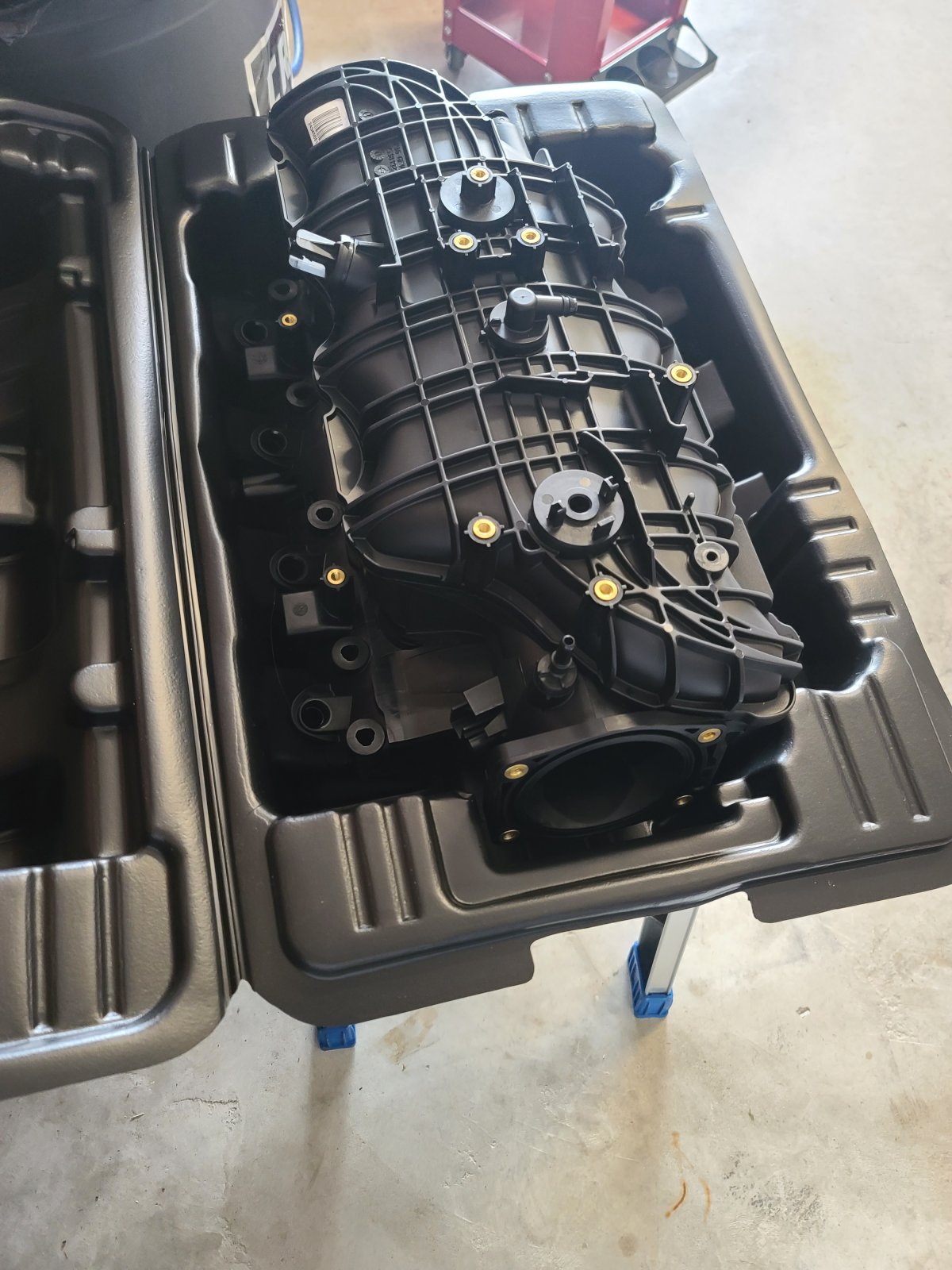

Picked up a free intake from a buddy of mine. He got it from someone else and had no need for it. Looks to be an oem TBSS. After some research, looks like the swap is not direct swap and will require several things. All he gave me was the bare intake.

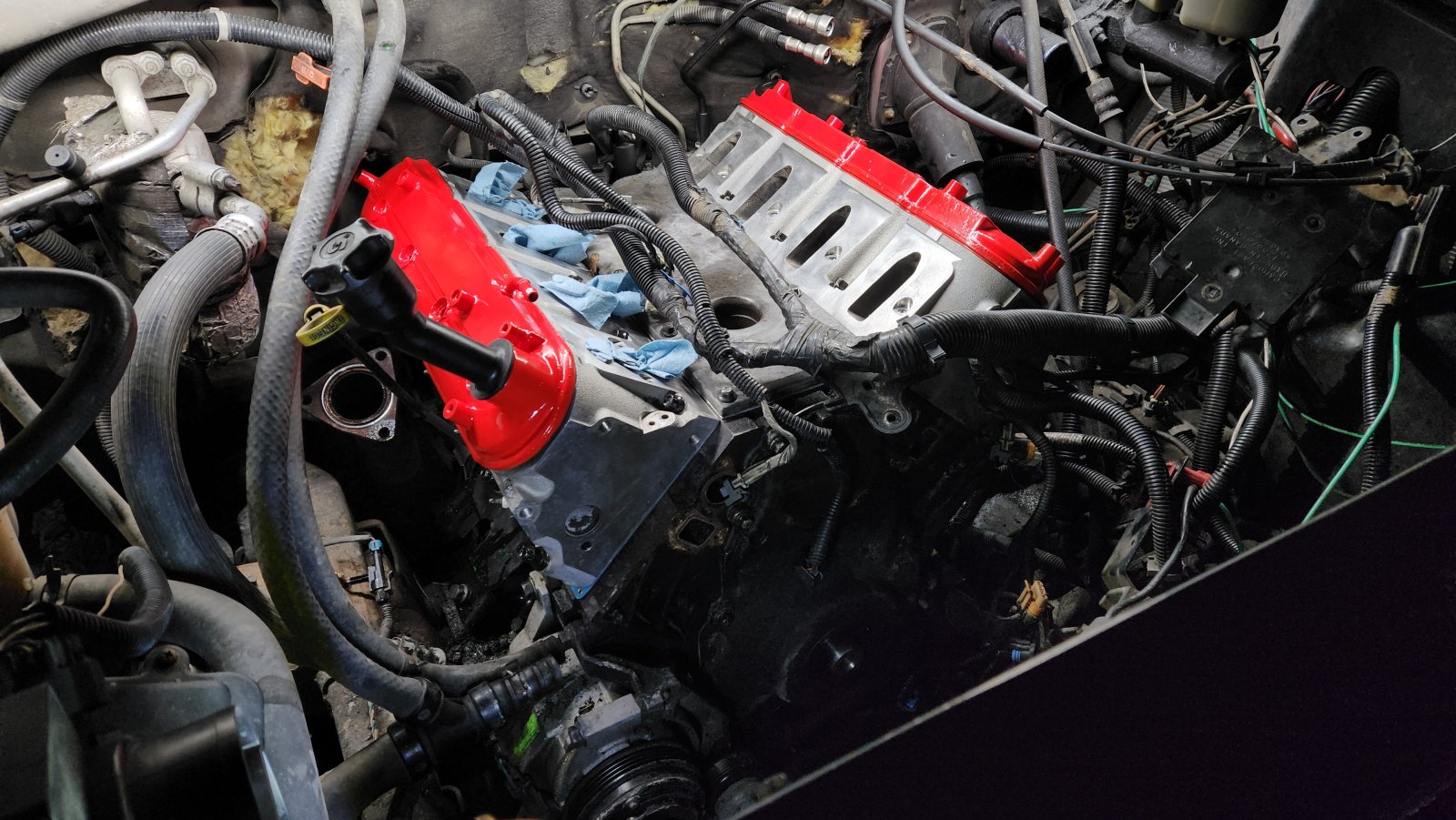

Not Tahoe content exactly, but figured you guys would still appreciate it.
Buttoning up my '02 Silverado 2500. 6.0 just went down for major overhaul/maintenance. New motor mounts, cam, lifters, hardened pushrods, head studs, refreshed 862 heads, rockers with improved trunion, stainless shorty headers, upgraded trans cooler, tranny fluid change, replaced tranny cooler lines, etc.
Went with a Summit SUM-8719R1, for those curious. .550"/.550" 209/[email protected] 112±1LSA
I expect it'll be pretty happy in the 6.0, particularly with the increase in compression with the 862 heads. Excited to have it all buttoned back up and get it tuned/back on the road.

Easy install and I already had a set. I still have the factory exhaust anyway and it's in great shape. While I would've loved the bump in low end from the long tubes, just wasn't necessary right now to spend the money and go through the effort, especially when I didn't have a better muffler to support the increased flow.

Wow. I am completely backwards. I always thought the shorties were better for low end power, but limited, and the long tubes were for high end power, but more of it. Anyway, thanks for answering my question!

Yep! Long tubes are better in every aspect except packaging. And cost, of course. You're welcome!

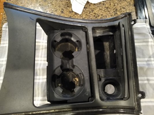

Ha! Whoops, broke the rules already! Here's a shot of it before I finished cleaning it. It's was a mess coming out of the junk yard. The bottom cupholder part came off the Escalade and then just attached it to the Denali top. Probably about 15 little screws with one hidden underneath a clip in part. I'll get a sgit of the back later.

My dad always said nothing is free! Looks like that "free" intake might be spending a lot of cash... LOVE IT! Ya gotta do it now...

If it's one thing I hate about these trucks is these weak shallow cup holders!! My coffee mug is all over the place in the mornings unless I'm holding it

You need the flex fuel rails, and either the corvette fuel filter, or a fuel pressure regulator for the return.
Then if your truck is drive by cable you can get a Chinese 4 bolt TB. I think the thing for DBW is called X-link.
Also, make sure it is cathedral port before you start buying parts... lol
