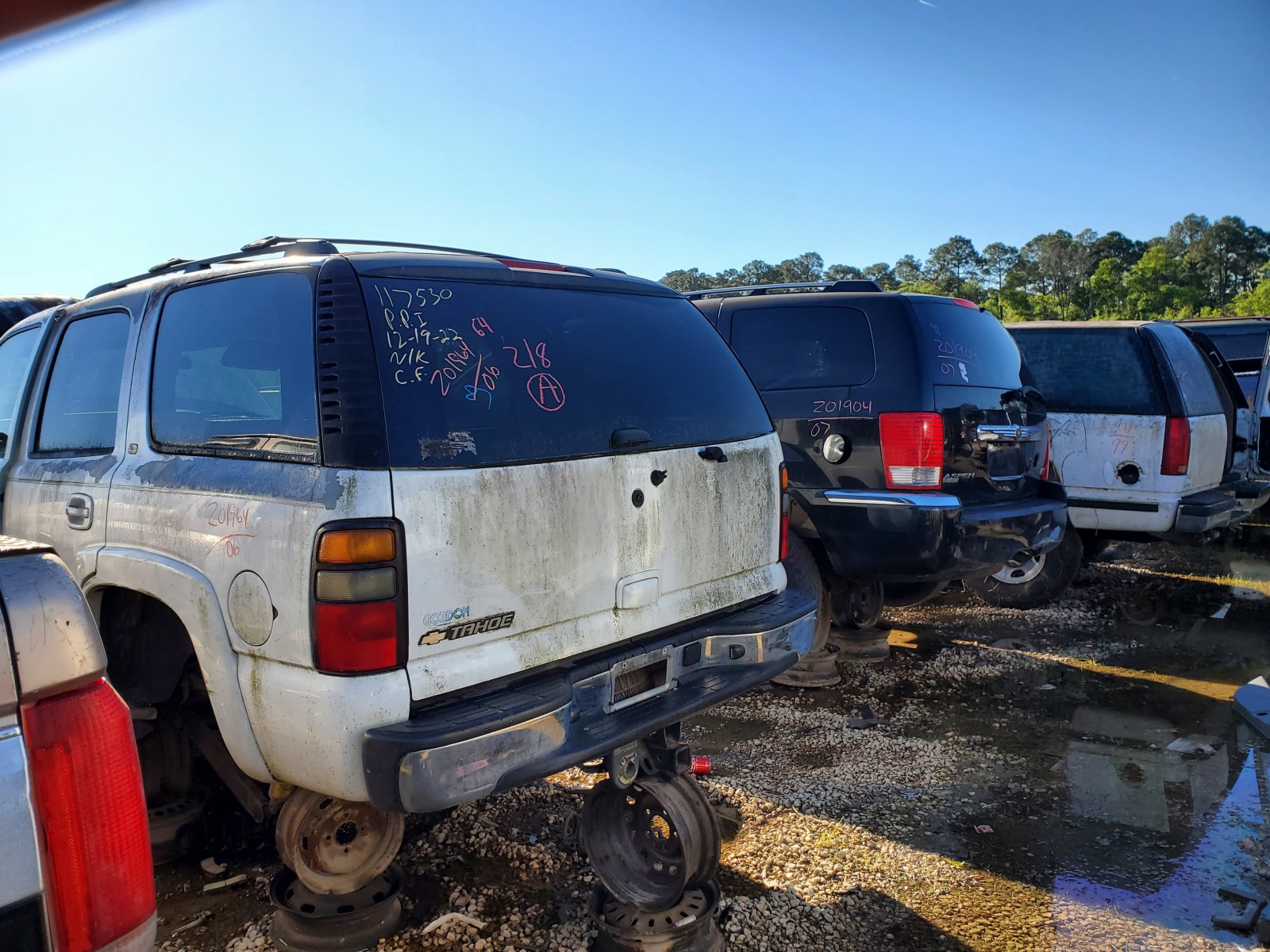

Had a great morning at the junkyard. New glass. Also new tires delivered today going to drop them off to get mounted on my silverado takeoff wheels. Very exciting

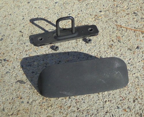

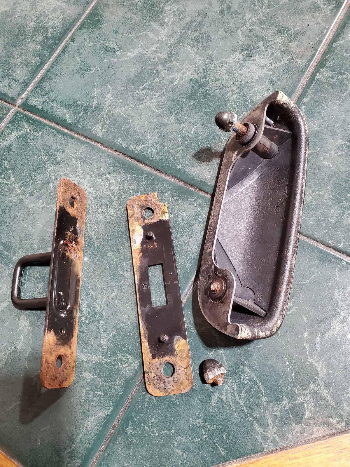

My luck ran out and I done f**d up. When going to clean my glass I thought it was a genius idea to remove the handle/striker plate since it was so rusty.
Snapped a bolt.
Not sure if I can source a replacement handle.
Edit: this looks like the same exact part, it is worth a shot

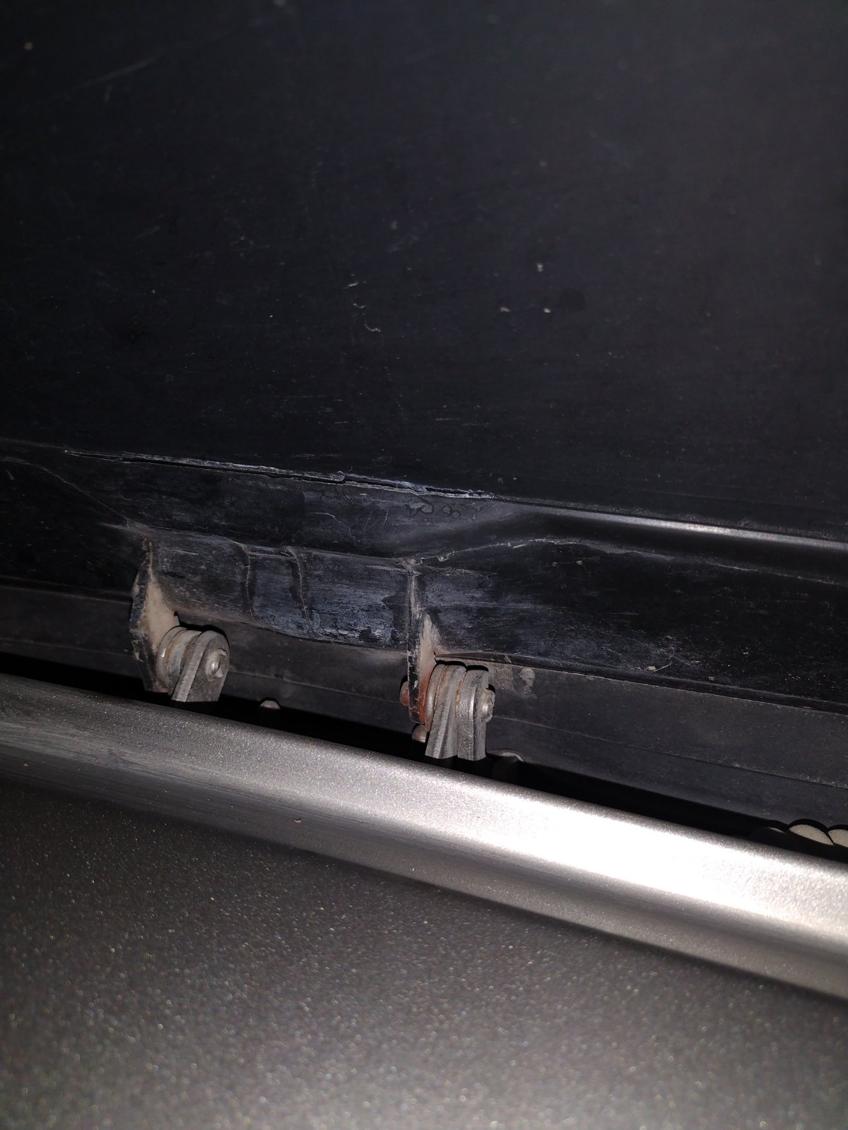

Today I replaced my liftgate and rear window support struts/shocks. The liftgate wouldn't fully open all the way since I bought it in Sept. I was always very close to knocking my hard of the gate so it's def overdue. Was also extremely hard to close and the rear window wouldn't stay open so now it closes very smoothly and everything opens and functions as it should. The little things count just as much as the big repairs!! Have a great day yall
My hinges on the glass broke shortly after replacing with new struts a few years back, as the hinges are molded into plastic and it is very weak. Hopefully that isn't the case for you
As I was removing the old struts I noticed the passenger side hinge molding was cracking from the glass... I can see it's weak but still usable as of now. I think the new strut actually helps it from breaking now as fast but maybe I'm just living in a fantasy world about that lol... I know that I will not be opening it up as much as I thought I would be doin now. When yours broke, how did you fix it? My first thought would be to try and bandaid it by using epoxy or something like that... I'm not sure what I would do if it completely broke off...
So I never ended up repairing mine that broke, although I was prepared to. I had bought "3m fast cure auto glass urethane" as I read most other stuff like jb weld fails. Prep the surface really well and c-clamp it with the urethane.
I was fortunate enough to have a friend that gave me his hatch glass, he had repaired his hinges. When I put that glass in, I took out the struts and stopped using the hatch glass. Even after it is repaired I believe it will fail again.
The reason my friend gave me his hatch glass is because a few years back we hit the junkyard together and he was fortunate enough to grab new glass off an escalade. The other day I was lucky enough to grab new glass off a 2006 tahoe, 2005+2006 models have improved hinges which to my knowledge don't have a history of failing. It cost me $50.
