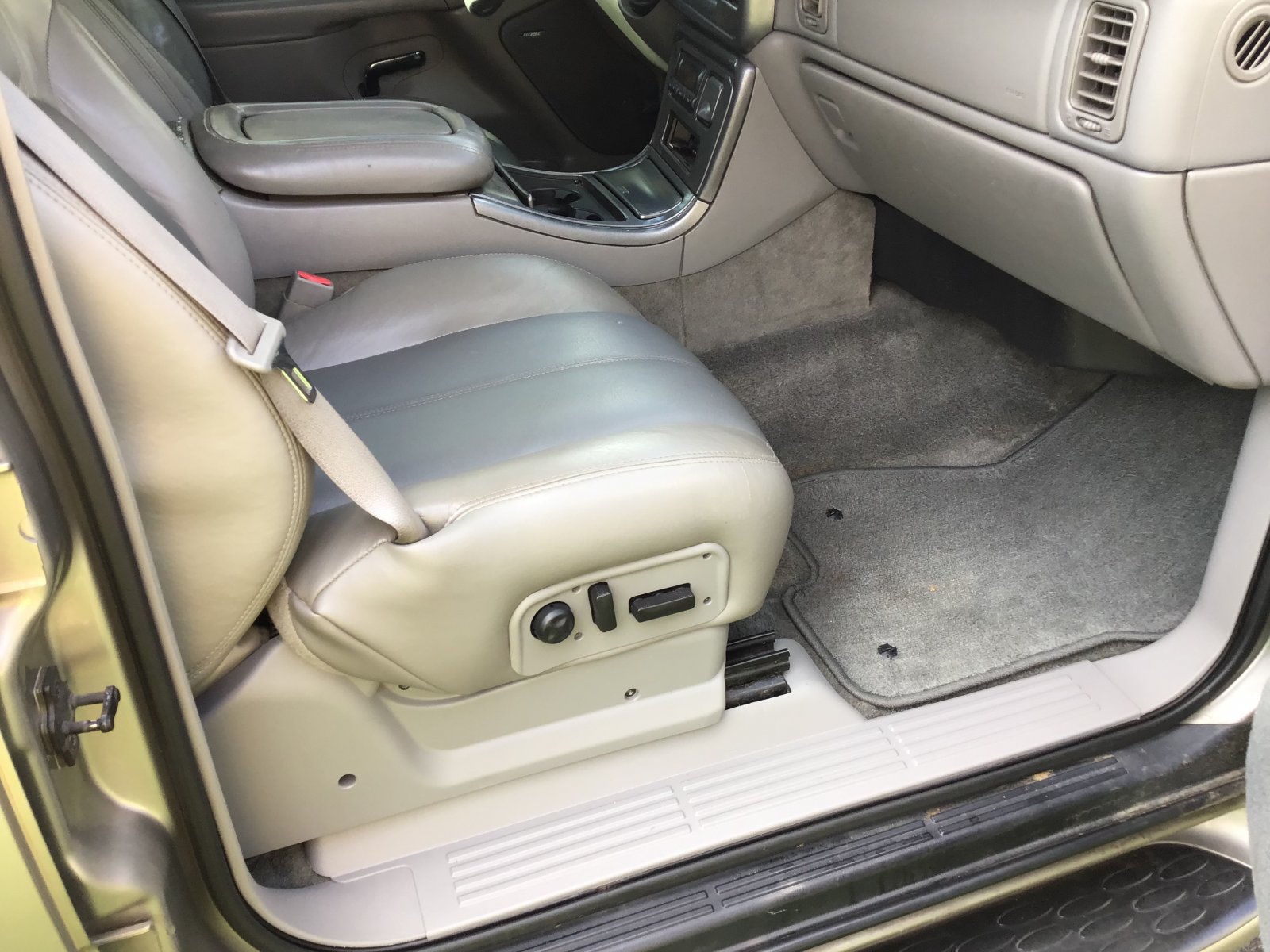

Almost finished with the interior freshen. Plastics have been painted, carpet and mats cleaned etc.
I was looking at these pics and noticed the seat switch bezels didn’t quite match so I had to paint them.

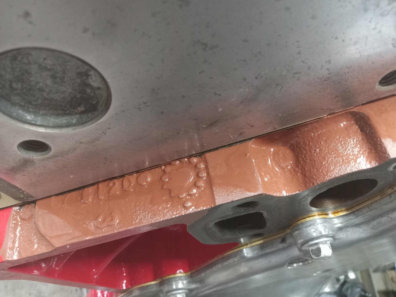

Was gonna leave these pieces that I missed unpainted, but I gobbed some primer on. Now I'm waiting for paint to dry, lol
Oh, and I got the BTR 11/32nds 7.375 pushrods in, if my measurements are correct it should have me at .075 preload on the lifters. Hopefully I have a nice quiet valvetrain, or I'm probably gonna freak out, lol

Just to be that guy, the only way to know is to measure with a length checker. I did all kinds of double-and triple-measuring during my build. ~15K miles later, when I had it apart to replace the rockers, I checked ALL of 'em. They were all over the place with the corners being the highest difference. This coincides with the corner cylinders having higher piston heights. After some research, I learned that, apparently, LS engines can be slightly "curved". Since the LS7 lifters are happy within a relatively wide range of preload, I decided to not order a specific length for each one and just split the differences to lower the highest preloads and raise the lowest preloads to have a much more balanced average that was much better within the acceptable operating range. Tedious work! I have the rods in hand but haven't had a chance to install them. I'll have three different sizes altogether, so not too bad.
