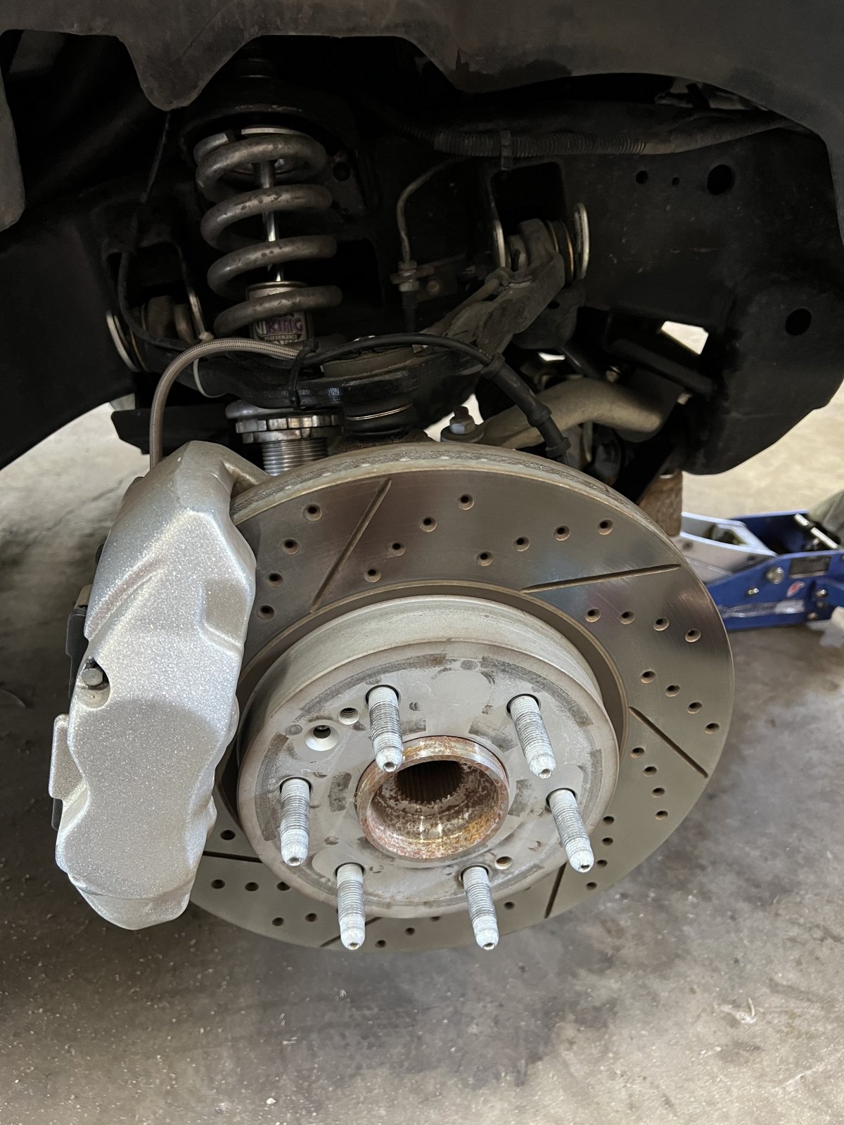

I had NAPA Ultra-Premium Polymer Coated discs with NAPA Gold Premium ceramic pads on my Jeep. Going to those again for my Tahoe the next set of brakes needed. Discs looked like brand new, even after 3 salty New England winters! Pads were awesome. Greta stopping and practically no dust. The discs were amazing, though!
NAPA makes nice stuff I used them in the past on another truck, but the cost is not worth it to me for this project. The overall braking performance of the truck with the 2020+ 4piston caliper set up in the front, hydro boost master cylinder, and stainless brake lines all around is stellar! Since this is just a basic replacement for the rears which probably do less than 30% of the work in this application I just want a quiet dust-free replacement. I'll send the calipers to be rebuilt and powdered to match the fronts but that's only because he's cheaper than buying new OEM replacements. I think these are the original calipers and at 280k I think it would be silly not to address that.
I still really want to come up with a way to either adapt the 2020+ 4 piston calipers to the rear or find some other budget-friendly (under $1k) rear brake upgrade that has an attractive-looking caliper.

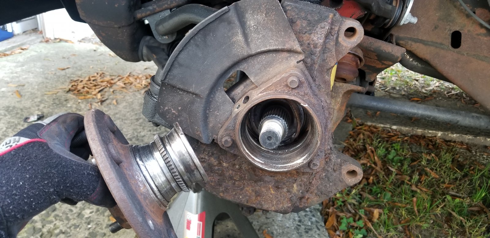

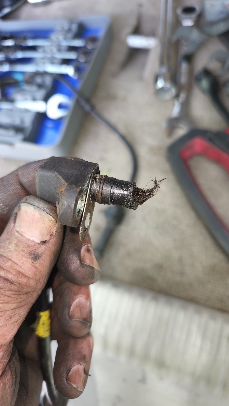

Recently, I had an ABS code related to the right front speed sensor come up. The code cleared and was gone for almost a week. Running fine.

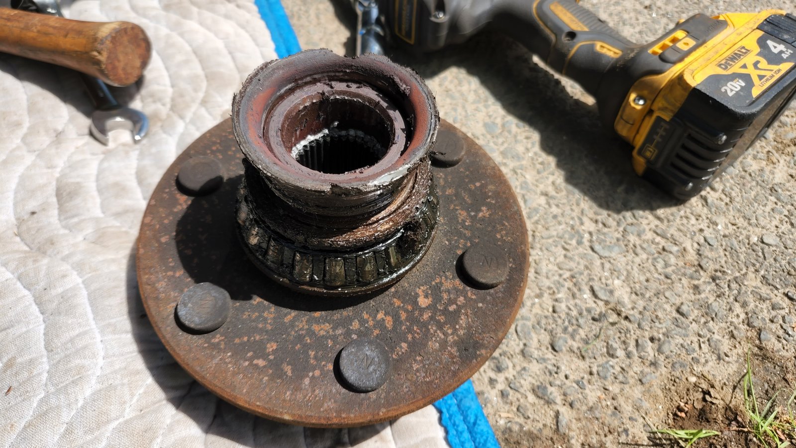

Found out the recent Right Front ABS sensor issues were 100% caused by failing hub.
Made a big POW and grinding noise driving home from Home Depot.
This is what I found in the morning... It spit out bearing rollers like a hockey player spits teeth!
I was able to pull the front half of the hub off by hand as soon as I got the axle nut removed.
Removing the back half of the hub was the fun part!
The only thing that got the hub to pop out was backing the bolts out about a half inch and beating the snot out of the bolts. I am so glad I bought the new bolts!!! I am keeping these to use again the next time...
This all that remained after the hub ate the ABS sensor...

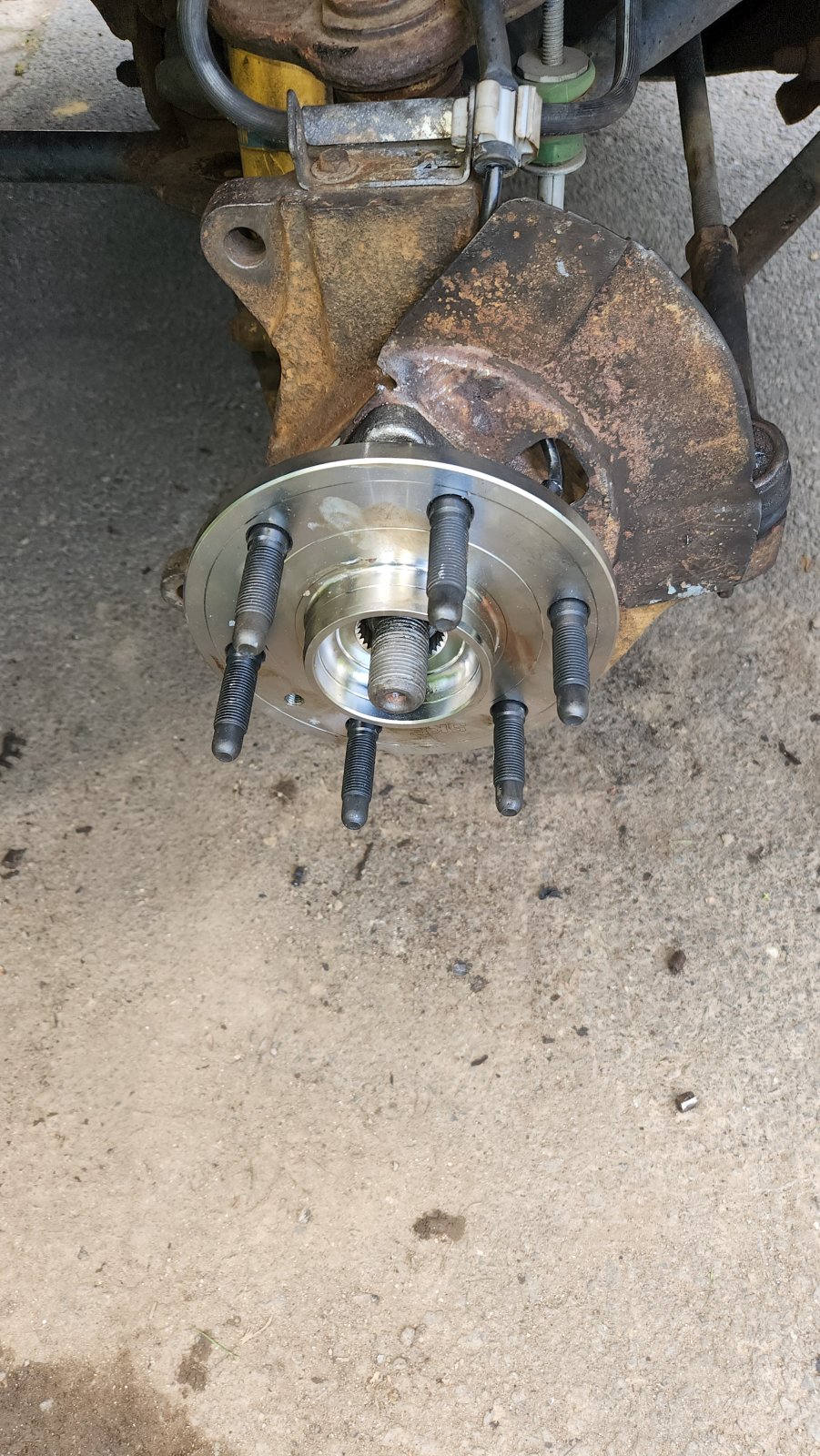

New hub had sensor included.
Here is the new hub. I did not go low-grade, because I could get the better hub with 20% discount this week from NAPA. It was https://www.napaonline.com/en/p/BRGBR930304?impressionRank=1
Someone more knowledgable can tell me more...
It is an SKF part BR930304.
From a quick search, I saw some information that SKF was OE supplier to GM and may actually be Timken.
Let me know.
Usually with NAPA, the higher price item really is the premium product from the major OE suppliers. I have never been disappointed any time I went with their higher-priced items.
I still had time to get out and mow the lawn after I was done.
All is good in the neighborhood. No ABS codes and everything feels tight.

I hear ya! I had brake pads and rotors that got really bad and needed replacement in a hurry. I went with basic budget pads and rotors. The the caliper locked and had to get new calipers. Went with mid-level stock calipers.
Just remember, that the big brakes need more clearance. So you may need 18 inch or bigger wheels, if you don't already have them.
Calipers locking are up scary! Not sure how the pad or rotor quality could have caused that tho. I had a caliper lock up in another truck while I was heading to go camping in the Black Hills of SD. by the time I could find a safe spot to pull over the brake had gotten so hot that when I splashed water on the wheel it immediately sizzled off! Having minimal tools and being by myself I simply tapped the caliper with a hammer after it cooled off, it unlocked and the camping trip resumed. I did swap the caliper put shortly after the trip.
I've had the bigger front brakes for a year or so and probably 15k or more miles, they are the best brake upgrade I've ever done other than swapping to hydro-boost. They are also wearing very well, the pads are very meaty still.

Same exact thing happened to mine. The ds. All the bearings also fell on the ground. Front part of the hub fell right off, but the rear part wouldn't. I beat on it for hours with no luck. Bought an air chisel from HF for under $30 and it came off in 1 minute!20211015_161749.jpg20211016_123640.jpg
The wheel was still bolted to the hub with all 6 lugs.
After I pulled the wheel off. I didn't mess with anything else yet--other then taking the rotor and caliper off.
We had just came back from driving an hour too. Pretty damn scary.

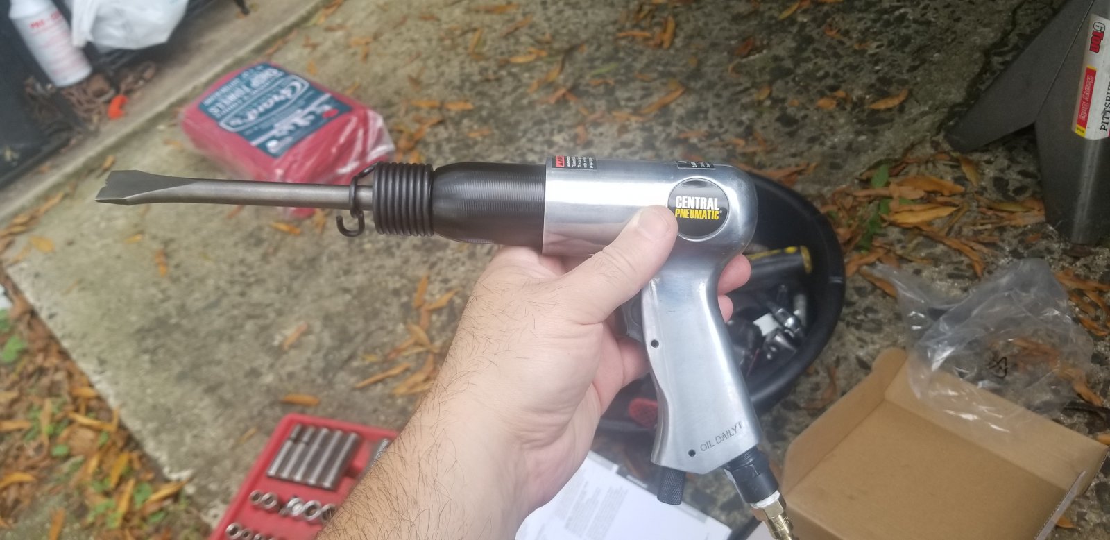

WOW! I will be getting my dad's old compressor as soon as I have room in my basement. A chisel will be one of the tools to go with it. It is an old Sears (Devilbiss) 30 gallon, but it put out great C.F.M. for tools.
Yeah, I was real lucky. It happened about 3.5 miles from the house, I was going about 35 MPH and was able to pull safely into a business driveway right away.
I have a rinky-**** propane torch nozzle that doesn't work that great and keeps blowing out. Not that hot and not effective.
I thought I was going to be in a real pickle getting the back half of the hub off the knuckle. I was amazed using the bolts to drive it out really worked. That hub was really locked in there solid!!
When ordering the hub online (while I was waiting for AAA flatbed), I was on the fence regarding buying new hub bolts. But when I was at the counter picking up the hub the next morning, I told the guy "if I buy them, I might not need them and can bring them back. If I don't buy them, I know I will snap one or something stupid will happen. LOL" That was the best $27 I ever spent!
Since you only need to thread them in part way by hand in order to bang the hub out, I am keeping the beat-up bolts for the next hub replacement.
A calm head and determination saved my butt and I feel more confident the next one will be easier. OK, maybe not easier. But, at least I have learned a few different tricks to bail me out next time.
