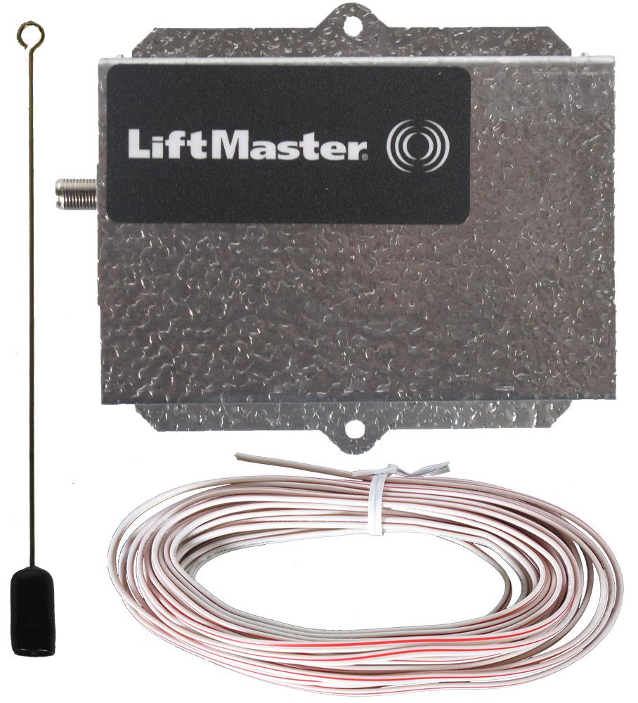

You nailed it! As an example, Liftmaster has this universal receiver:

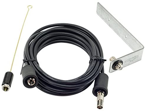

It uses a standard RG-6 male on the housing and that antenna is just a stiff wire for the core/center conductor with the outer female coupler (under the black vinyl cap). You can screw the antenna directly to the receiver or use an extension kit if needed:
I have this receiver on my shop's door operator. I don't have the extension kit, or even that antenna. I screwed a length of coax to the receiver and routed it out through the peak of my shop, above the door. I stripped off the insulation and shield to expose the core the same length that the antenna is. A friend that still did doors at the time gave me the measurement. Remotes work great!

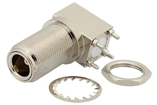

The problem with the residential operators is that the antenna is just a length of wire soldered directly to the control board. The newer ones don't even have that. You could solder something like this:
to the PCB and run a coax to wherever you wanna put an antenna.

The problem with the residential operators is that the antenna is just a length of wire soldered directly to the control board. The newer ones don't even have that. You could solder something like this:View attachment 371309 to the PCB and run a coax to wherever you wanna put an antenna.
I found the instructions that show stripping the insulation off the end of the integrated antenna, and how to extend that with coax and the external antenna in the kit. Looks kinda hacked to me but it probably works better than what I have now. Having the connector on the opener would be a solid mod.
