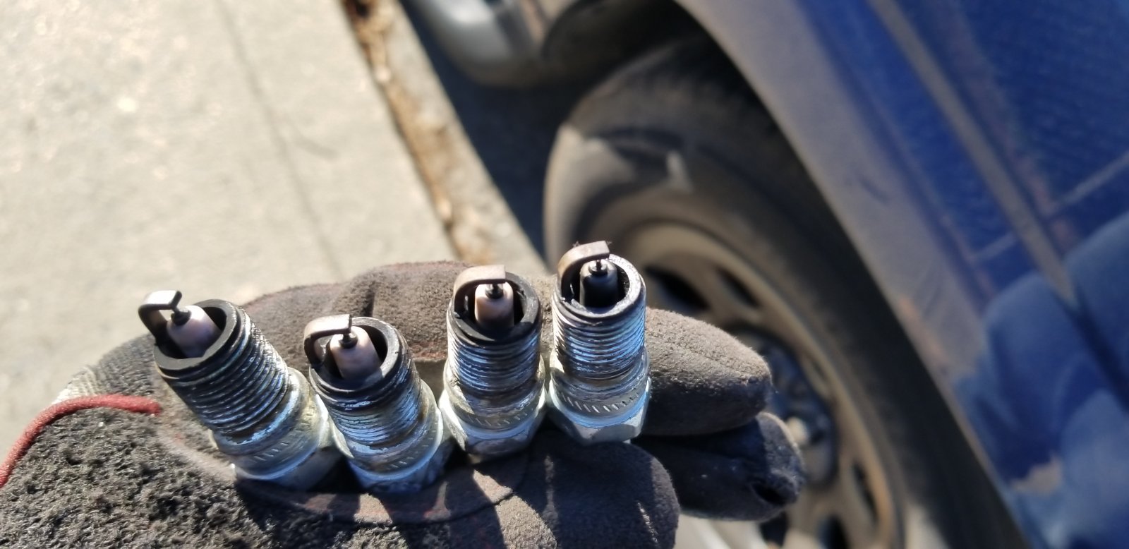

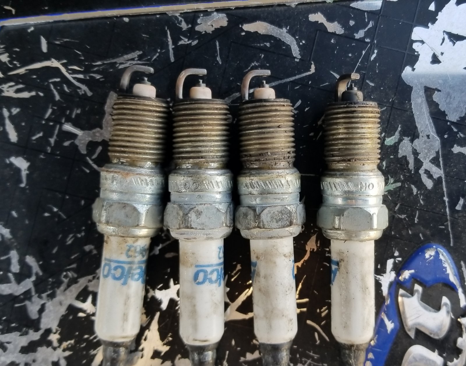

Checked out the Tahoe today--finally. Pulled the plugs. Cylinder 2 was discolored(black)and ever so slightly wet--not much. All other plugs were great. There's probably 500 miles on them since they were changed.
Cylinders 2,4,6 and 8.

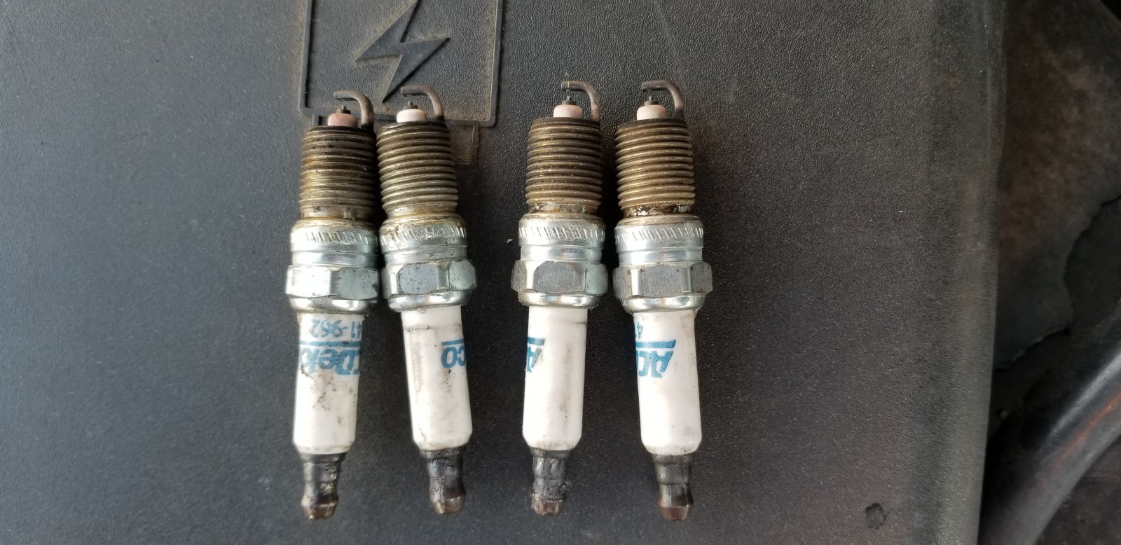

Looked great, as they should.
I tightened 3 loose exhaust manifold bolts on the driver's side. That's where I was having an issue with stf/ltf, bank 1. I guess that was the issue. Runs 100 times better, but I still heard a little popping from the exhaust. Nothing loud or anything, but I heard it.
I saw some antifreeze drip out of the right side heater core line. I guess I leaned on it when I was trying to pull that last plug. I pushed it in and gently wiggled it, and it seemed fine. I let it run for awhile, then took it for a ride. System didn't pressurize, so idk what to think about that. Needle didn't move a lot past 160 degrees. Heat worked. Guess I'll keep an eye on it. No more leaks tho.

Cylinders 1,3,5 and 7.View attachment 361290

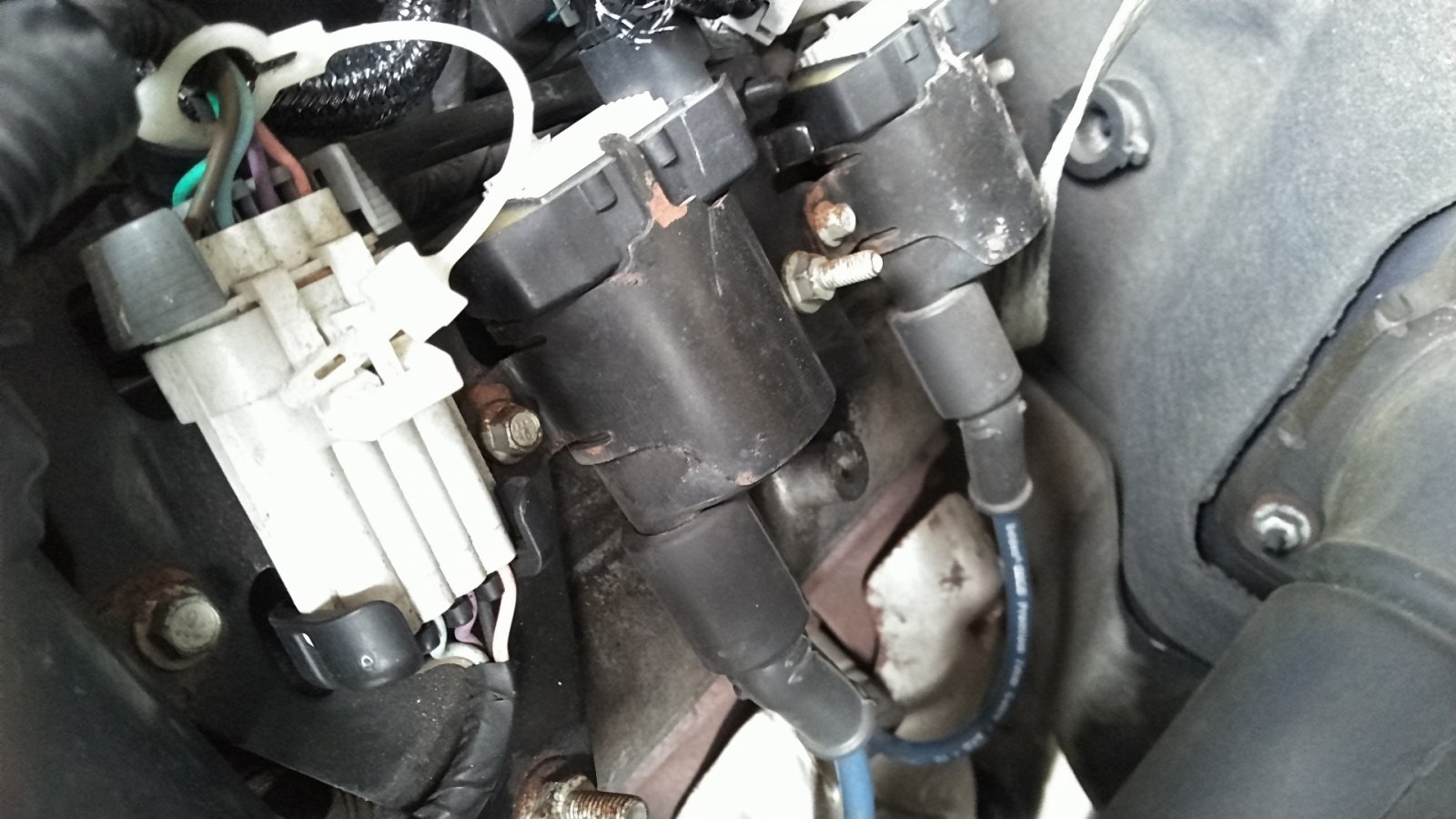

Thanks for the coaching...... What were those REALLY nice wires? ( round coils)..
....and I suppose to replace plugs with OEM? ( plug numbers?)

Are those wires original? I can't make out the lettering. They look blue.
You can't beat OEM wires and plugs. They last +100K miles and, if they're good enough for modded Corvettes, etc., they're more than sufficient for a stock 5.3 in an SUV. Surely you'd know better than to fall for the gimmick plugs. I believe yours came from the factory with platinum plugs. In all honesty, old-fashioned copper plugs perform best as far as producing spark. They just require more voltage to spark and don't last nearly as long as the platinum, iridium, etc. variants. With the platinums, etc., the loss in sparking power is a small compromise when you don't have to replace them every ~30K miles.
As for aftermarket wires, I've never been let down by Taylor. On past vehicles, I've had issues with MSD (I think a few of us here have) and Accel. I'd stick with OEM, but would get Taylor if I wanted a pretty color. Last I checked, they tended to be the same price, if not cheaper than AC Delco Original. Actually, I've been wanting to replace my wires but just haven't bothered.
