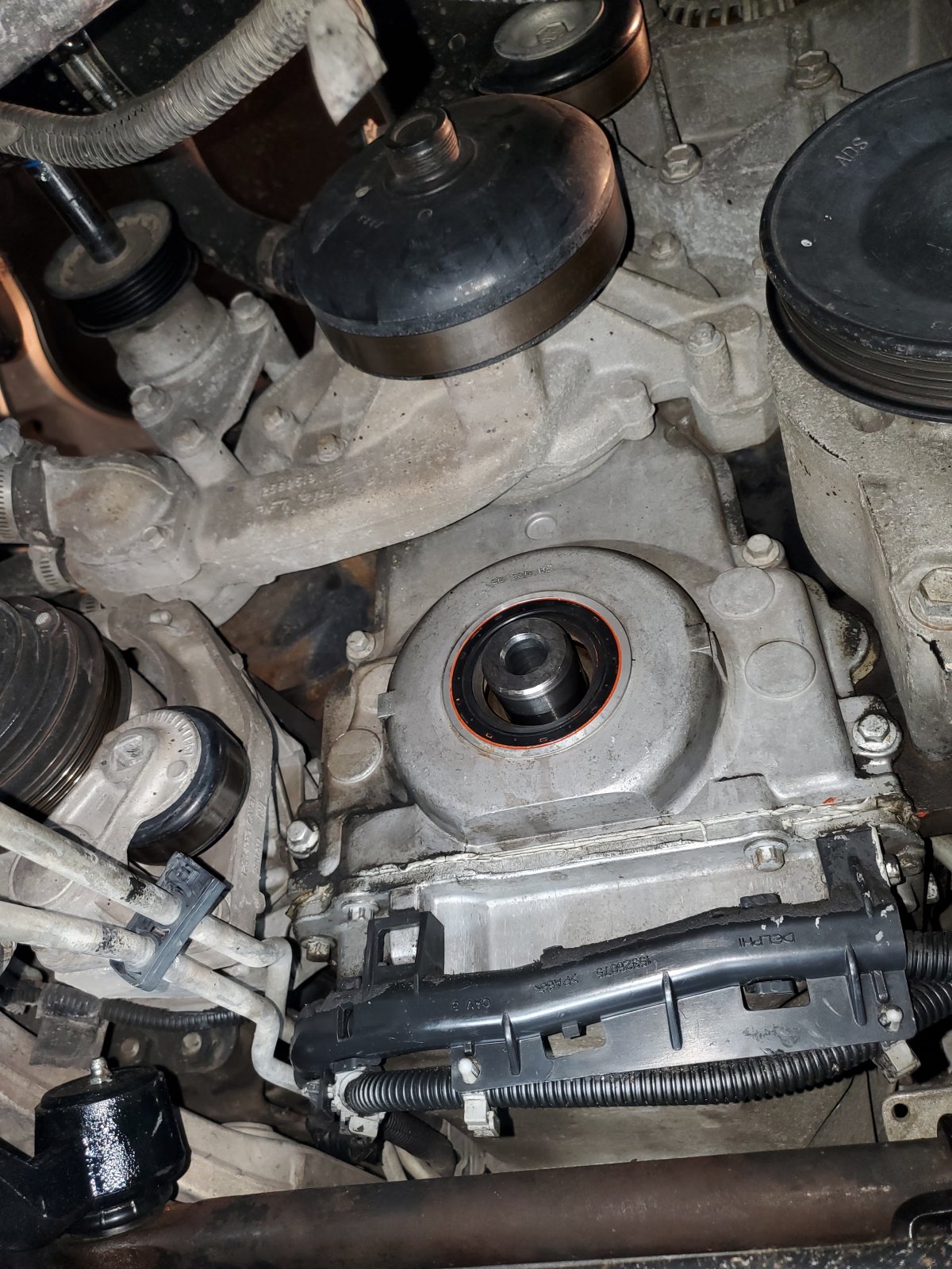

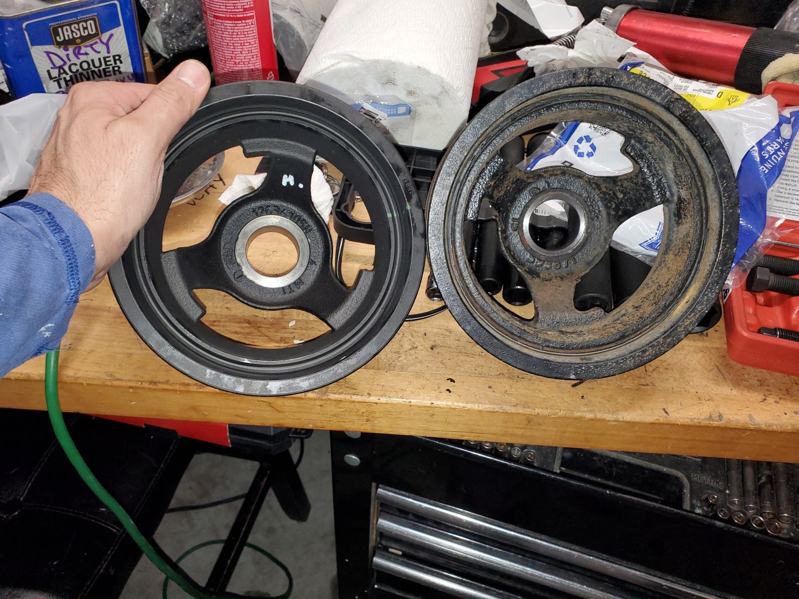

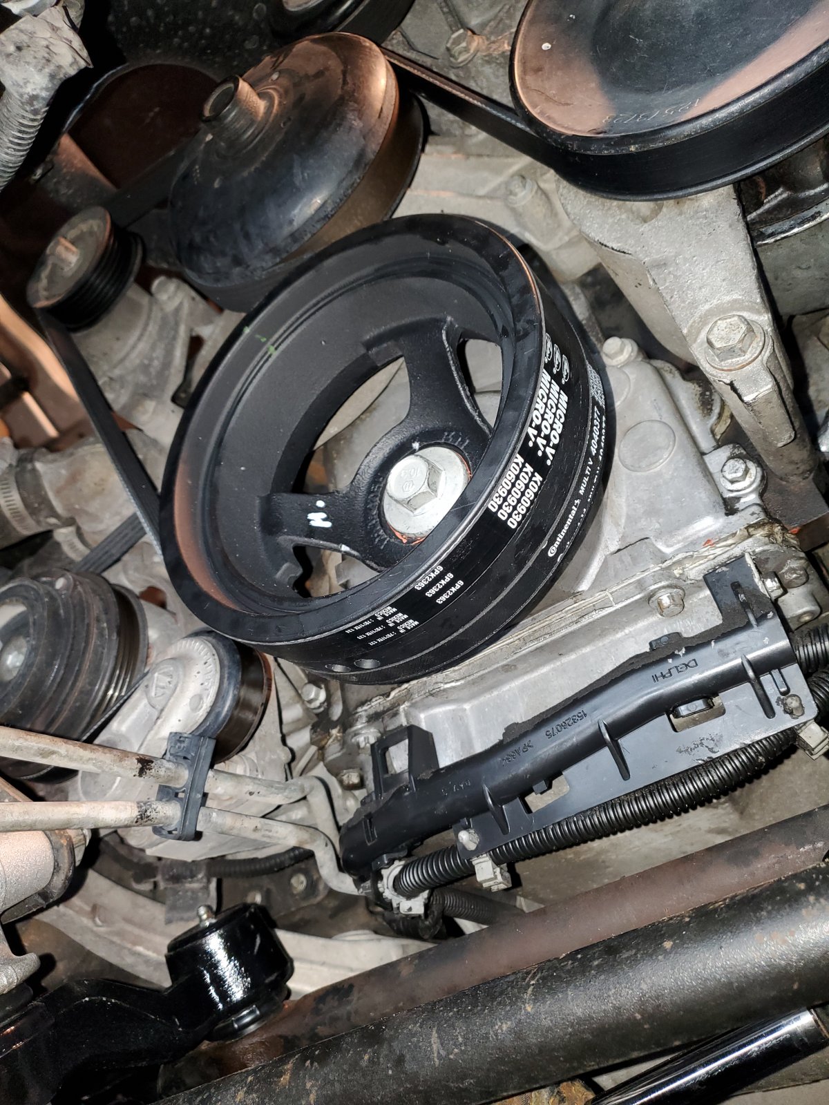

The crankshaft seal was starting to show its age and developed a wet spot. Got it knocked out this weekend. I also installed a new harmonic balancer and new belts since I was already there.
At least it was the front seal and not the rear seal! It’s much easier to pull the balancer rather than the transmission. :)
Don't forget to perofrm a crankshaft variation re-learn in PCM. It is required every time you remove the balancer (unless you marked it and installedd in the same position).
52,949
I know the SM states to do that but I didn’t, I forgot about it. Do you know what issues this could cause? Either way, I guess I’ll do it but it’s been a couple years and I haven’t noticed any issues.
ivin74
05 NBS Nali
Aug 3, 2014
2,420
2,557
Htown, Texas
I was under the impression that it had to be done when the crankshaft sensor was replaced. First time I hear it needs to done when the harmonic balancer is replaced. I do have the Tech 2 to get it done
52,949
I used to think so too, then one time I heard it needs to be done when the balancer is R&R’d and I promptly forgot about doing it. It had already been a year or more since I did the original work. It does state to do it in the manual, which I use alldatadiy for. I have also heard the PCM will do it automatically after a certain amount of mileage but haven’t been able to confirm.
