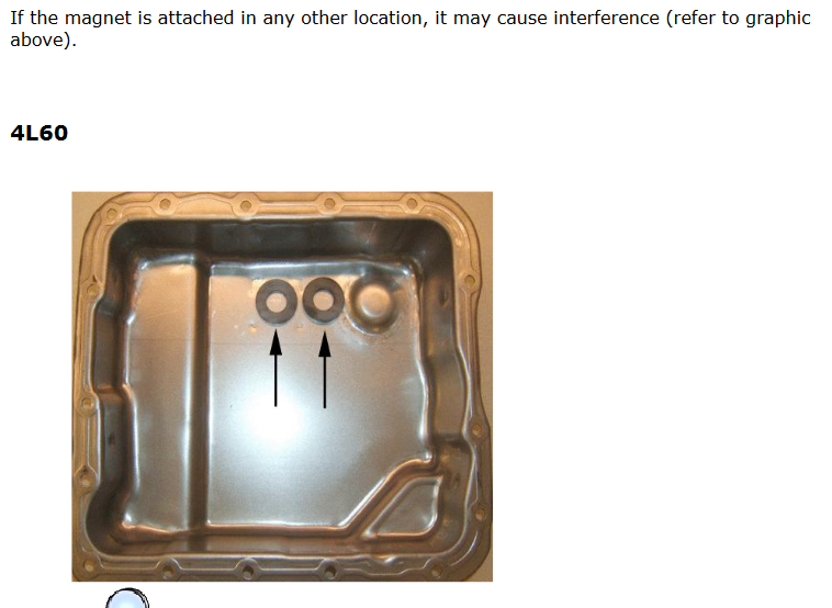

I've done both of those things

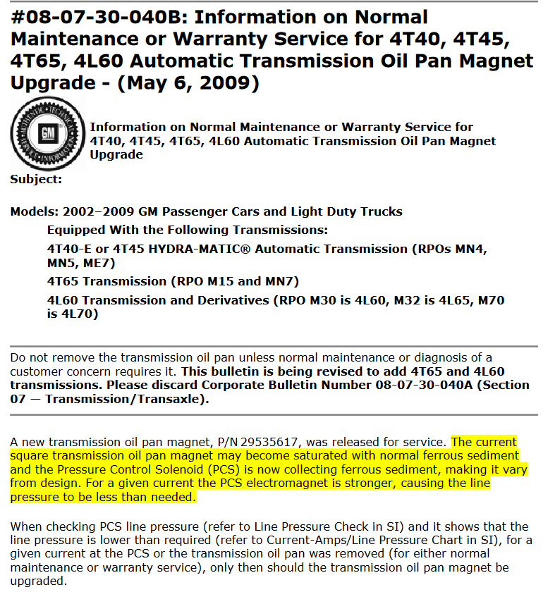

As well as an external filter, and second pan magnet as per TSB
Oh and a manual override for efans so I can get some flow through the thing even if coolant temps don't demand fan-on
I have yet to get around to an external fan filter. I wasnt aware of the TSB for another pan magnet. Thanks.
I have a magnefine inline w/ my trans cooler
TSB:

Nice simple solutions. Need to drop the pan sometime soon for a filter so I'll have to do these. Thanks for the info! I always planned to do a screw on filter. I have had these laying around for an embarrassingly long time: https://www.amazon.com/gp/product/B0014BHVRO/ref=ppx_yo_dt_b_search_asin_title?ie=UTF8&psc=1

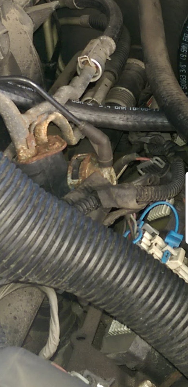

Pull the vacuum hose off the regulator and check if fuel is leaking off it.
Strange, my FPR is integrated into my fuel pump and is nothing like what's shown in the video. In older GMT800's, the FPR was located on the fuel rail close to the firewall and was easy to access and replace. I had to replace my fuel pump around 120k miles because the FPR was failing, and since it was built into the fuel pump assembly I didn't have a choice but to replace the whole thing.
52,949
52,949
Your FPR should be in the pump assembly. The one on the fuel rail was moved there in 03. You won’t be able to access it.
