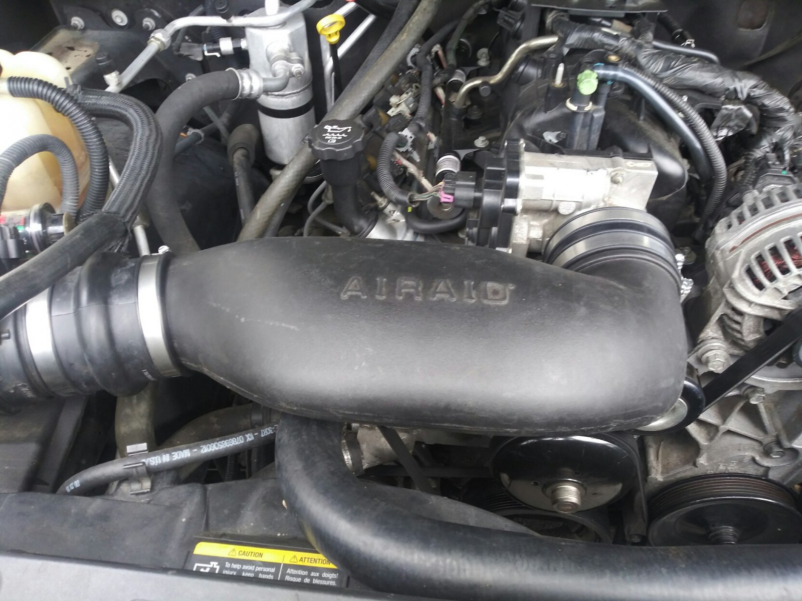

Saturday afternoon, I pulled the air filter, intake tube, plugs and wires. Based on the P/N, I think they're the originals. Not bad for 167k.
Then I used a tiny funnel and tube with a pipette to squirt 1oz. of Kreen into each cylinder. Installed the new plugs - Delco 41-110, turned it over a couple times with the key (no wires), and let her sit overnight.
Today I cleaned the Airaid filter and MAF while they were out, installed the new wires, and put everything back together. Then I added 8oz of Kreen to the 1/4ish tank of 93 and another 8oz to the oil (For those following along with your measuring cups, that makes 1 quart of Kreen total). Wires were VMS 10.2mm (I think @Doubeleive pointed them out a while back? They've been in the parts pile for about...nevermind). They seem nice. I do wish they were about 1" shorter in a couple spots. I thought I took pictures of them installed, but...:crazy:
Then I ran the truck for about an hour. A little white smoke from the tail pipe, but nothing youtube worthy. I could smell the Kreen a little, though.
Next, I proceeded to burn the skin off my hand for the sake of science by immediately acquiring another sample for Blackstone. I pulled and cleaned the catch can, and let her drain for a good long while. Documented milage, reset the oil monitor, installed K&N HP-1007, and fed her the Rotella 5w-30.
Last but not least, I took the long (Blackbear sport mode) route to grab an XL pepperoni pie. All seems good and running smooth. No noticeable difference in oil pressure. I think the lifters quieted down a touch, though.

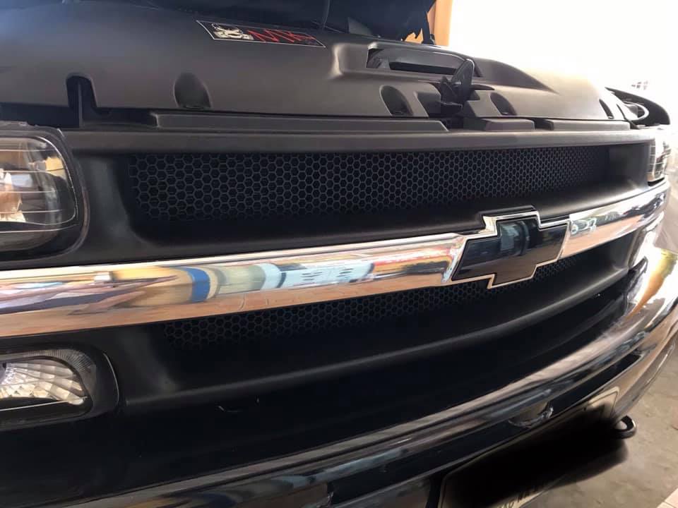

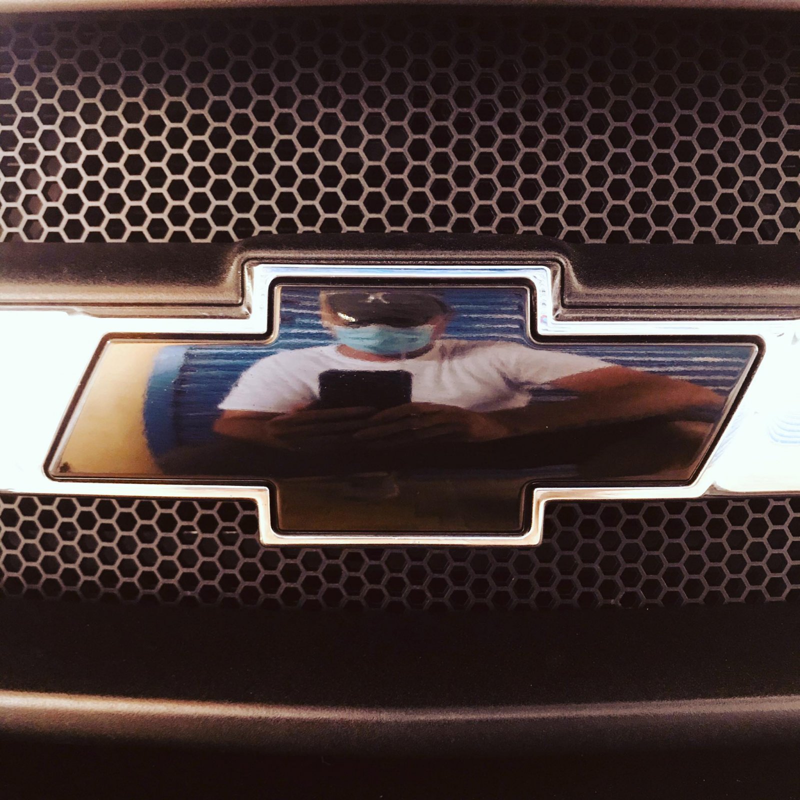

Modded the grille. Again.

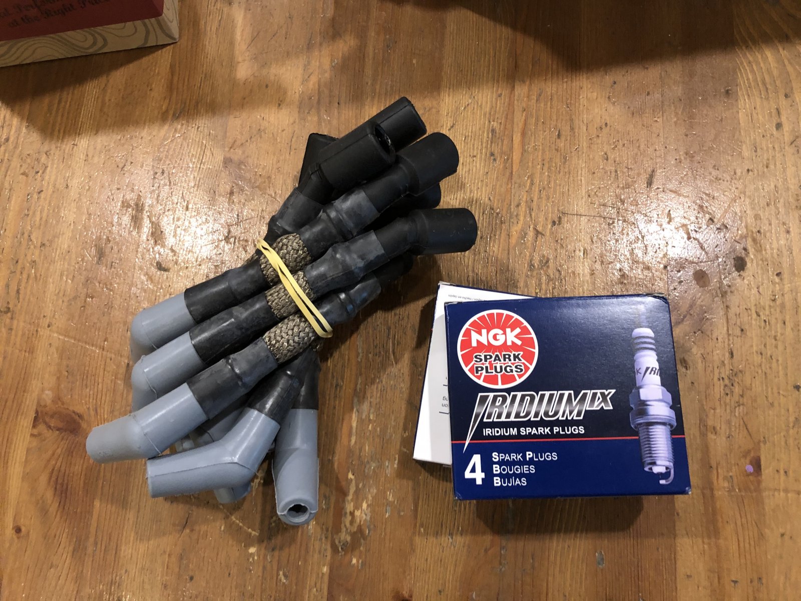

And I just got my new plugs and wires for The Beast. Hope this fixes the misfires.

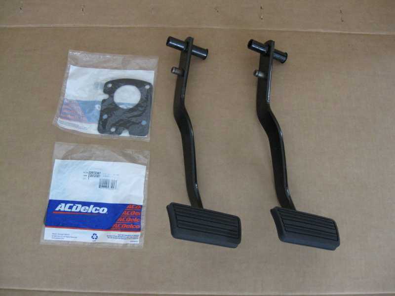

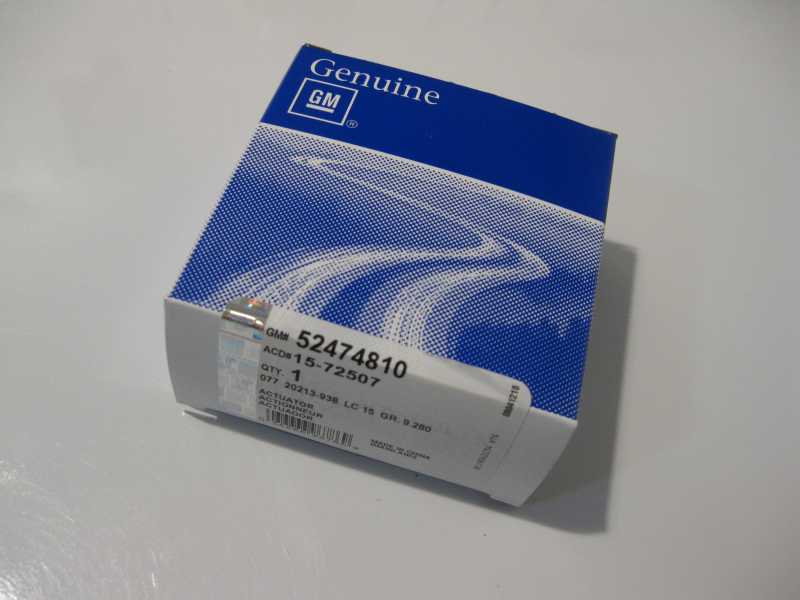

Replaced the blend door actuator, and it wasn’t as fun as I thought it would be. Rockauto to the rescue. I also started collecting parts from Amazon to do a hydroboost conversion on the Tahoe and Silverado.
Hydroboost is awesome! Until the damn thing starts leaking. I'm on my 2nd attempt to reseal. Still leaking...

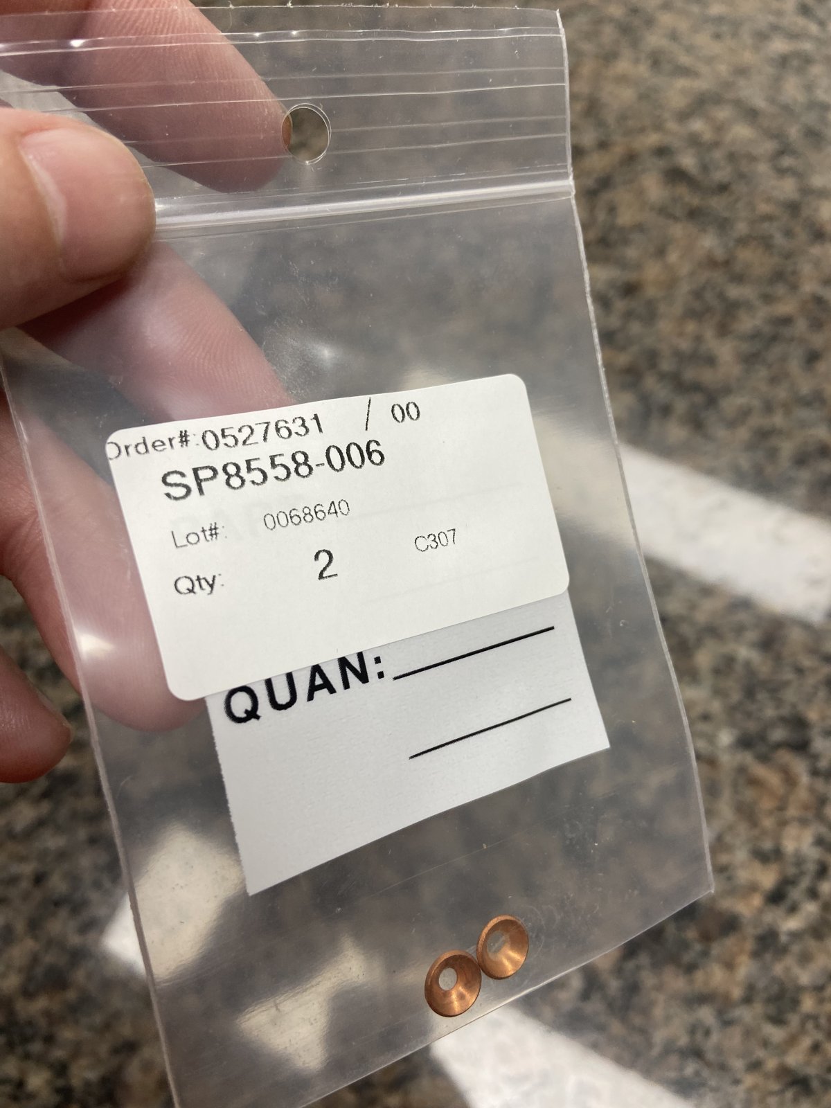

Finally received these two washers that are supposed to fix the center brake line isssue with the goodridge kit. Here’s the part # etc. I have no idea how they go in or where, no directions provided. Will have to wait till I get around to it now…
EDIT: they say I only need one, but shipped 2 anyway
