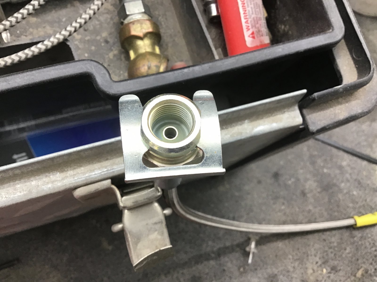

I heard the fitting is too deep so it won’t screw down tight. The washer must fit inside the fitting and it will be obvious which way it goes, just match the curve of the inside of the fitting. This is the fitting, you can see how that washer goes. How did you get them to send the washers?
Edit: I went back in the thread and see you contacted Goodridge so I just emailed them and asked for help getting these.

Exactly. The fitting bottoms out before it seals onto the line. This will bring the seal out enough to actually make contact with the line, and compression -fit seal it.

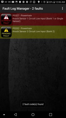

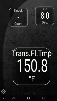

Now I'm pissed. Damn codes keep coming back. Wtf
8 degrees of knock regard at anything above half throttle. Feels slowwww

I had that same code p0332 come up after a full knock sensor job. We used Delphi knock sensors and a new harness from RA. Pissed me off. I cleared code and hasn't came back on like 300 miles ago

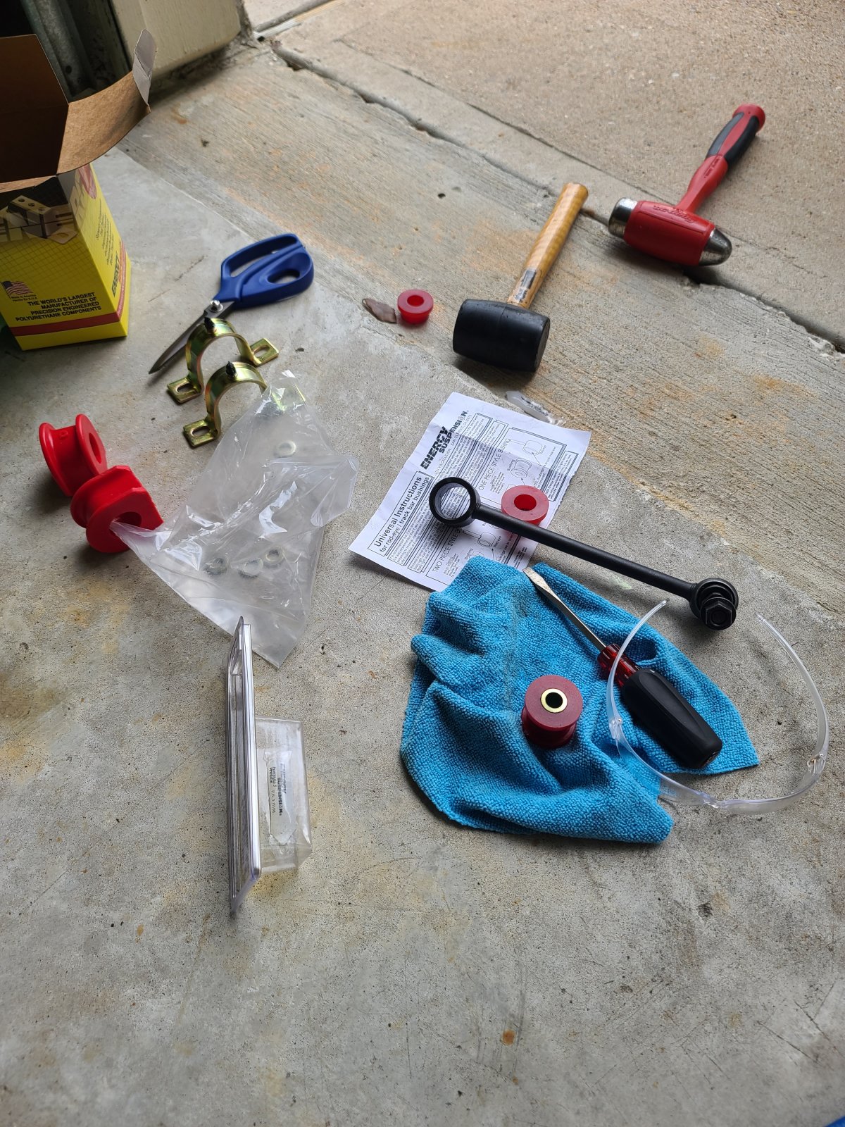

So yeah the Energy Suspension rear sway bar bushings are a Mofo to press!!!! Probably going to take them to a shop to have them pressed so I csn install at home
It kinda looks like you pressed the sleeve into the bushing there before pressing the bushing into the end link..? I’d definitely do it in the opposite order. Not sure if that’s what you’re doing..?

The metal sleeve slips right on. I just joined them to keep track of them. I tried pressing it into the sway bar without the sleeve several times.
