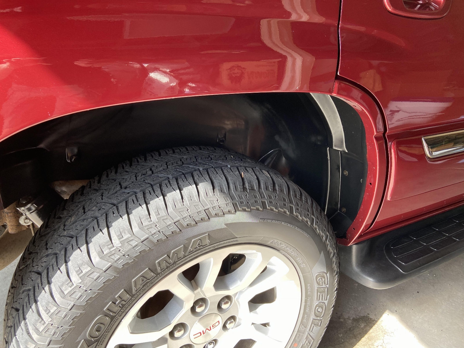

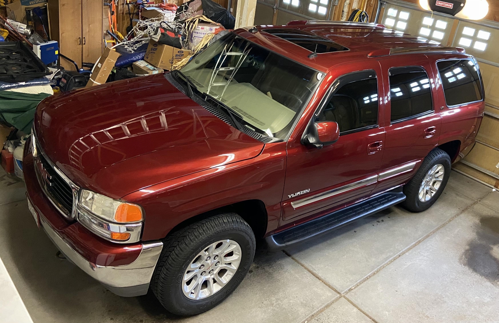

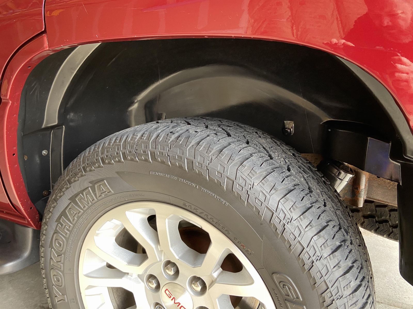

Work was slow today, so quick wash to get last weeks’ rain off, and I decided to try out this chemical guys product today, and I’m very pleased with the results.
Chemical Guys TVD_104_16 Bare Bones Premium Dark Shine Spray for Undercarriage, Tires and Trim, 16 oz https://smile.amazon.com/dp/B001TJW...abc_KS4Z28FZXEX8C2E7QG1W?_encoding=UTF8&psc=1

I see it’s a spray, so what happens with the overspray? I always have had an issue with tire or trim shine that sprays on, I always end up spraying it on an applicator so it doesn’t get all over the paint. I’m eagerly awaiting your response so I can spend some cash if the answer is acceptable. :rolleyes:

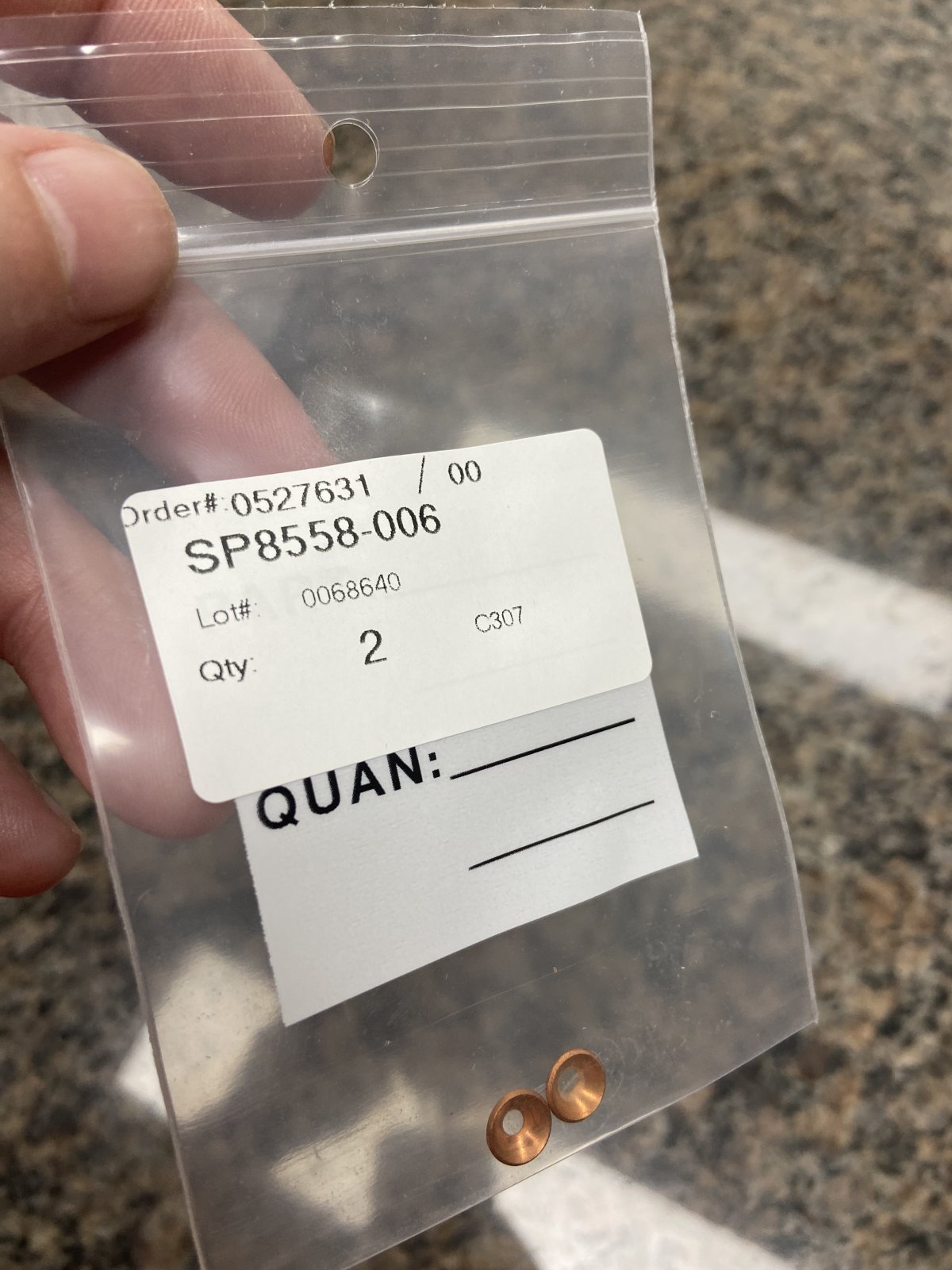

View attachment 278347 Finally received these two washers that are supposed to fix the center brake line isssue with the goodridge kit. Here’s the part # etc. I have no idea how they go in or where, no directions provided. Will have to wait till I get around to it now…
EDIT: they say I only need one, but shipped 2 anyway

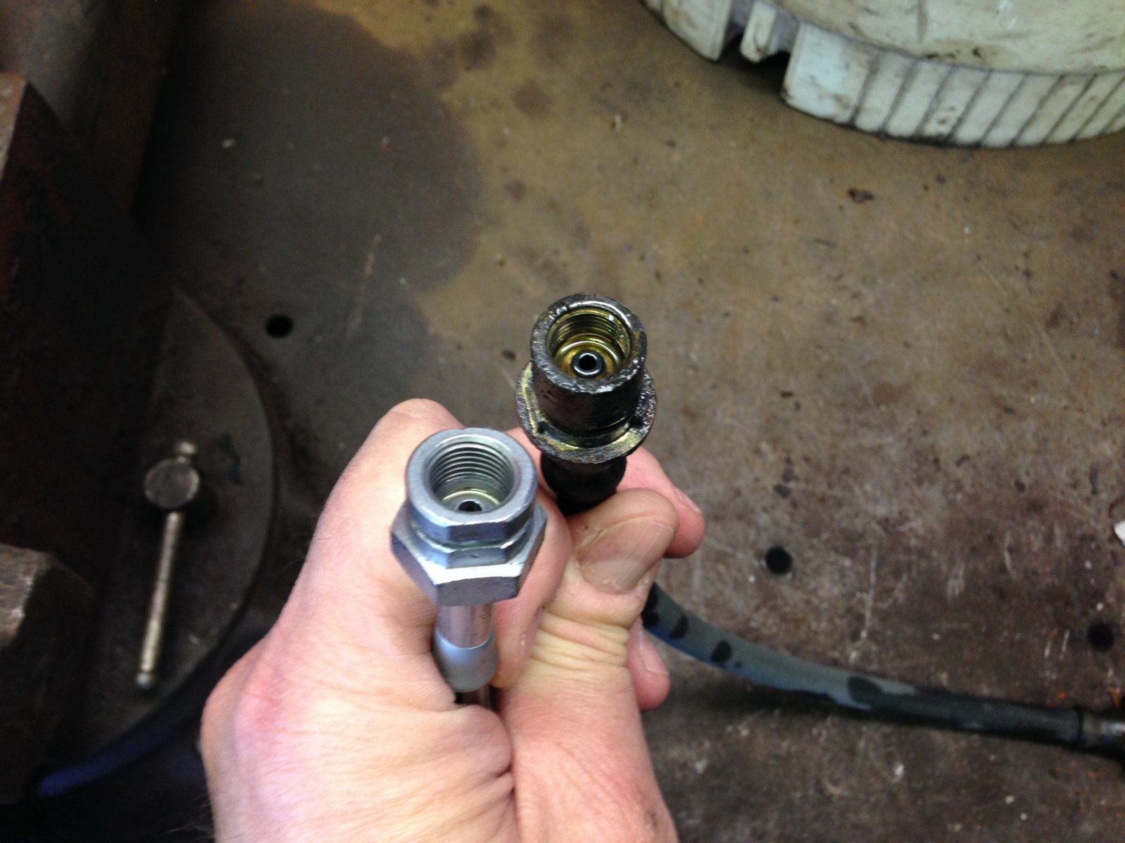

I just noticed this about the goodridge lines i went threw the same shit with the one fitting.I ended up cutting it off and putting a different fitting on because it wouldn't tighten up total B.S from them.

Lol..! Well, since I only used it in the wheel wells, there was very minimal overspray on the paint. I just touched it up after spraying, with some Meguiars quick detailer and a clean microfiber.
ETA: However, it should be applied in the street, certainly not the garage. Rookie move on my part..! I had to clean up the floor..!

Didn’t like a shiny floor?:)

It only happens on some of the trucks, and once they were made aware they offered a solution which is now included with the kit.
I guess i was the guinea pig i did it in 2017 and i made them well aware of it right away.Installed all lines got to the last one with the spare down and the fitting doesnt fit,i was pissed.

Yep, that would have pissed me off too. You might be the reason I never tried installing mine, all I know is I heard some of them fit and some didn’t and I didn’t want to take the chance so I put it in a drawer in my toolbox until I got it figured out. That was a long time ago. Now they’re finally sending me the spacer so one day I’ll finish the job.

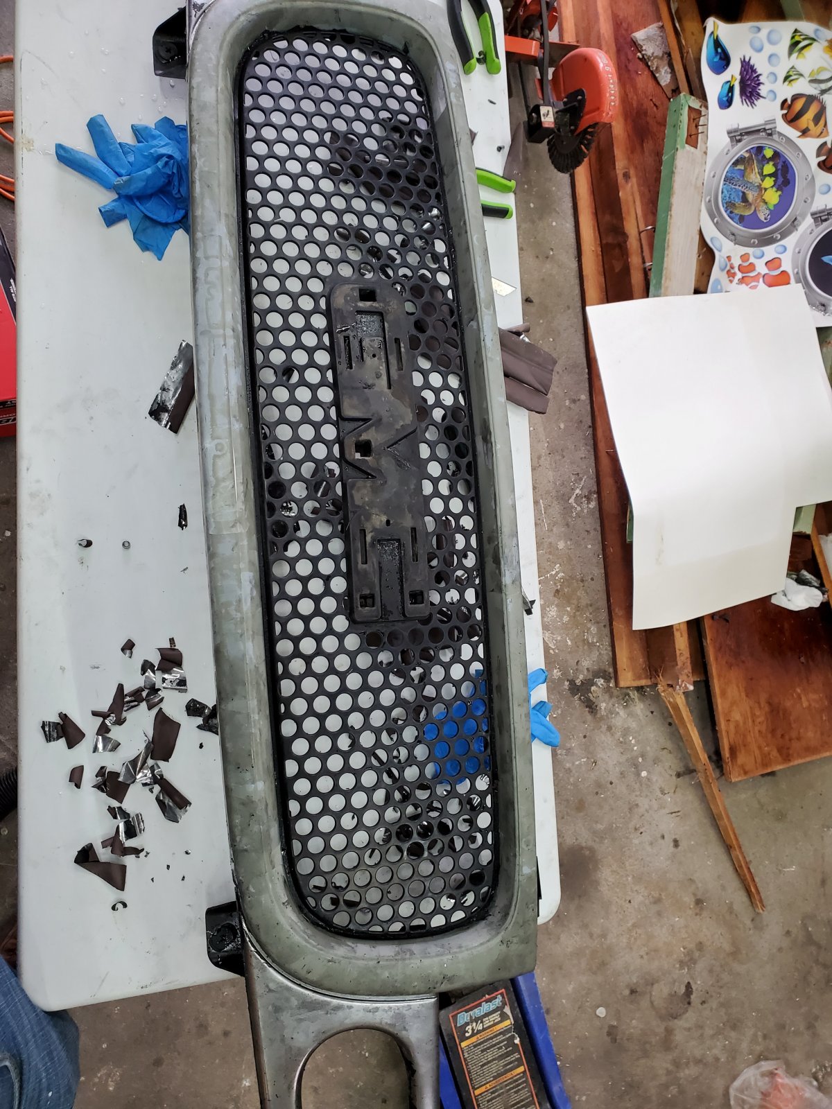

Got a spare denali grill since the paint on mine has taken a beating these last couple years.
Gonna try to peel the chrome off it so that the paint sticks better.
@Rocket Man is my memory wrong or were you the one that peeled the chrome off before painting?
If so is there an easier way than a razor and a butt ton of time lol

I tried and ended up ruining a grill so I bought an aftermarket one and my buddy who owns a body shop sanded the shit out of it, used an etching primer, and painted/ cleared it. I don’t think there’s any way other than tanking it in muriatic acid for a week. I didn’t want to invest in building a tank big enough for that thing and buying enough acid to cover it. I know I put a lot of time into trying everything else. I called places that strip chrome but they all said no way to strip it from plastic. Sorry for the bad news.:(

It's all good. I think I lucked out. I got the chrome off of the main section. Now I just have the wings left. I'm not even going to attempt the center lol. I'm just gonna do what I did last time and plastidip the center.
Ignore the mess in the background my garage is a work in progress...

not sure if this would work but easy off oven cleaning does amazing things, haven't tried it on any plastic chrome before but we used to use it to take paint off of aluminum/alloy, heard some people use it to counterfeit money as well by soaking lower denomination bills and then reprinting them in larger notes, it then passes the pen test and a quick glance it passes the strip test, lol not that I have ever done that :eek: just word of mouth.....:rolleyes:
