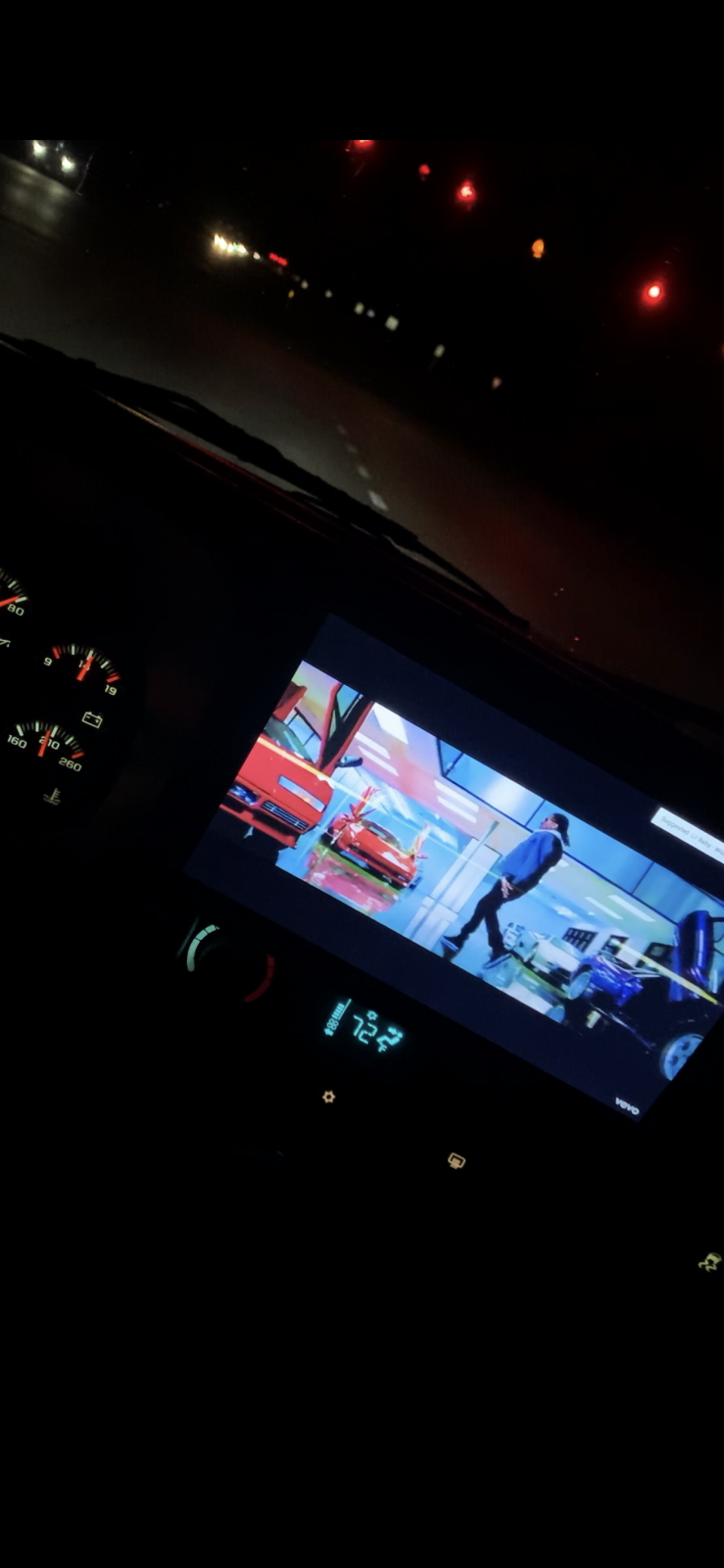

Make, model, install details. Daylight pics.
Bizine-10.1 inch screen 2GB Ram 16GB Rom. it isn’t like a normal double din at all. The only thing needed was the brackets from the factory and wiring harness’s. With the brackets you have to install them as you were pushing the unit away from the dash to clear the bezel with the screen. Basically modify them as you see fit for your installation. It is OBD2 capable so I ordered a mini Bluetooth OBD2 scanner to get live diagnostics through the unit. But for some reason it isn’t turning on in my Tahoe, I tried it in my wife’s X5 and it works so i don’t know what’s up with that. But I’m a big you get what you pay for believer to the max! After reading reviews and everything I decided to give it a shot since my Pioneer AVIC-X920BT isn’t doing it like I thought it would for me.

Cool. Check your cig lighter fuse. The OBD port is on that circuit.

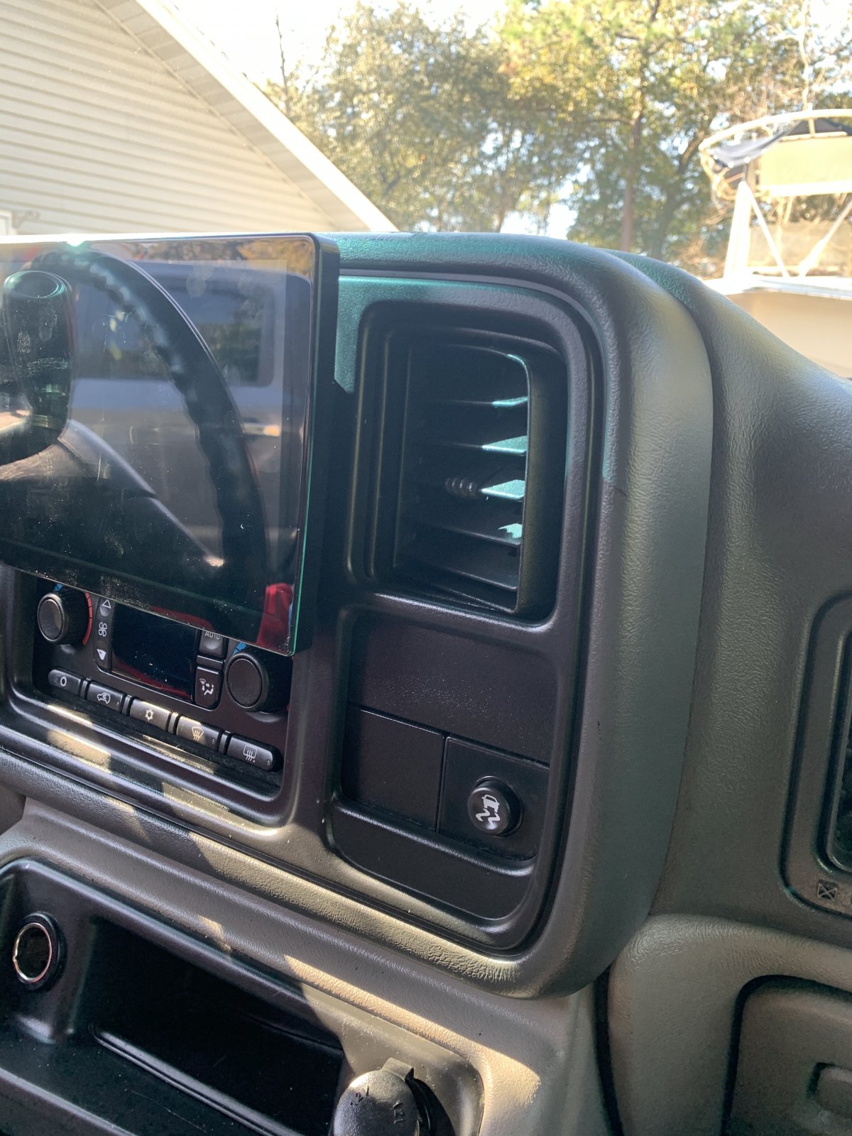

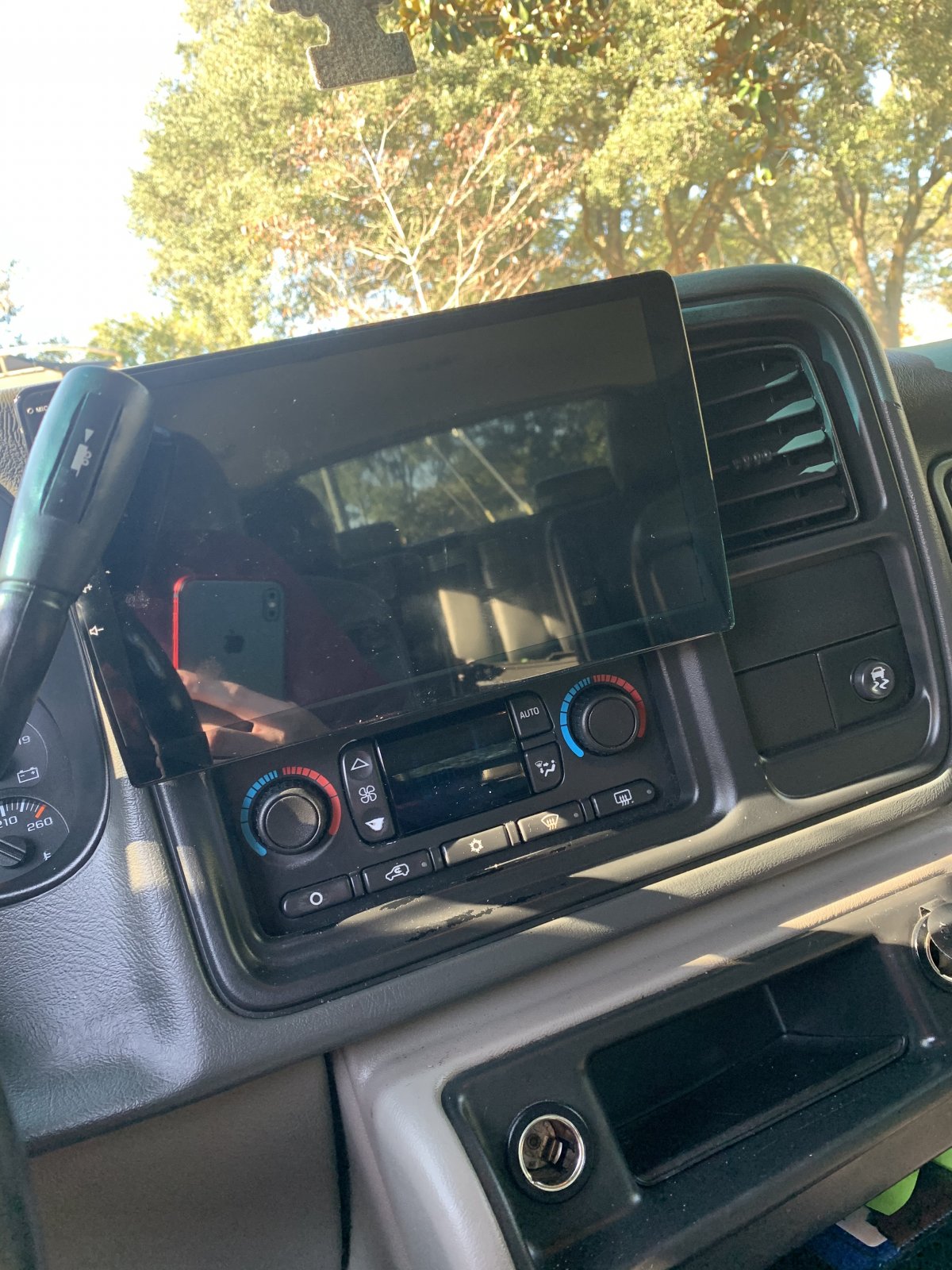

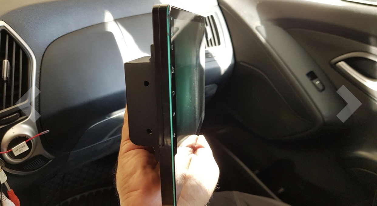

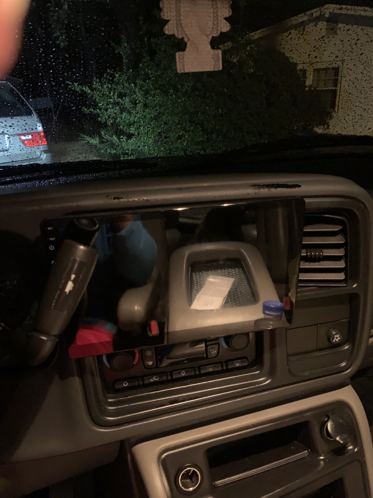

Have any install/progression pics? Just trying to get any idea of how it was done. I read your post, but I'm not getting it.
I’ll get you some pictures of what I mean here in a min when I hook up the gps antenna. I’m usually big on paying for quality but all the reviews I’ve read had nothing bad to say at all so figured for 130 I’d give it a shot. It’s basically like having a computer/tablet. I also included a picture of the whole unit
Pics as requested
33,203
51,461
View attachment 236576 View attachment 236577 View attachment 236578
Pics as requested
